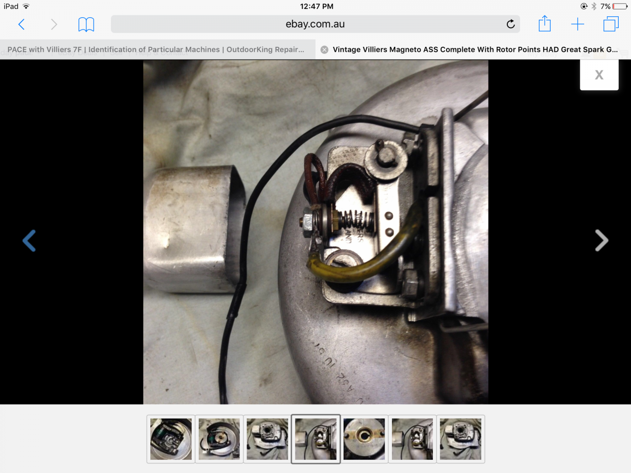

I have found out how Kye can have an exact date of his 7F engine manufacture. The year and month is stamped on top of the magneto rotor. Easy to get at by removing the starter and shroud revealing the fan. The fan is held on by the centre nut which will come off easily, there may still be a paper packing piece on top of the rotor. Under this stamped into the top of the rotor will be the date
The pics below are from an EBay auction
I just spotted this as well, you may not have to strip the shroud etc off if you can find it near the points cover
Let us know what you find Kye :-)

thanks for that Paul! using the second method the only number i can see is either a 50 or a 60, i will check under the cover before the holidays end though!

Yours should be either 57 or 58, they are stamped quite lightly so you would have to make sure the area near the points is clean and a torch may assist you.
