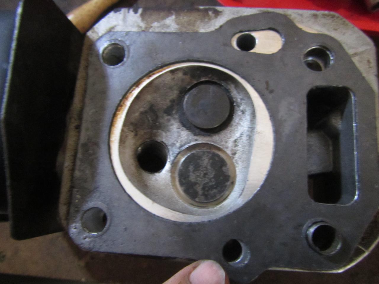

The valves were really chocked up with carbon so I completely dismantled the head and lapped the valves � all appeared to be in a good condition.

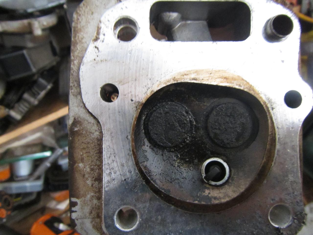

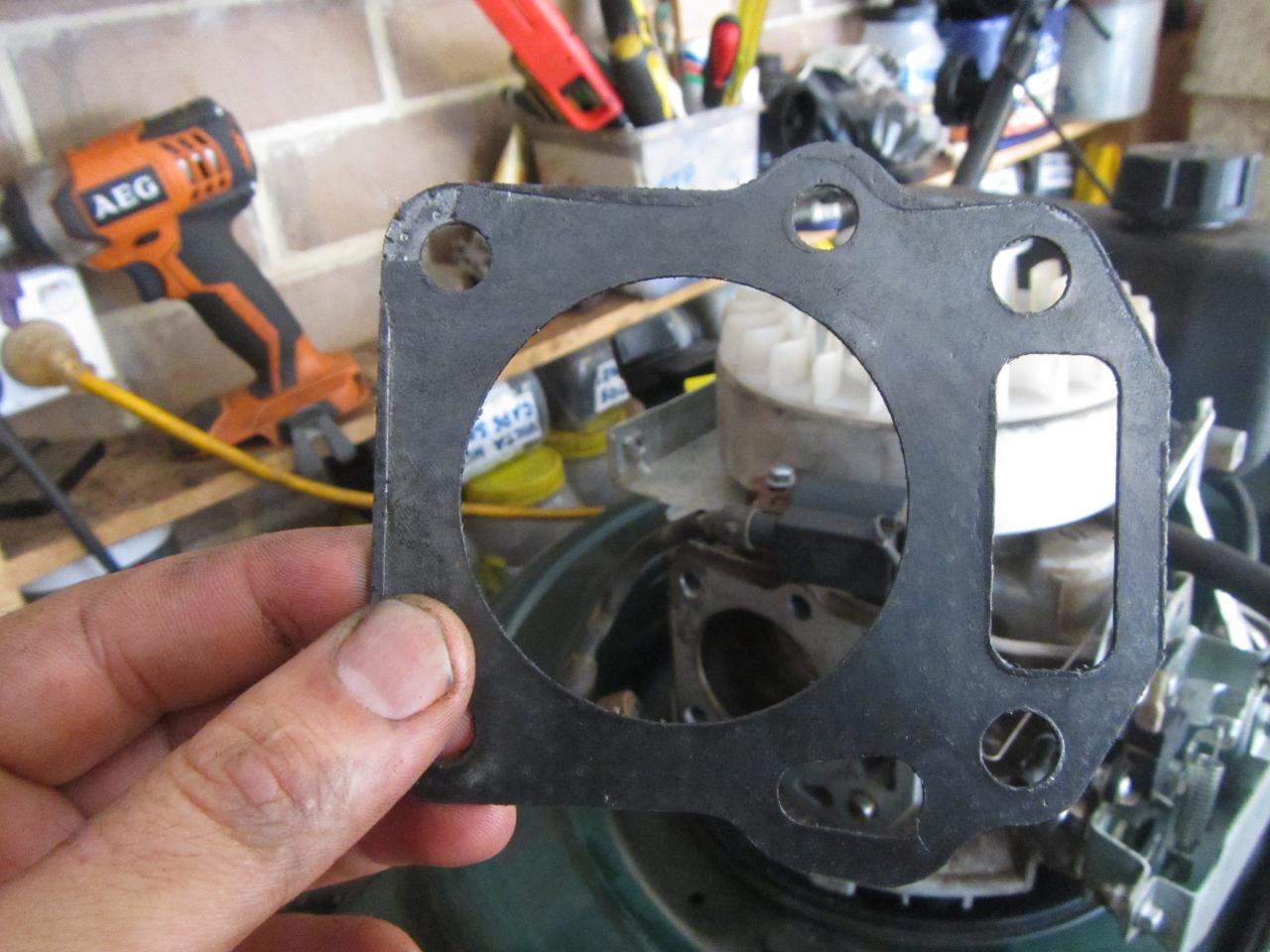

This is the strange thing � see my photo of the head gasket and the fact it doesn�t line up on the head via one of the oil cooling galleries. I�d like to know if this could be the problem because I am a little stumped at the moment.
The gasket only has very minor damage on one of the corners however I am thinking it might be best to get a replacement unless you guys think otherwise.

Hi Pete, i dont like the way the head gasket lines up but i don't think that would be causing your problem. How long did you run the machine for? Could the muffler be excessively wet with oil. I once had a briggs that took about 15 mins to carbonise all the oil from the muffler. Reassemble and start it without the muffle fitted to see if it still smokes up as before.

Thanks Theo, I didn't like the way the gasket lined up either. I have never actually seen one not line up before on an Over Head valve engine. I also noticed the bolts were not torqued correctly when taking off the head. I re-torqued them up correctly according to the GXV120 Head Bolt Torque Specifications.
