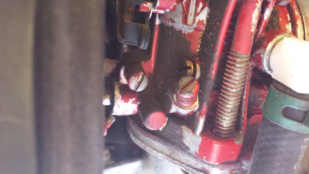

Hi, can any one help with how to tune the carby on a 10.5 briggs. Its a 92 year motor.
It doesn't have the mixture screw in the bottom of the carby bowl. It's got a screw horizontally coming out of the carb with anothet brass screw vertically next to it.

Sorry picture needs to flip to the right, fuel line coming in from the left.
