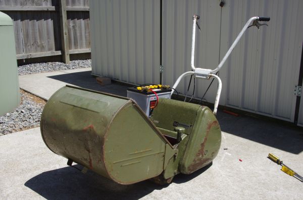

This is my first post to this forum and I would like to tell you about two Morrison Olympic 12V battery electric reel mowers I have.
[Linked Image from trademe.tmcdn.co.nz]
The green one appears somewhat newer than the gray one which has/had chrom plated handles and grease nipples on the cylinder bearings, the logos etc are of slightly different styles too.
They both 'go' and one is in much better condition than the other which is quite battered and has been painted gray, so I have "the green one" and the "gray one"!
The green one was received in original unmodified condition with just a sprinkling of rust, few dents in the catcher and very blunt blades. The gray one is really much the same but much rustier, daubed paint, bashed up and rusted catcher.

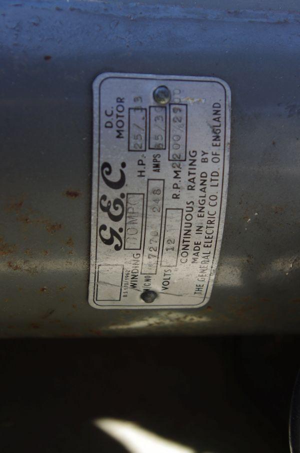

The machines are the same with a GE electric motor of about 200W, basic handle lever controls for the starting and stopping the motor and for engaging the roller drive. They are chain drive machines with what I presume are Ransomes cutter assemblies.
I started on the green one and dismantled the drive and removed the cutter assembly. All cutting surfaces were rusted and it had obviously been used from attempted scrub bashing rather than cutting any lawn. Offering the machine to our lawn it promptly bogged down and stalled.
With somewhat wishful thinking I mounted the cutter assembly on my bench vice and fitted an electric drill to the end of the cylinder then using valve grinding paste and turning the cylinder backwards I set to in an attempt improve matters. Somewhat to my surprise I arrived at apparently good cutting surfaces on the sole plate and the cylinder bars with just a couple of spots where cyclinder bars are bent and did not make contact. I should mention that prior to using the paste I had gradually tightened the clearance adjuster and removed a couple of high spots which were apparently due to slight dents in the cutter bars.
With a battery on and the electrical connections all tightened the mower made a fair attempt at cutting our lawn! I will be buying a new battery tomorrow!

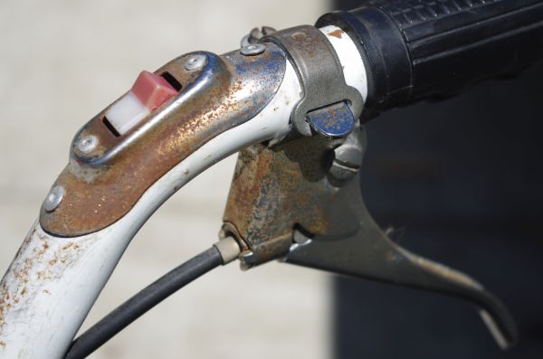

The right hand lever is a 'dead man' switch with a cable that pulls on an ancient Lucas contactor as used for the starter on some British vehicles of the early '50's. The lever must be held to keep the motor running.
Starting the motor starts the cylinder. The left hand lever has a latch and squeezing the handle and engaging the latch starts the roller.
There is a single simple toggle switch on the right hand handle that has a connection to the motor, operating the switch causes a slight change in motor speed. I imagine that on one setting there will be less torque and less current drain but I have not investigated that yet.

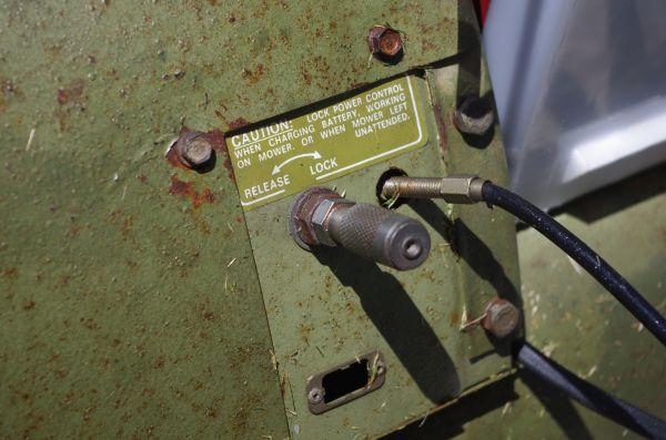

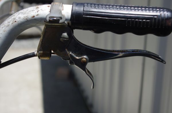

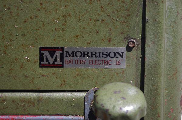

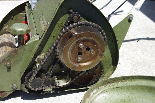

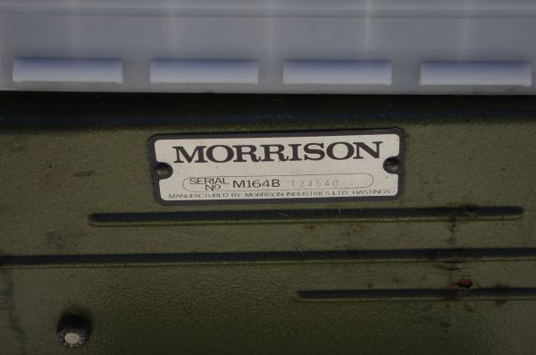

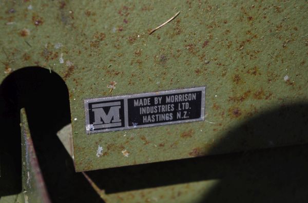

Photos of the green one getting ready for mowing our lawn for the first time!
...it mowed our small lawns with plenty of battery capacity in hand.

Hello John
These are great photos for the record.
I note that 400mm is roughly 16".
This is the original, quality design.
Morrison would cheapen the design, with a belt drive and
reduction gear in the landroll, later on. These all-chain
transmissions are very solid.
I see the reel has really responded to the backlapping.
Those double helix reels are nice to look. Masport have
abandoned the double helix on modern Olympic mowers.
Reason: the double helix is more expensive to manufacture.
Thanks for sharing your machines.
