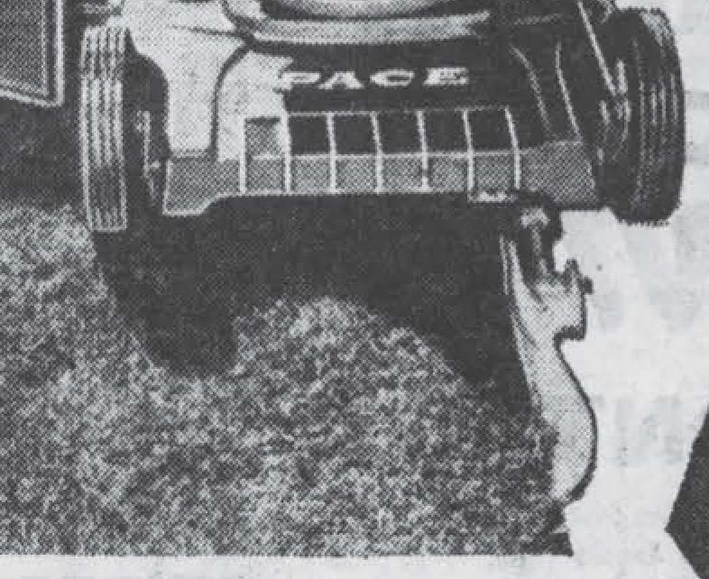

Hi Jack,the Pace Edger I have not seen on a mower or a detailed image of one but I would agree
with your summery that it was just a sharpened blade that has an adjustable height mechanism.
It looks like this type of edger would have little manufacturing imagination.
I have seen an American Edger Patent with a very similar operating principle to the Pace Edger.
Regards ,
Max.
Hi Max
Yes, only one small photo shows them at a Pace launch:-
[Linked Image from outdoorking.com]
SOURCE: Vintage Mowers website.
I have since found a few ads that suggest these were
offered from late 1962 for the 1963 season. This is consistent
with the models in the image. Price was about �3.
I guess they were no easier to use than the most common
manual edgers of the day ...
