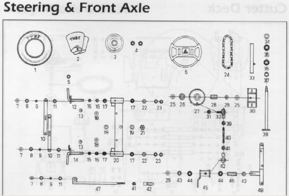

Only one thing that i knew i would have to fix is the steering. The main bolt through the front end is so loose that the steering is terrible. Turning left is not so bad but turning right it pushes the ftron wheels forward instead of turning to the right. Yes it is very worn out. Should be easy fix.
Has any one got pics or diagram of the front end. Not much to it just a big bolt in the middle and two either side that move up and down in a slot.
A diagram or pic would be nice. Might be a bush on the main bolt or worn out bolt or hole maybe.
Will find out shortly. A diagram would be a great help.

I have never worked on one of these or owned one, but with the aim of getting the ball rolling, here is a diagram of some greenfield steering. May or may not be your model.

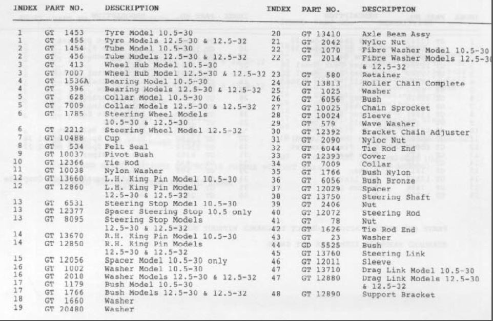

Here Is the evo 10.5
Paul
