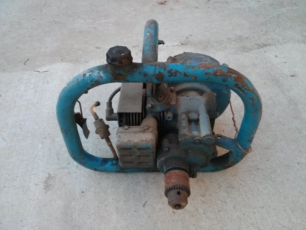

This engine was found at a recycle center minus carby.

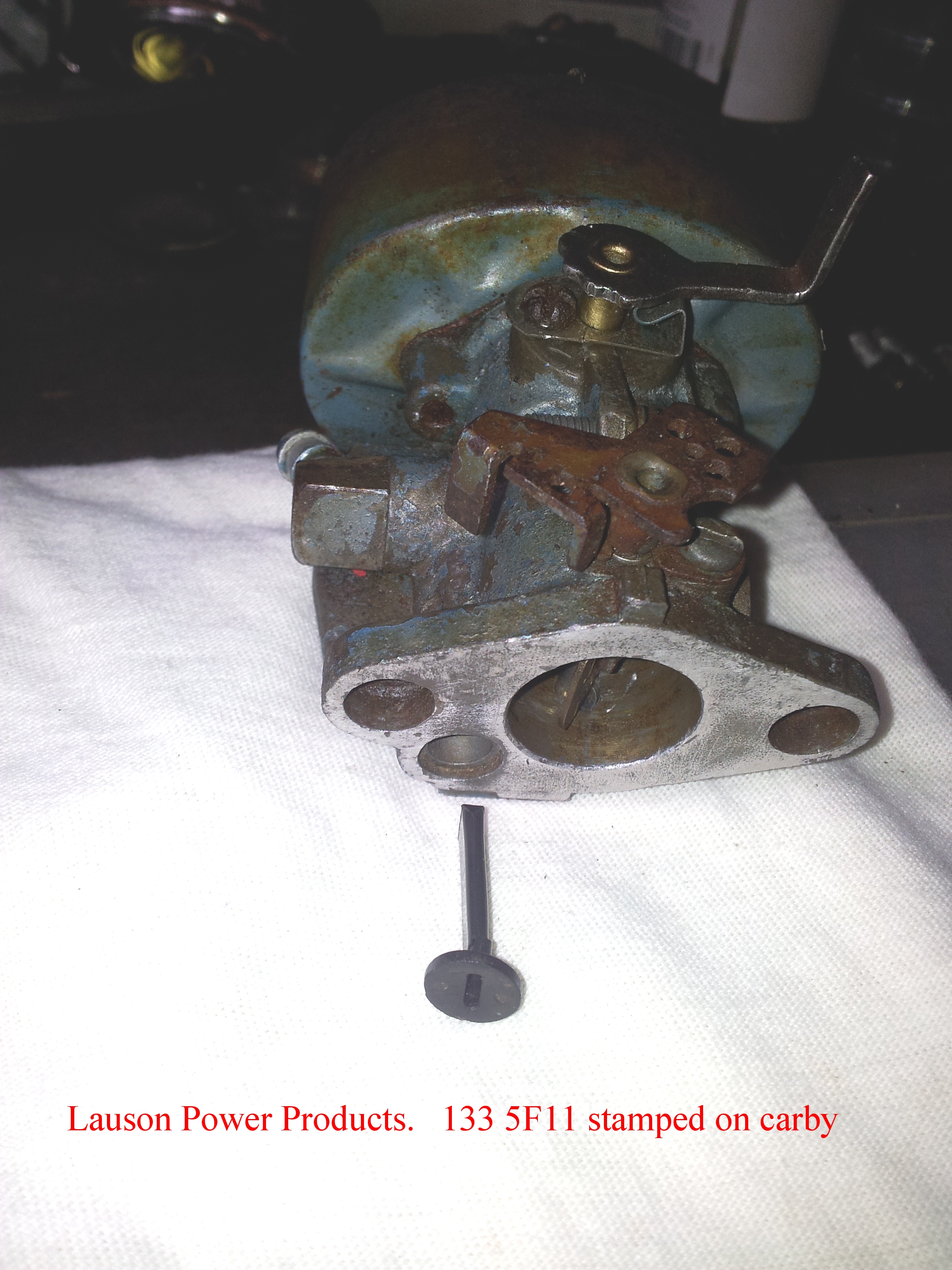

I have found another broken engine (crankshaft) with a carby attached. Sadly, the petrol pump balloon in the carby is split.
Carby and split balloon below.
[Linked Image from rustic-engines.com]
I would appreciate any information on OEM or after-market replacement parts in Oz. TIA.
Posts: 1,548
Likes: 25
AVB Offline
That would translate to be a Tecumseh 631135 carburetor if my manufacture number to part number is correct.
Posts: 14
All
Offline
Thanks AVB. Postage from the US to Oz ranges from $22.00AU to $40.00AU for the Pump Element and that is why I'm trying to source it in Oz. Appreciate the Tec part number but it still doesn't help here, darn it.
