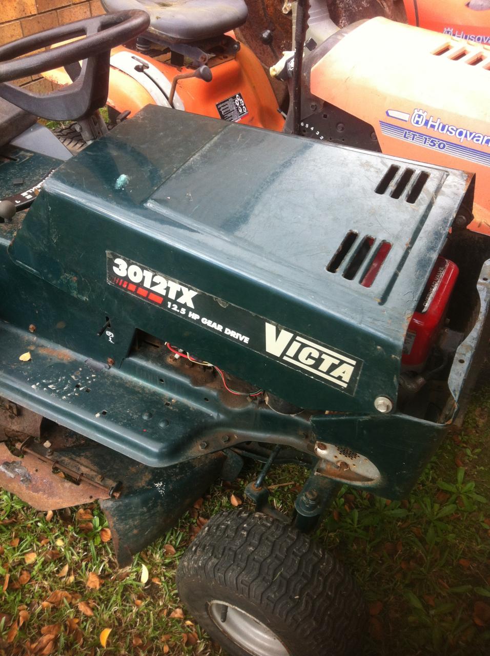

I am in the process of getting a Victa 3012TX (Mfg date 00215) model 31721x88B, which was built by Murray (their version being 31721x88A), back on it's feet. I am missing the complete headlight assembly and was wondering if anyone knew where I may be able to locate a good 2nd hand one, without the expense of buying one new from the USA.
Part numbers are: -
Grille, Upper : 91736 with Murray version 91736MA
Lens, Right : 91734 with Murray version 91734MA
Lens, Left : 91735 with Murray version 91735MA
Photo of machine is attached.
Thank you for your assistance and have a great day.

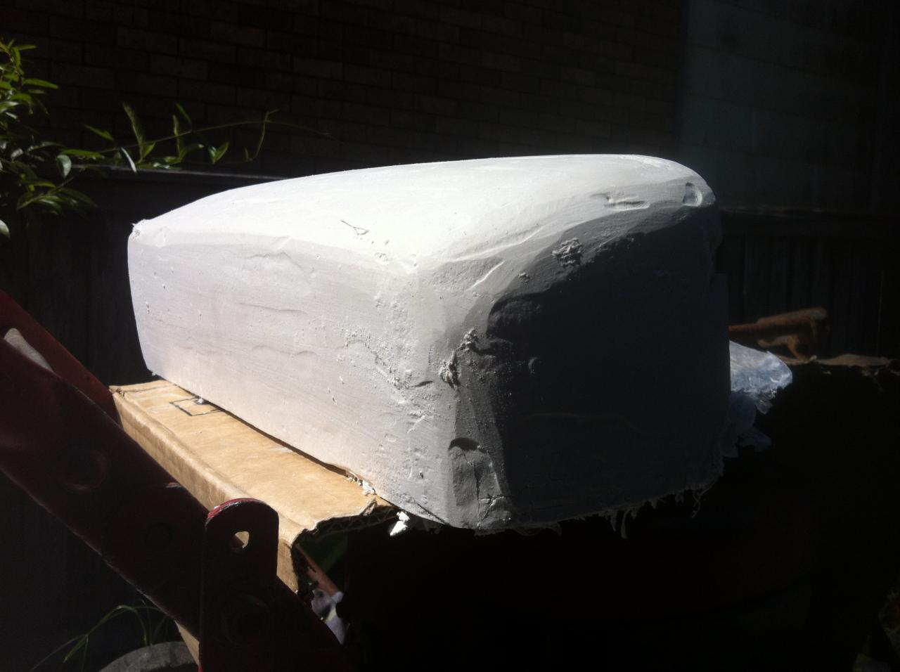

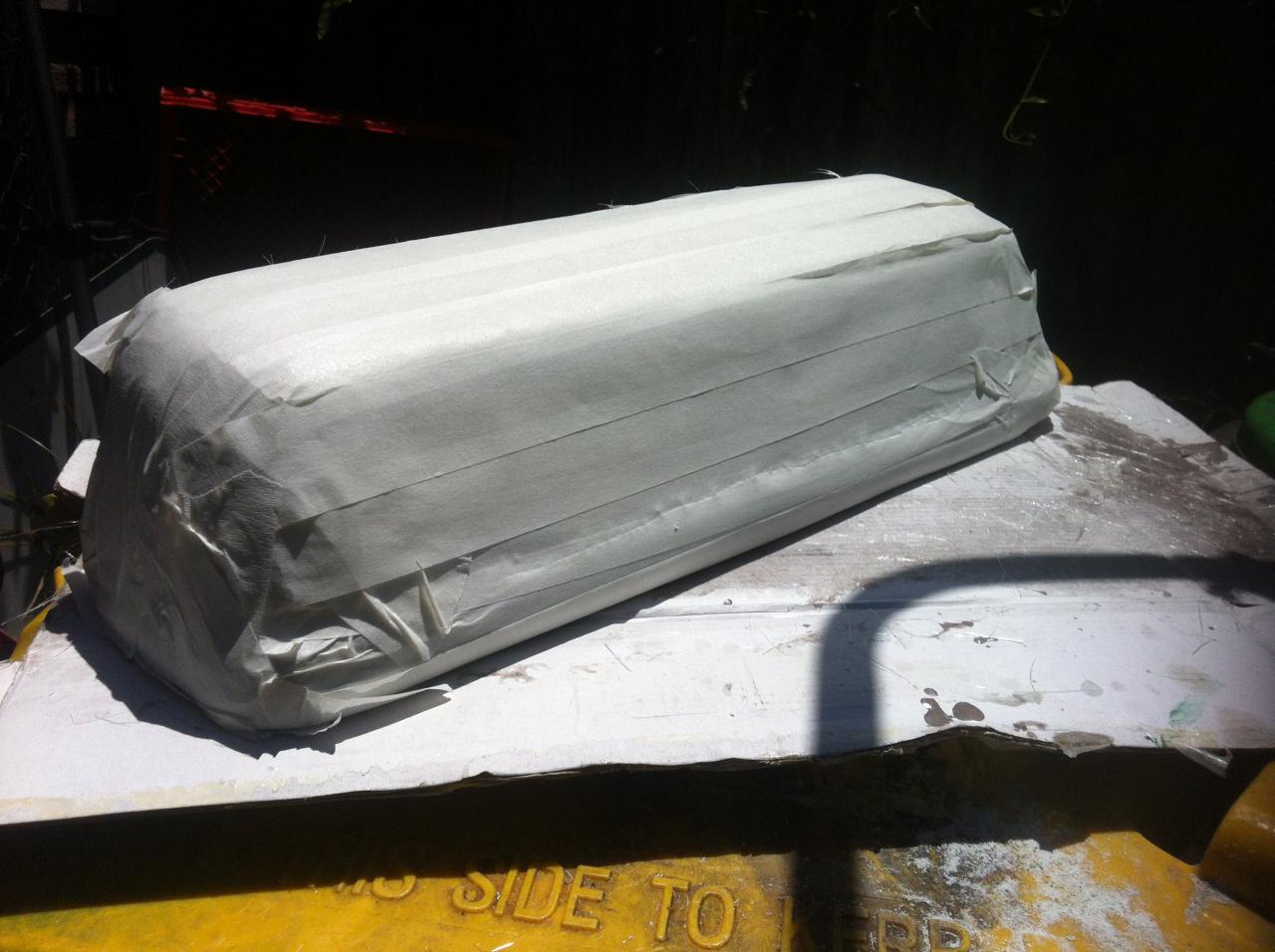

Well, it may not be perfect, but it does fill in the big hole in the front of the ride-on.
So, this Wanted ad can now be closed.

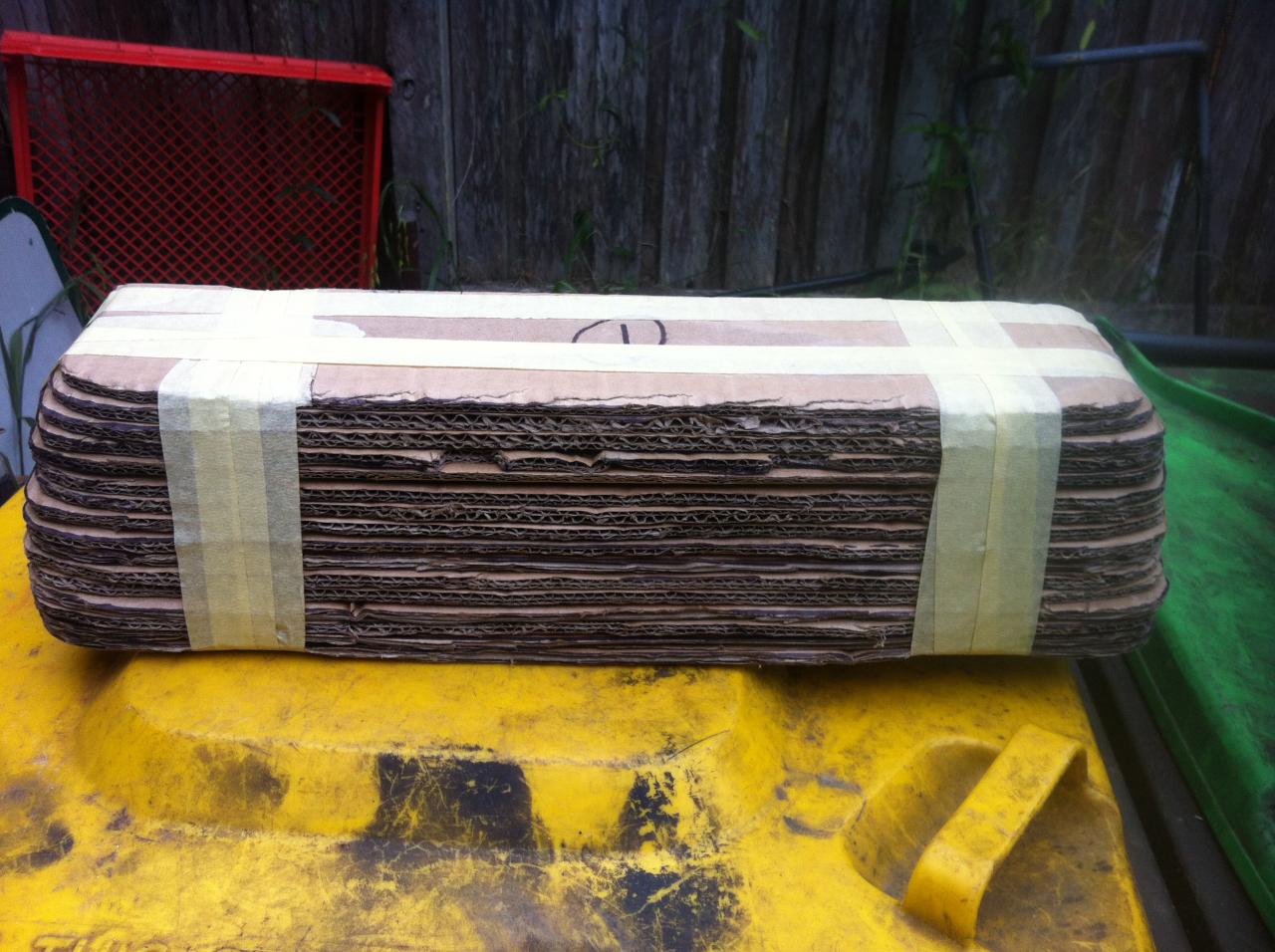

Lots of cutting up of a cardboard box to get general shape.
First version designed from photos of a genuine assembly.

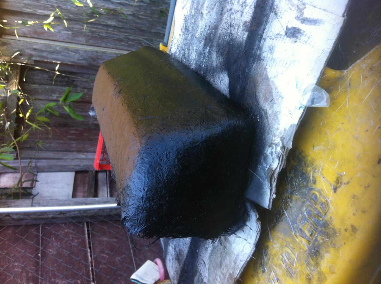

Covered in Plaster of Paris ready for fibreglass.

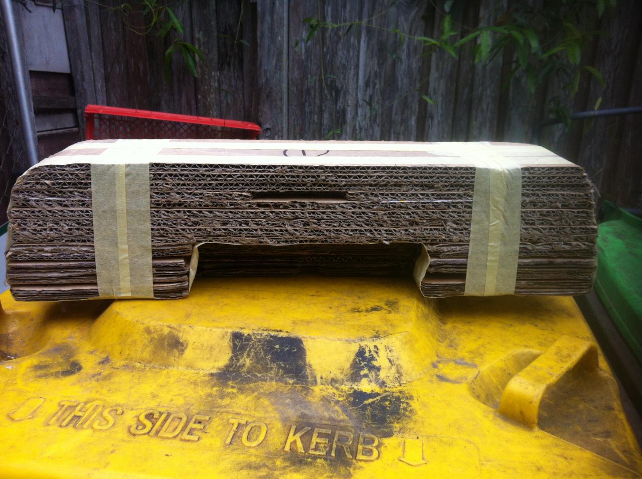

Too high and too wide to open bonnet, so that was a sad moment.
Cut down and taped together to get the shape and try again.

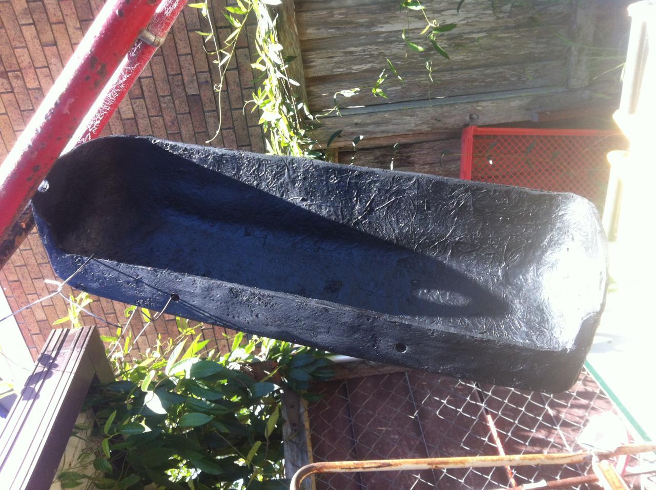

Headlight blank made from fibreglass ready to fit. Third time lucky.

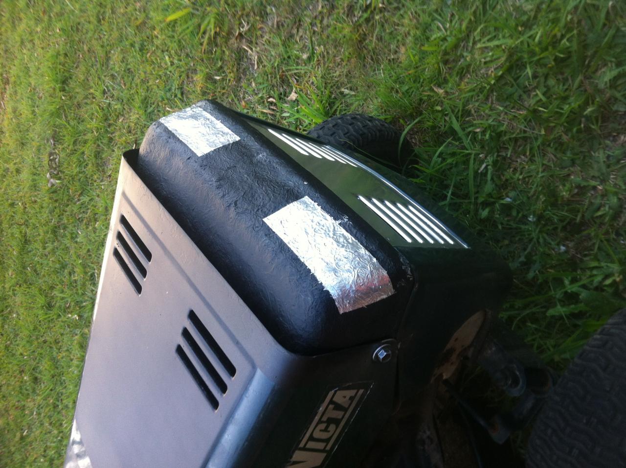

Well, it's not a perfect fit at the top. Has about 10-15mm gap to bonnet, but it works good enough. Painted headlights because who mows in the dark. :-)
