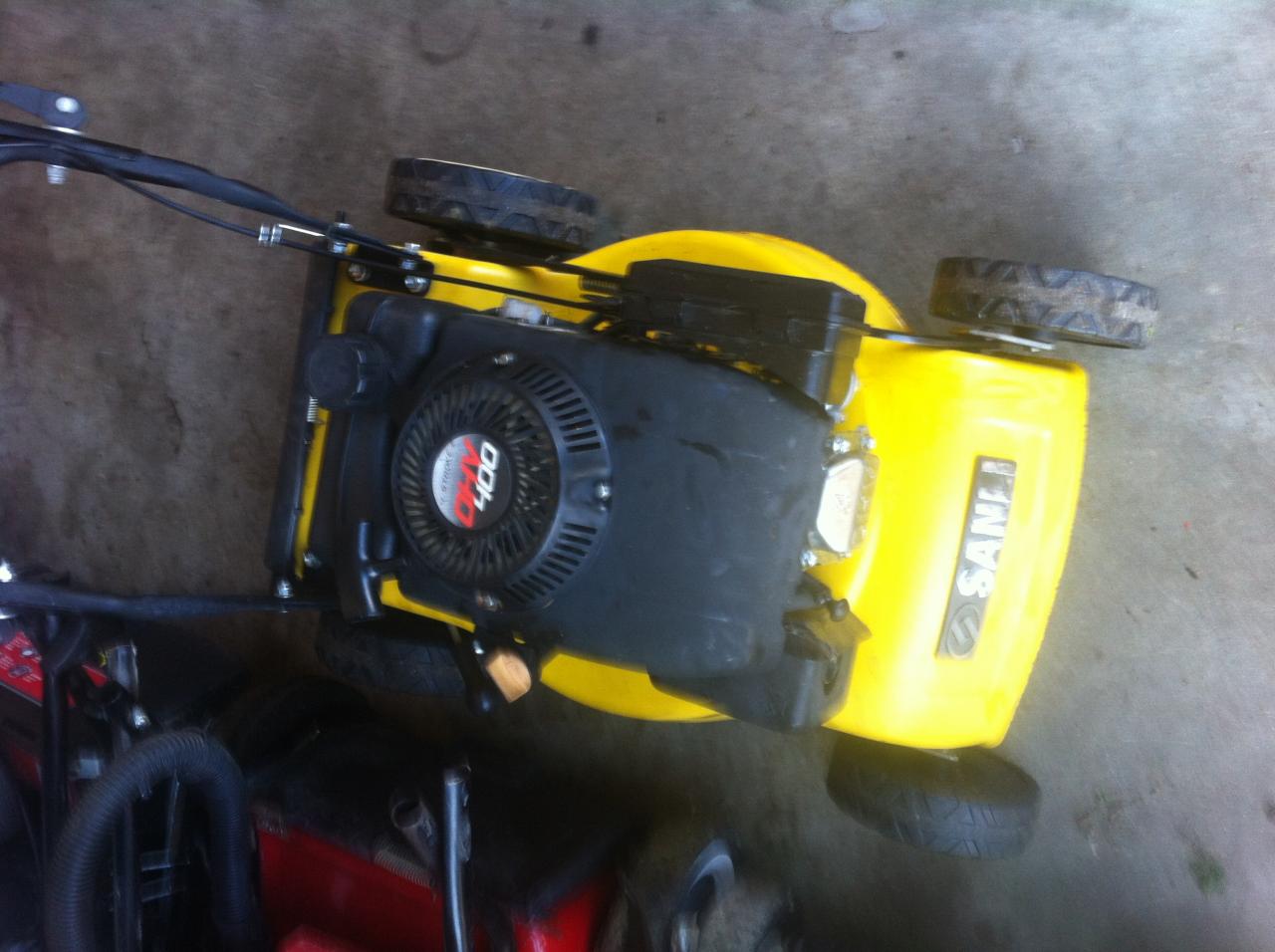

Hey Guys,
I recently took in this Sanli Lazercut as a trade. I have a rule with Chonda�s�. I�ll only touch them when they are in good condition � This one just fit my requirements.
Before servicing the item I tried to start it and it started after a few pulls however it was making a horrible whistling type sound. It sounded like a valve wasn�t sealing or even some sort of exhaust leak.

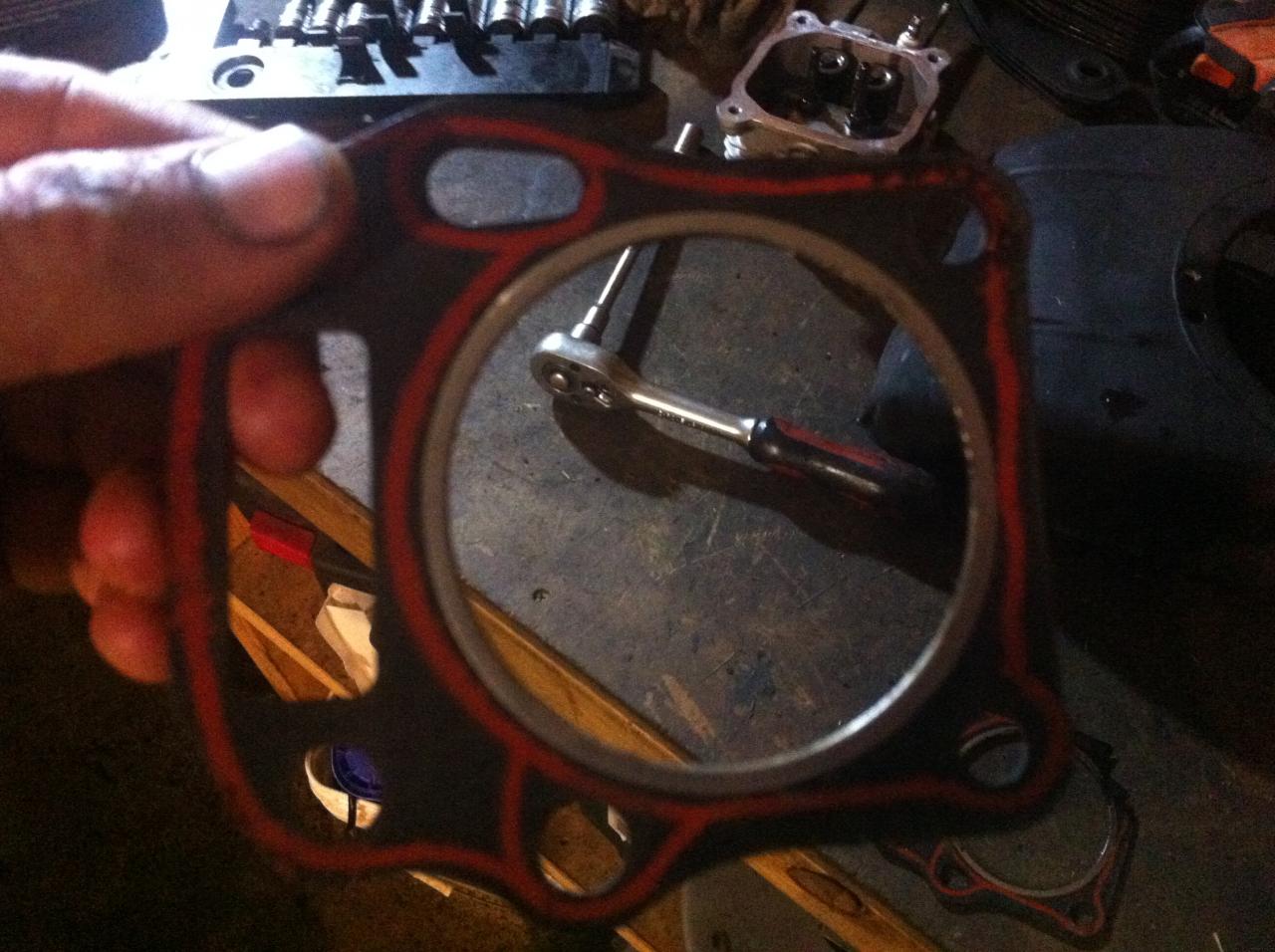

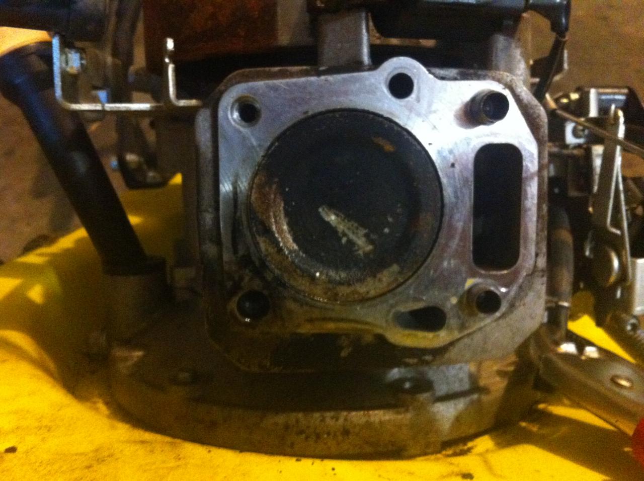

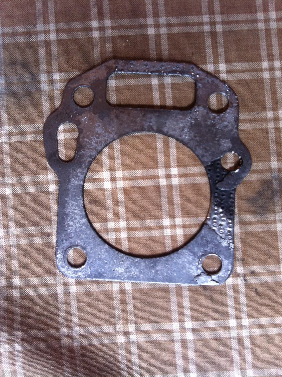

Got some photos of my progress last night.
Confirmed my suspicion of a blown head gasket.
Tonight�s Plan
1) Lap the valves whilst the head is off.
2) Re-assemble the head and reset the valve clearances to spec
3) Re-install the remaining componentry (cowling, starter, valve cover etc)
I have included some photos which show:
1) Where combustion gasses where escaping on the head
2) The blown head gasket
3) My replacement gasket suited to the GXV140 engine which was exactly the same upon testing.
I am fairly confident this should be ok after its all finished because if the damm mower was running ok with the blown gasket (minus the strange sounds) it should run perfectly with a fully intact head gasket � Lets just hope there is no other problems.

was it loose or just blown ? check to make sure everything is nice n flat before you reinstall jaffa (but im sure you know that) strange though unless bad assembly from factory , a lot of other things go wrong mainly fuel worries but not really engine problems so far as i have seen except just too abused and dusted
Posts: 956
Nice work Peter, your methodical approach works well for fault diagnosis. I would have never guessed a head gasket but admittedly i've come across the same problem on a Chonda powered VE40 victa. [Linked Image]
As you can see this one had blown out on the top and didn't have the fire ring around it.

Thanks for showing the head gasket Jaffa,
Yes, I would also like to know if head bolt or bolts where loose.
So engine was starting OK with a gasket in that condition?
I remember a power torque engine I had was hard to start, but did run.
It made a strange noise, like a air chuffing.
Found a piece out of the head gasket on top of the cylinder, you could see the combustion fire through gap. Dont often get to see inside the engine while its running.
