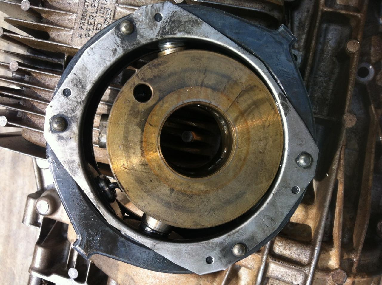

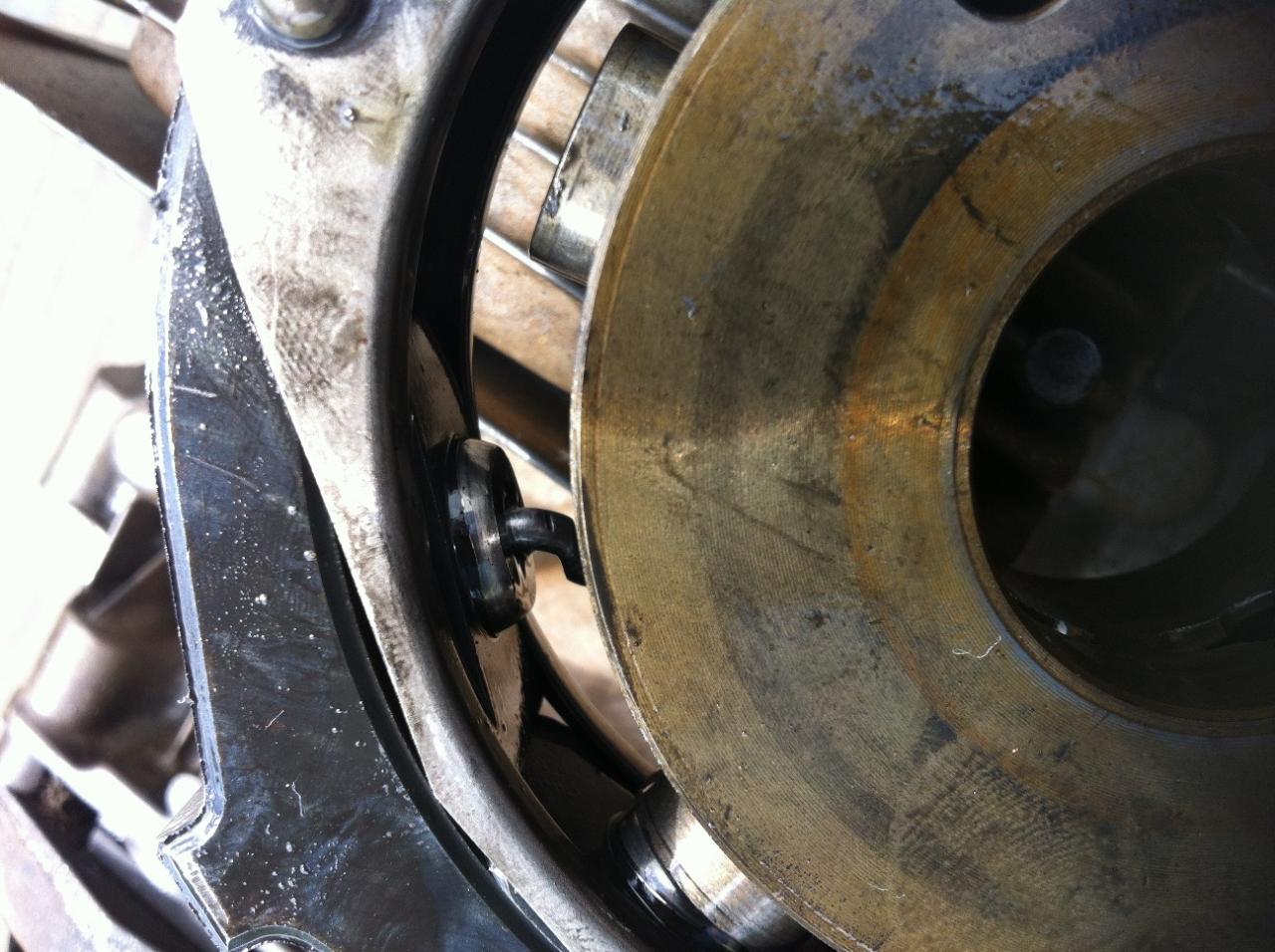

My mate has a Husqvarna YTH160 ride on mower with a Peerless Hydrostatic gearbox that has failed and I am searching for a compatible and serviceable alternative as a replacement to install on his machine rather than buying a new identical transaxle for $1,600.
As Peerless, now a demised company, were a non-serviceable unit, and there are appears to be no parts available to repair the broken part that has failed (photos attached showing bent pin inside the hyrostatic gearbox), an alternative serviceable gearbox is being sought to get the mower running again, unless anyone has this piece from another dead gearbox we could purchase at a reasonable price.

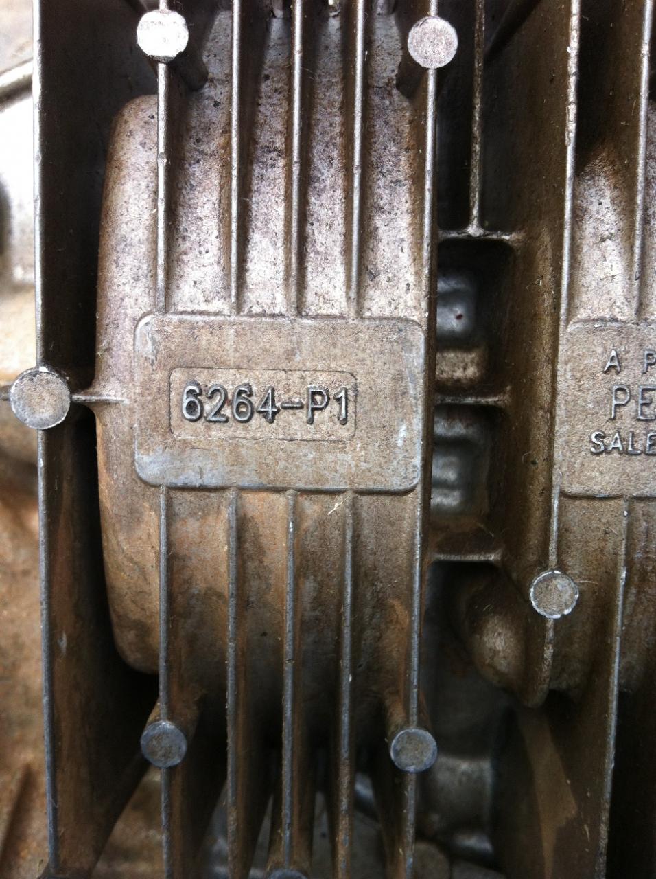

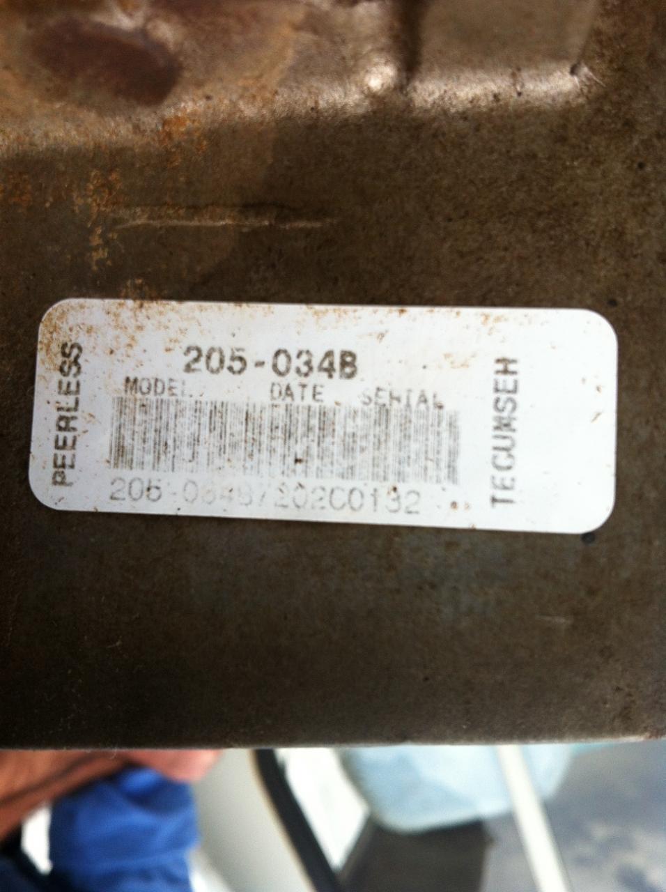

The current gearbox is the dreaded Peerless 6264-P1 series 205, more precisely being the 205-034B barcoded 205034B202C0132.

Hi Buckets. The thought has crossed my mind to grind the four outside rivets off and see if it will disassemble to allow repair of the pin. I'm not sure what the assembly is called. or what it's actual function is, as I haven't been able to find any information on the internals for these units. My best guess is that the pin is part of the hydraulic piston mechanism, which the broken pin assembly appears to have moved inside the casing. From the pictures, there are 5 of these around the outside of the centre unit. I'll check with my mate and see if he'll let me experiment on it. It doesn't work, so what harm can it do? :-) These are non-serviceable, and there are no parts available, so replacement is the only available option. Not much of a design/engineering department, in my mind, for a company to produce a transmission that was not repair friendly, which is why I'd prefer to see a changeover rather than replace with identical unit.
