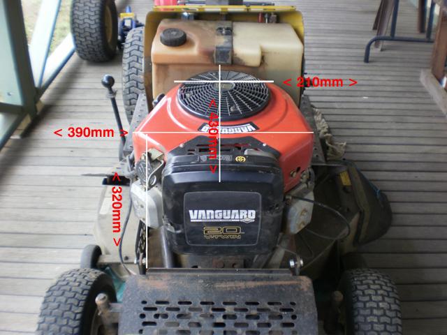

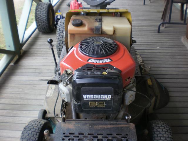

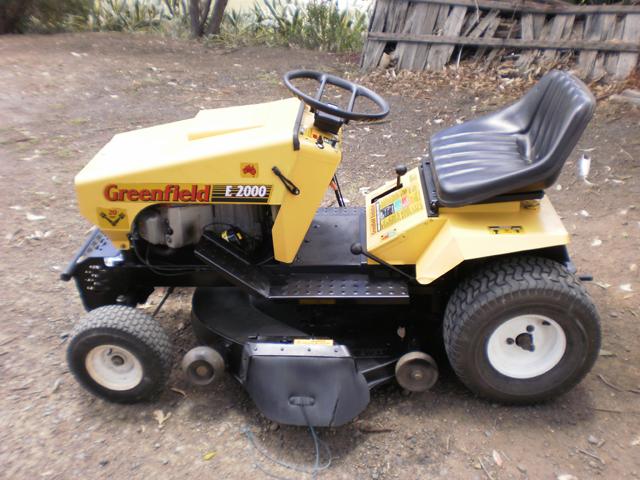

I have a Greenfield Evolution 2000 Mk2 A 34" (not sure if yours is similar).
It had a smaller engine 11 or 13hp in it (no idea if E/W or N/S) and apparently the previous owner after 12mths upgraded it for a B&S Vanguard 20hp V twin N/S.

Not sure if we are on the same page or not.
Are you thinking of putting a North/South engine in to replace the East/West that they don't make any more?.
The replacement engine in mine is a North/South.
Is your mower similar to this except for the 32" deck (see atch)

Will get back to you with some measurements.
Does your machine appear to be the same as mine?
Can you post a picture of your machine?
Joined: Sep 2014
Posts: 113
Note: Some engines have the air filter on top of the motor, which would increase the height.
L:430mm - H:320mm - W1:210mm - W2:390mm

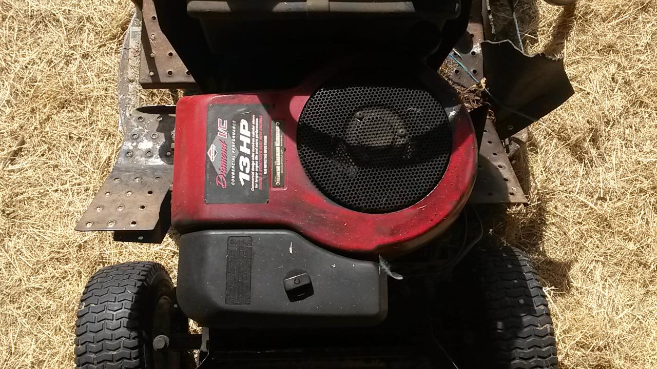

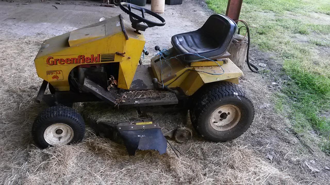

Ok so I've measured my engine . Sorry about the pic quality.
Comparing measurments to those of Buckets in his photo: His measurments in brackets)
Width 390 mm (390 mm) same width along length
Height 300mm ( 320 mm)
Length 360 - 400mm max ( 430 mm)
So my problem will be that if I could source the same motor as Buckles it would not fit lengthwise.
I will await measurements from the sellers.
I suspect also I will need to know that I can fit the motor so the shaft is in the same position or I will end up with problems of belt length.
Will keep you posted.

Chas2, Can you post a picture (like my first one) so that we can compare the machines, that way I can see if we are comparing apples with apples.
Because if the mower is the same model/size as mine, (32" v 34" deck should not matter) then it seems logical to me to believe that, the larger north/south engine in my mower would fit comfortably in yours.
The only other problem I can think of, is if the engine mounting brackets for east/west engines are different to the north/south ones.

Hi Buckets, hope this helps. Your mower does appear to be a later model.

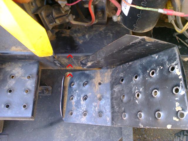

Chas2, was cleaning my mower this morning and noticed a number stamped on the chassis near the forward/reverse pedal,see attached pic for location you may need to clean around the area to find it.
Not positive, but I have a feeling part of the number (mine 2BV-150595) could be the build date.
Yours looks pretty much the same as mine, but as you say an earlier model probably 2-3yrs older.
Will be interesting to get feedback from Greenfield.

Hi Buckets sorry for not replying sooner. Have looked for that number and it not appear on mine.

Sorry to report I have got no further since last post. I have taken motor out and can see that mounting a motor east west as is is the only option. This is because the whole drive assembly is offset to the left and that is where the pulley on the motor needs to be. Mounting north south in that instance wont work, and a secondary problem is that the cowling would not fit again.
If I mount a new motor east west problem is that the top of the motor ( spark plug end) would be wider than the current chasis - only an inch maybe but such that the motor would prevent the foot pedal from working. So I need to move the foot pdeal out further by that much. Nothing impossible but will take time which I dont have any of at the moment.
