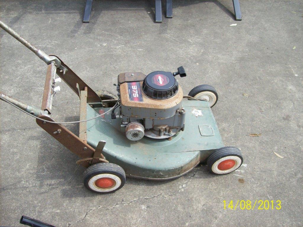

As you can clearly see on this mower I have a chunk missing (from the base) behind the right front wheel.So I started the search for another base,and believe it or not I found one.
I bought it back in 2013 and only just this week I looked at the base only to find it wasn't a 2 stroke model it had a four stroke on it originally.Now I don't want to use it to replace the base on the 2 stroke now I want to put it back together as it should have been.However this model came with a selection of four strokes.As shown below.
So which is the right one.I'm hoping someone has the information I need to put the right engine on it.
Here I'll show you I've got.
This was it as of when I got it.
Defiantly the wrong type of 4 stroke there.
This is only the mower number.Unfortunately no model number,as that would be a huge help.
As you can see it has the old style 4 stroke throttle control.Also it's not a good picture but on the locking part for the handle it has written there Deluxe 4.On the 2 stroke model it has Deluxe 2.
So with all that in mind I'm thinking it would have had the Kirby-Tecumseh K6.5 4-stroke or the Kirby-Tecumseh VK30 on it.
Is there anybody that would have a better idea than that?
Any thoughts would be much appreciated.
Hello Blumbly!
That's an interesting question.
Could you tell us how you know it was originally fitted with a 4-stroke?
The reason I ask that is because of the adaptor plate SB used for 2-strokes.
They could be changed to 4-strokes by discarding the plate.

As I said in the post it has the older style 4 stroke control and the Deluxe 4 on the handles.
Sorry, I missed that.
I'm trying to do a number of things at the moment.
Because this is an early machine - with metal catcher, I'm
favouring the VK30 - but that still does not help in identifying
the cowling. I have not been able to find anything that may help.
Hopefully, a member may have the answer.
Actually that's what I was thinking due to the handle shape and that kind of throttle control.
After having a think I remembered that it was very possible that I had a spare VK30 engine.
So I looked and to my surprise I was right.So now I'll have to fit it to the base and attempt to get it running now.I'm happy at the fact that it could well be the engine that originally was on this base.I just don't know if I will be able to find the right bracket and chrome hat it would have had.
