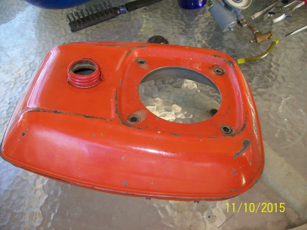

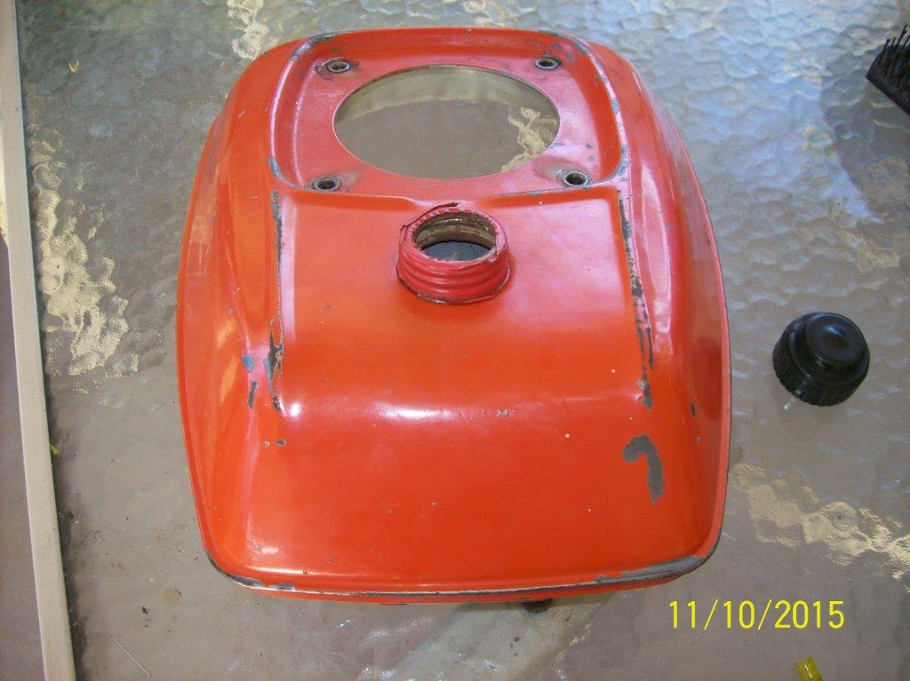

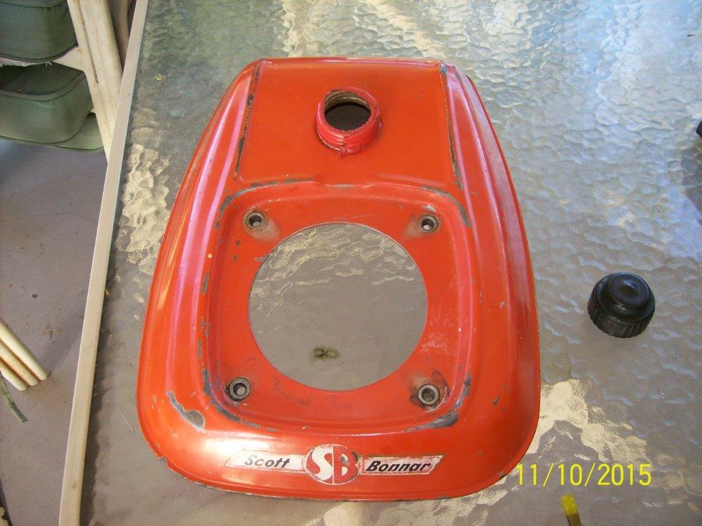

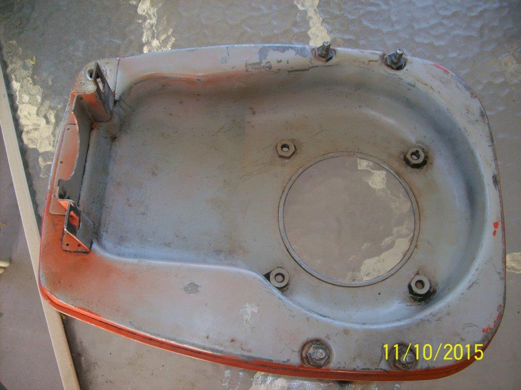

Here is the pictures of the tank.The tank is the whole dress cowl and the fuel runs right round to the front of the cowl/tank.So I guess putting anything other than liquid would be very very hard to get back out. ![[Linked Image]](https://www.outdoorking-forum.com.au/forum/uploads/usergals/2015/10/full-5048-24575-102_0976.jpg) ![[Linked Image]](https://www.outdoorking-forum.com.au/forum/uploads/usergals/2015/10/full-5048-24576-102_0977.jpg) ![[Linked Image]](https://www.outdoorking-forum.com.au/forum/uploads/usergals/2015/10/full-5048-24577-102_0978.jpg) ![[Linked Image]](https://www.outdoorking-forum.com.au/forum/uploads/usergals/2015/10/full-5048-24578-102_0979.jpg) Sorry guys once again my pictures are not coming up. Can a moderator please help me?Why are my pictures at the moment not coming out at all? [NOTE: This is now being looked into: CJ]
