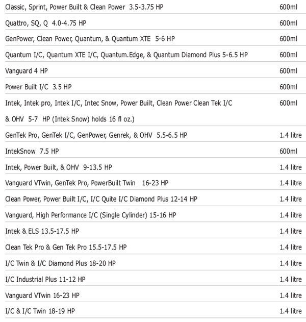

Hi Everyone,
Here is some information regarding Briggs & Stratton HP by Model number:
Here is information regarding how the model numbers work:
Below is information on oil quantities for Briggs & Stratton Engines:
