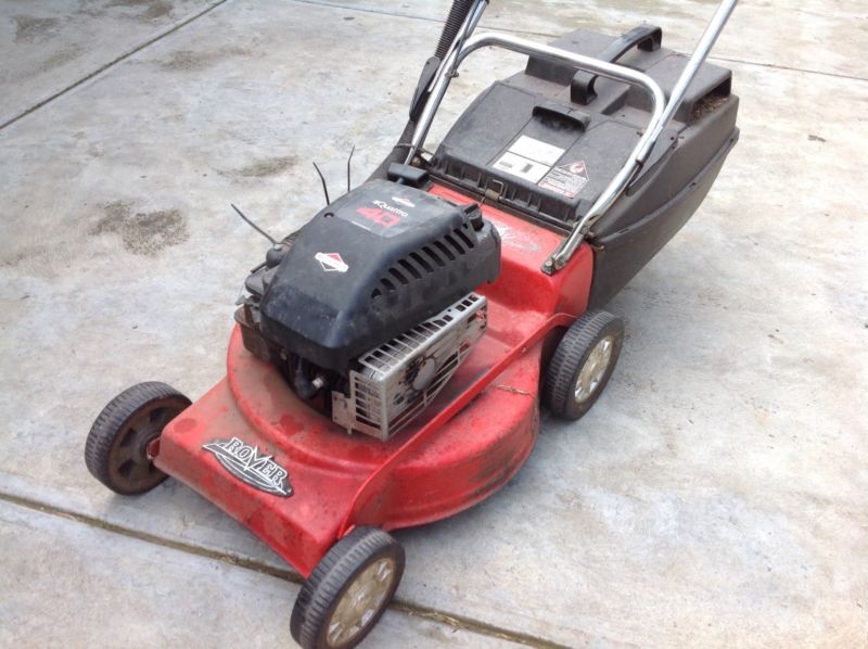

Thanks AVB, attached is an image of what my machine looks like, think it is an L-head. What I'd like to know is how much work I'm up for. Removing the head will mean a new head gasket? Just want to know what supplies I'll need before I start, whether I complete the job is another matter. Have taken 2 strokes apart but never a 4 stroke so not sure how much valves etc complicate things. [Linked Image]
some of the later head gaskets tend to stick so be careful , you can reuse them but its your call as we cant really see what its like , the valve chest gaskets almost always break and a few different types of those again use care , thin blade and gently remove it then check clearances (i cant remember them now but look around here , a lot posts with them ) it is under your muffler , rectangular looking plate , a 7mm ? bolt top and bottom .
a tad more complicated but good to learn tiger , next one will get easier
