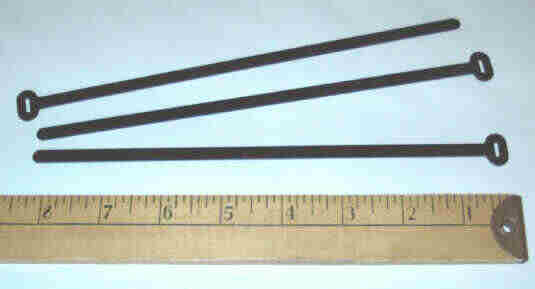

so duct tape was before cable ties lol ?? nice looking machines those though .

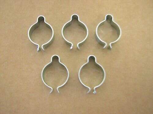

I would suggest that they would have originally been secured part way down the handle with either a metal tie or clip such as those below.
Sir Chook
Hello Sir Chook and Contributors
I think that's right for the sixties and beyond: a tie or a spring clip.
I think that must be right. What frustrates me is an early brochure that shows an
eyelet arrangement:- mad
