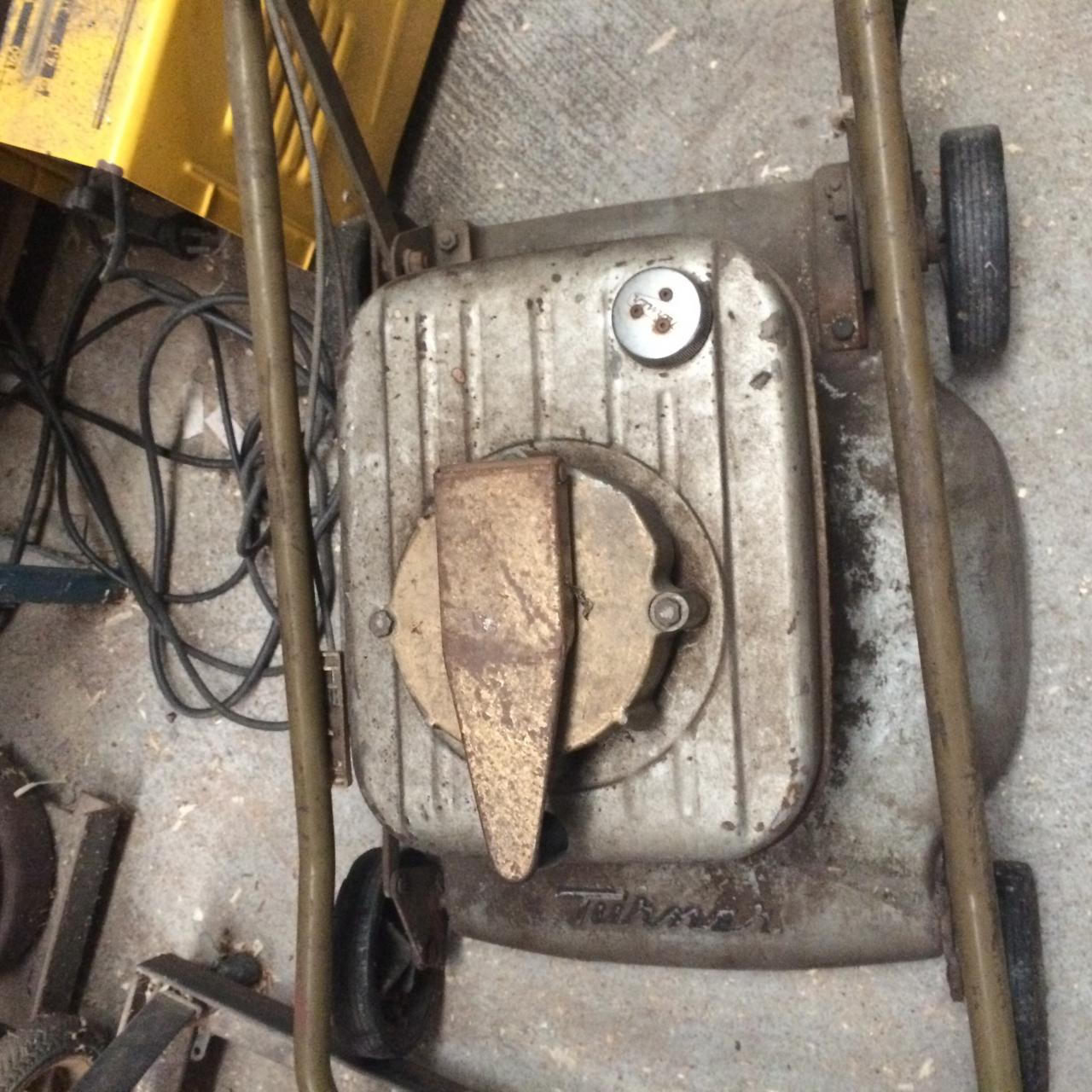

First wind up I've had, most have a lever that you activate after winding the handle, this one doesn't have the lever. Also no sign of a primer and throttle cable is stiff. How do you start these?
Assume it's 4 stroke but I don't know a lot about these.

Hello tiger,
It's rare to see these early 1960s Turners. This is collectable.
I think it is a Model J62 - the silver and grey 18" machine:-
Date will be early 1960s.
It would have a Kirby VK30 engine, probably fitted with a Zenith carby.
So there will not be a primer. There should be a throttle cable and control.
The starter is an Impulse, the one that introduced wind-up starters to AUS.
Because of servicing concerns, the starter was replaced with the newer and safer
Trip Release designs within a few years.
To start, move throttle to fully open (to activate choke) and wind starter.
The starter is activated by pressing down on the closed starter handle.
Information on the carby and starter may be found here:
https://www.outdoorking-forum.com.au/forum/ubbthreads.php?ubb=showflat&Number=58949
Yep, it looks J62,
Its the Utility version in the 62 series.
Check the Raised plate on the rear of the base for ID,
Victas Sure Start"
As Jack has stated, Wind the handle until it stops and simply close to to start. Its whats refered to as an automatic starter,as you dont need to pull a lever to activate ( The fact you had to wind it in the first place kind of negates the term Auto" lols)
There is a pin under the handle that trips the starter when you close it.
These were a really good starter, the best in my opinion, BUT they had spring failures often.
The main issue was broken springs due to the extreme tension.
If yours is free spinning then perhaps this is the issue.
They are very hard to find SH, so a later starter may be an option.
One very Important thing to note with repairs....NEVER EVER ATTEMPT TO REMOVE THE SPRING FROM ITS MAGAZINE!!!! It has the potential for serious injury.
They are a factory fitted spring magazine and should be replaced as a unit, so if its broken, BIN it!
And yes as Jack states, Id also say a Zenith if it has no Primer. The Primer would be located underneath on a Walbro.
Its a nice machine Tiger and one not yet on the forum that im aware of.
Fix the starter, free your cable and give it a good check over and she might be a goer.

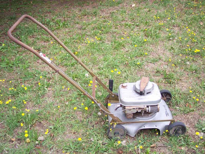

hi all thought odk members might be interested in my turner [Linked Image]
I posted some pics of some old turner stuff.
one day when I get the time i,m going to restore her
when I saw tigers turner I thought I was looking at mine they look identical.
tiger if you would like any of the turner brochures , and others on the Kirby engine I have I can photo copy and send to you just pm me

Another one!
Definately worth restoring Dodgy, especially since its all complete and accurate...
And the Matching ephemera, what a huge bonus! smile

They are the same mower WTF dodegy has tigers Turner? tell me I'm wrong they are the same mower have a look at the pics...
Posts: 988
Likes: 7
Yes you are right, looking at the marks on the front of the cowl.

Wheels match, paint matches, turner black matches,base chunks match, exhaust matches....SAME MOWER.
Please explain lols, To Funny!
base chunks are a design flaw , mine has the same chunk missing and its only a baby 2stroke lol
Joined: Jan 2014
Posts: 86
the closer I look I too think its tigers mower , they don't call me dodgey for nothing !!!
this mower came from a pile of hard rubbish round the coroner from my house and would have been picked up today and crushed by the council, I think I will buy a tatts ticket this week what a laugh,will pm tiger to see what the go is , any other odk members missing a scott bonna 45 found one of these as well on sunday ,
WTF damo,, and to think I had found a good score
