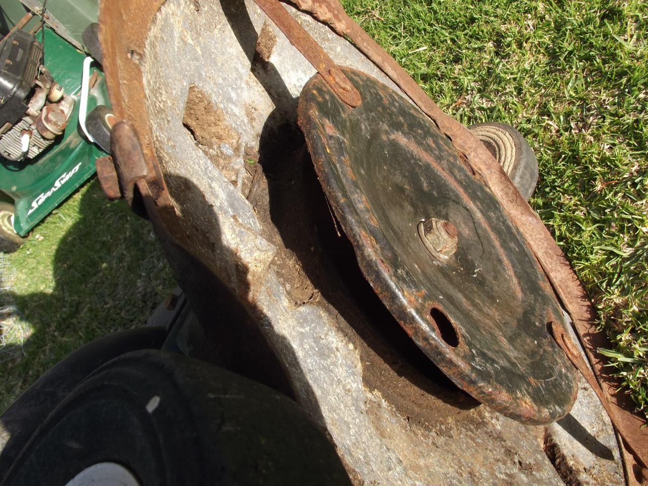

Posts: 715
seanw
Gonna practice my plastic welding on the wheel.
i have a grinder so i can do anything.
I bought some plant pots for her today for 5 bucks so i guess we are even.
sean
motorwannabe
Shes better than your first one, and a Good score for 70$...Just The toe guards start at 50$. A few bolts and a wheel change and Id reakon shes all but right.
What Serial is she running?
Posts: 715
seanw
better than my first one? [Linked Image]
the toe guard looked dodgy, not that i would know. i was under the impression the one in the pic was worth more(not that i would sell) thats why i got it sandblasted. give me a wheel man
sean
motorwannabe
Posts: 715
seanw
pics of
numbers and letters on motor.
IAAAA
12104
0.
Would this be the original motor.
Any info would be muchly appreciated.
Sean.
motorwannabe
Nope....Your mower is a model 5 Series 2.
This serial is off a M5 Series 3...
It was very common to just change the whole motor cowl starter etc of a later mower onto an earlier model as it only required the removal of the 4 bolts, and switch the whole assy over.
This is why your cowl Starter and tank assy are all model 5 S3 also.
Your looking for a serial in in the old style stamping Starting with...eg A xxxxx, AC xxxxx or possibly even the low 300,000s
Posts: 715
seanw
Cheers for the reply mate. what would this be off? [Linked Image]
BAD 20392 3.
Sooner or later i will be lucky enough to find a complete original, I hope.
Cheers mate.
Sean.
motorwannabe
Ive come across a few BAD serials lately, but ive not seen enough to determine their correct order or pattern.
However the Stamping is of the original early style and most of the other examples ive seen are on Model 5 series 2 mowers.
So since the model 3 and dep stores used the finer stamping, Id say this would almost certainly be mid to late M5 S2....But I cant be 100% sure until a few more examples come along.
The rest of the M4/5 Serial range is fairly accurate at present, with just a few unkowns remaining....
Just curious....Did this BAD engine come with this mower sale or is it one you already had? If it was with this mower then id definately say its the original....
Posts: 715
seanw
I am not soaking any info in that i am reading about serial nos.
No that BAD motor came off the one i previously sent a pic of the sandblasted base. So if i put that motor on the one i got today would it be original??
Sean
motorwannabe
Not sure, I dont remember your other mower, except that its a model 5 series 3.
But the IAAA engine on this mower would be the correct serial no for the sandblasted one.
Posts: 715
seanw
so if i swap the engines over i would be close too original on both??.
The other one [Linked Image]
Sean
motorwannabe
Yep, definately on the Series 3....
Whats the serial on the sandblasted one? I dont remember
Posts: 715
seanw
the sandblasted one had the BAD engine number man.
Is that one of those heat suppressors i vaguely remember from somewhere?
Sean
motorwannabe
Ah ok, Then yes, just switch the engines....
Yes thats a heat shield fitted to later Model 5 Series.
Posts: 715
seanw
thanks for the advice man, i still dont know what to do with them
