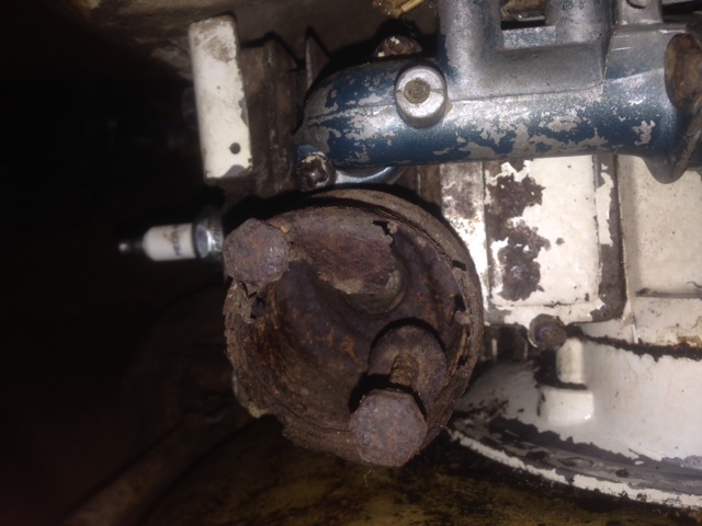

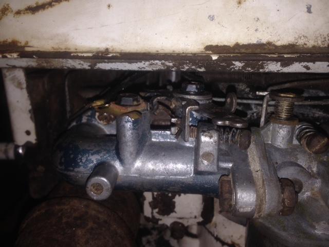

I forgot to take a before photo of the carby but you can use your imagination from the look of the air filter ...
An example of the love this machine has been shown over the years ...
More to come but will have to wait until I can get gaskets and junk ...
Pete.
Hi IHWS
It is just amazing how durable these Kirbys were.
My folks first power mower (Pope) had a VK engine on it.
It was un-stopable - but we kept the filter clean.
This M66/4 Golden Rotary is a real find.
And with a new muffler, silence will be golden laugh
