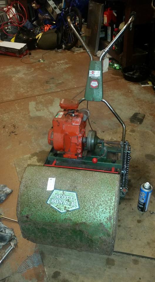

Hi all,
Have recently picked up a SB45 17" at a local auction house over the weekend.
Main plan is to get it stripped, cleaned up and working happily.
I'm currently at work right now so do not have detailed pictures.
From what I have read it is a dual rail model, so post '75?

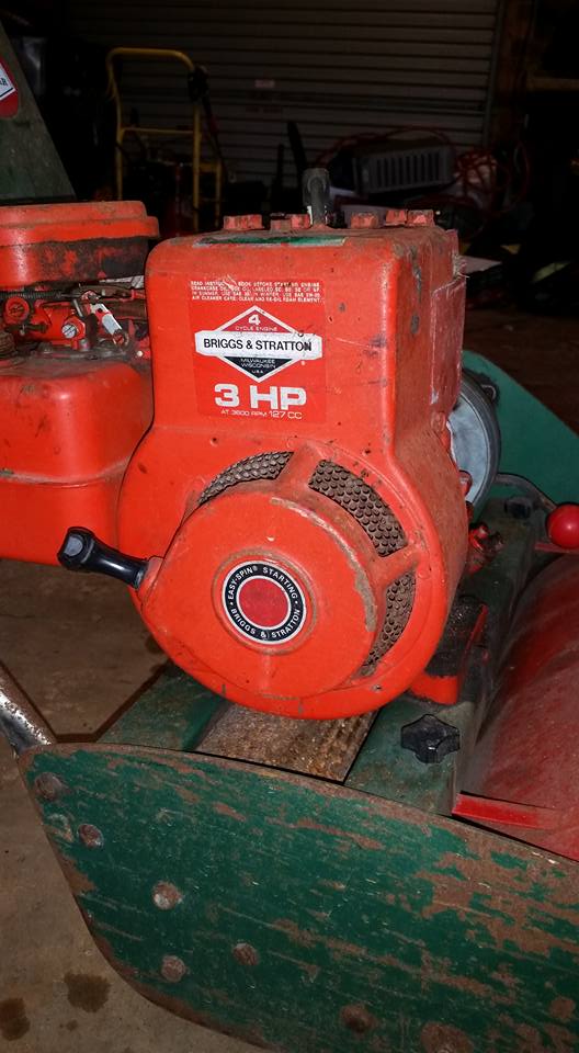

running the clunker 3hg B&S motor.
little smokey when running,
and takes a number of pulls to get started.
I'll put this down to being old and in need of a tune
as well as having an old spark plug in it. (I haven't changed anything)
it is missing what looks to be the governor spring on the carby,
so I'll just control the revs myself

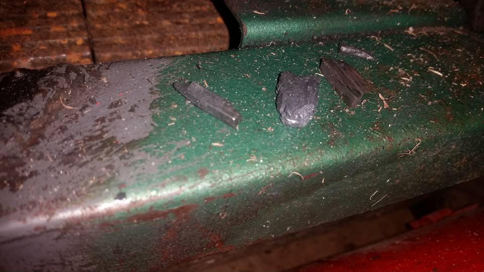

A few concerns, The clutch housing that fits onto the keyway / shaft of the motor has some internal damage.
it looks as though the bolt holding it in has come loose and has been smacking itself against the shaft.
The frame has previous crack repair but I haven't looked at it in depth. (I've owned it for 24hrs)
The blades definitely need some love as well as the edge knife.
from having a quick look they look straightish
with a poor excuse for a paint job peeling off it.
Hoping to clean it up and make it look somewhat pretty,
I have read the brand and colour of paint to use so will get onto that eventually,
will get the body cleaned up and dings removed / rust repaired before looking at this.
The chrome handle bars have some surface rust spots on them but they cleaned up with a quick rub down with steel wool.
The Catcher itself has rust holes in the bottom.
so unsure whether to try and get it repaired or write it off and purchase an after market catcher and paint it up.
Now the long road for repair..
More details to come including engine number / chassis number etc when I get back to it.
SB45 17" due for a cleanup!

Cheers for that!
apart from it being a biatch to start
once started it runs well.
and when warmed up it will start first pull.
only time it was smokey was when at low speed and I open the throttle up.
do these even have stem seals?
I'd consider just an old motor.
I'll do an oil change / spark plug over the weekend.
would anyone happen to have the NGK / B&S part number for the spark plug?

It isn't a cotter pin holding onto the shaft,
just a single bolt which looks to possibly have been tapped in at a later time because there is remains of an old screw there too.
The inside of the clutch housing on the motor side has sustained damage internally and has broken bits off which you can see above.

NGK is BR2LM should make a little difference to starting , choke is a tad of a worry sometimes as they need it for cold start up but once worked out its a pleasure .
oil change helps too often with only a little smoke ? but use S.A.E.30 not a multigrade as they use it faster . does it have the button choke you pull out to start ? if so , pull it out , try starting and it will kick , then push it in , start again and should run nicely with a little warming up .
hope it helps ... cheers2, Dave ....... and welcome to the forums
