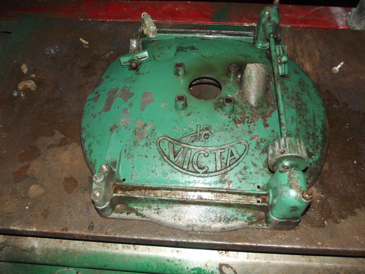

I have been quoted 60 dollars.
Will the base handle it??
motorwannabe
Posts: 715
seanw
Is this a good idea:
pulled apart for sandblasting 60 dollars??
I would like to know what undercoat would accentuate the hammertone avo i want to put on it and if the avo looks better out of a spray can or can I get it in a can to brush on.
motorwannabe
Posts: 715
seanw
I am getting it sandblasted tomorrow. As live on the beach I would like to undercoat it straight away. Could anyone possibly let me know what undercoat to use for hammertone avocado to get the best result?
motorwannabe
None....Its rough cast alloy,and it will be blasted so the bond will be good. Hammered finish paints generally dont require a primer.
If you like you can give it a light etch prime or often most blasters do it for you.
And importantly...NO grubby fingers or oil and dirt should be allowed to touch the metal after blasting. Pick it up and wrap it up till your ready to paint.
Blow off all the fine dust,prepsol re blow and a light dry with a heat gun helps.
Then Paint away....light coats, then a heavier coat to bring out the hammered look.
And NO puncturing cans!!!!!!

HT6 thanks man. First time getting something sandblasted. I wasnt sure untill you answered that i was going get it done. The deciding factor was the hammertone effect it makes and that it is a female and I recon she may put more care into it? is 65 dollars a good deal(spose it depends on the result)
