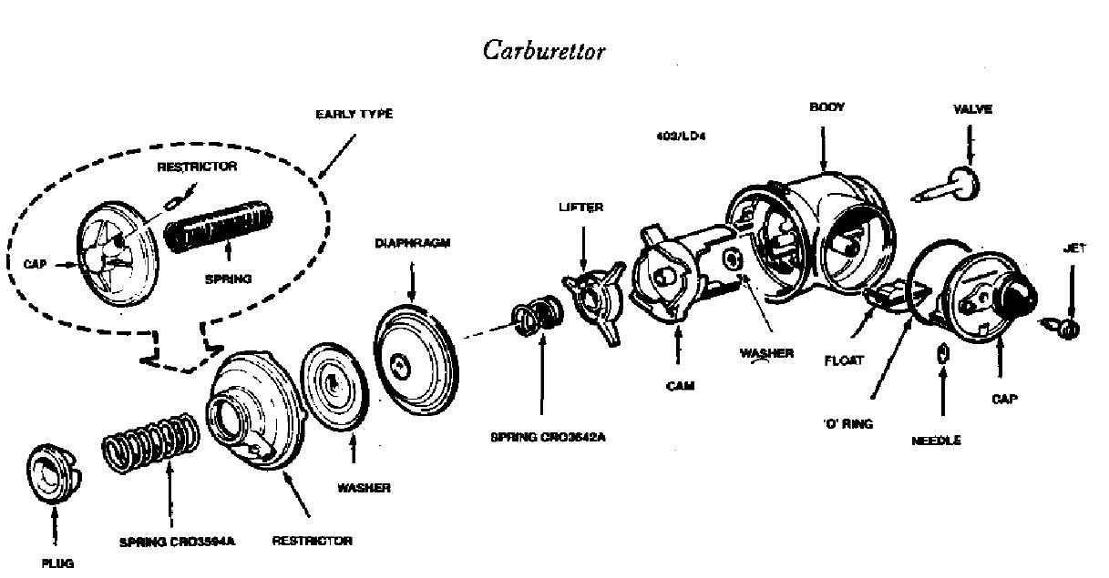

Here is a parts view of how it should be.
The only thing I can think of at the moment is the earlier poppet values use to have letters on them and they had edges on them and for certain mowers they had to be in a certain position.The newer poppet valves however don't.

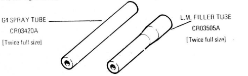

The only difference is the spray tube,which both have.However the G4 has that tube fastened to the end of the jet where as the LM has the tube installed into the carby body.Once the tube is installed into the carby body it is there forever as it can't be removed.
See tubes here.
