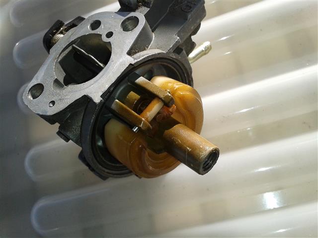

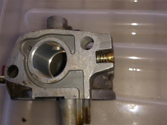

-I ended up followed the methods in the previous threads and ended up stripping the carby and cleaning it out. When I removed the float bowl, there was a rusty glug on the bottom which I think was also heated on around the bowl itself. It wasn't exactly the same in the above parts but close enough. I don't think I found any port blocked but I used the carby clean as the tool pick, so I am not sure. The glug I assumed was the general cause. I checked the gaskets and they all look ok. When I reassembled it, unfortunately it wasn't fixed. I may have to do it again, but this is why I thought to post my situation. I also not sure that my throttle cable is setting things right as there is a bit of play if you pull the cable, and the indicator isn't quite reaching the end stops. Also the link to a workshop manual isn't right anymore so I cant check the governor speed setting or the throttle adjustment either( I think its just the cable). I have had this for about 5/6 years from new, and nothing has been adjusted or changed.
- Since the clean the mower still is very poor at starting from cold, but I did get it to start after moving the throttle a bit. When it did start at cold, it splutters badly, but it really thrives well at the run position. It also doesn't slow down at all, until we go to stop, then quickly recover back a bit, which then is slower. Even at this point, beyond or higher than the run setting it splutters again. On reflection I am worries about an air port that I may have cleaned properly that feeds to the pilot jet. I have some pics of the unit and some during the first clean. I tried to do what has been said before in other threads first. Any advice is appreciated in advance.

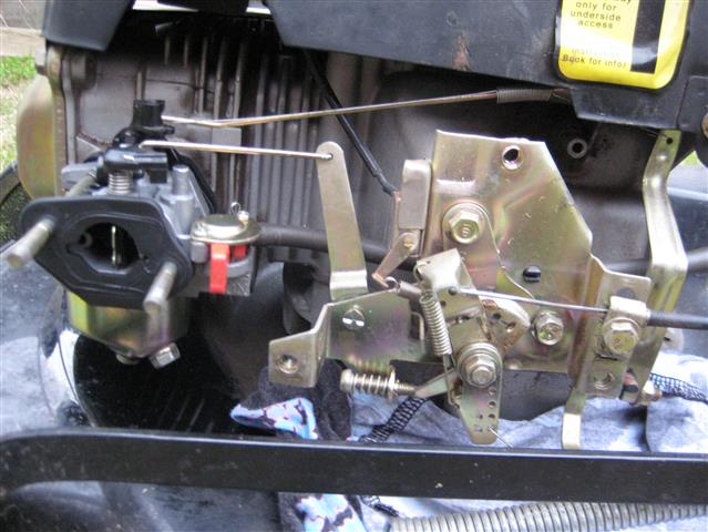

Ok I had another play with the mower. I lubed up the linkages with the throttle mechanism, and took of the air filter assembly. I used your idea with the bread tie, to clean the air intake to the pilot tube. While I did this I notice the main fly doesn't quite close the chamber fully, but am unsure if that is what it should be. I also notice that there isn't much change to the air intake via this and would like to know how the fuel system works to adjust RPM.
Anyway, after I did this, and everything was back on, low and behold the easy start was back. Just a simple pull to start and the engine ran pretty nice there and also in the run setting. It also had a noticeable slowing down of RPM as I went down the range to stop.

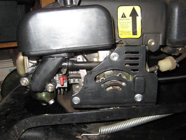

Unfortunately this didn't last. The starting is still perfect, but it runs very poor (it putt putts), with a dark exhaust. When it does it run pretty fast and well, but the change in speed isn't as good, and it basically stops on the spark cut off switch. So we are on the right track, but need a bit more work. If I had a write up concerning the throttle adjustment it would help, along with some info regarding the fuel/air actuation method. Here are some pics in the cold start and off throttle positions and the throttle mechanism positions.
Cold start, notice the slightly open fly position
Stop

You can get a bit more choke by gently bending down the tab circled in red seeings as your cable is already at the end of it's adjustment. This should solve your starting issue if you're not satisfied with how easy it starts. The more you restrict air flow on cold start up the easier it will start as manifold vacuum is forced to pull fuel up through the venturi to enable startup. With the choke not egaged all it does is suck air in from the filter housing.
As for your putt putt issues and dark exhaust emmisions 2 main things spring to mind from my experience. First and most likely is a blocked air filter, even though it may look clean and clear it's probably damp with oil and not letting it breathe. Remove the air filter from the assembly and start and run and see if this rectifies your problem. Second possible cause is a faulty spark plug, replace and check for symptoms.
There is a possible third cause, to do with the pilot jet, but this is unlikely given your symptoms and we'll get into that if the other 2 remedies fail to yeild favorable results.
Give these a try and report back and we'll go from there.
