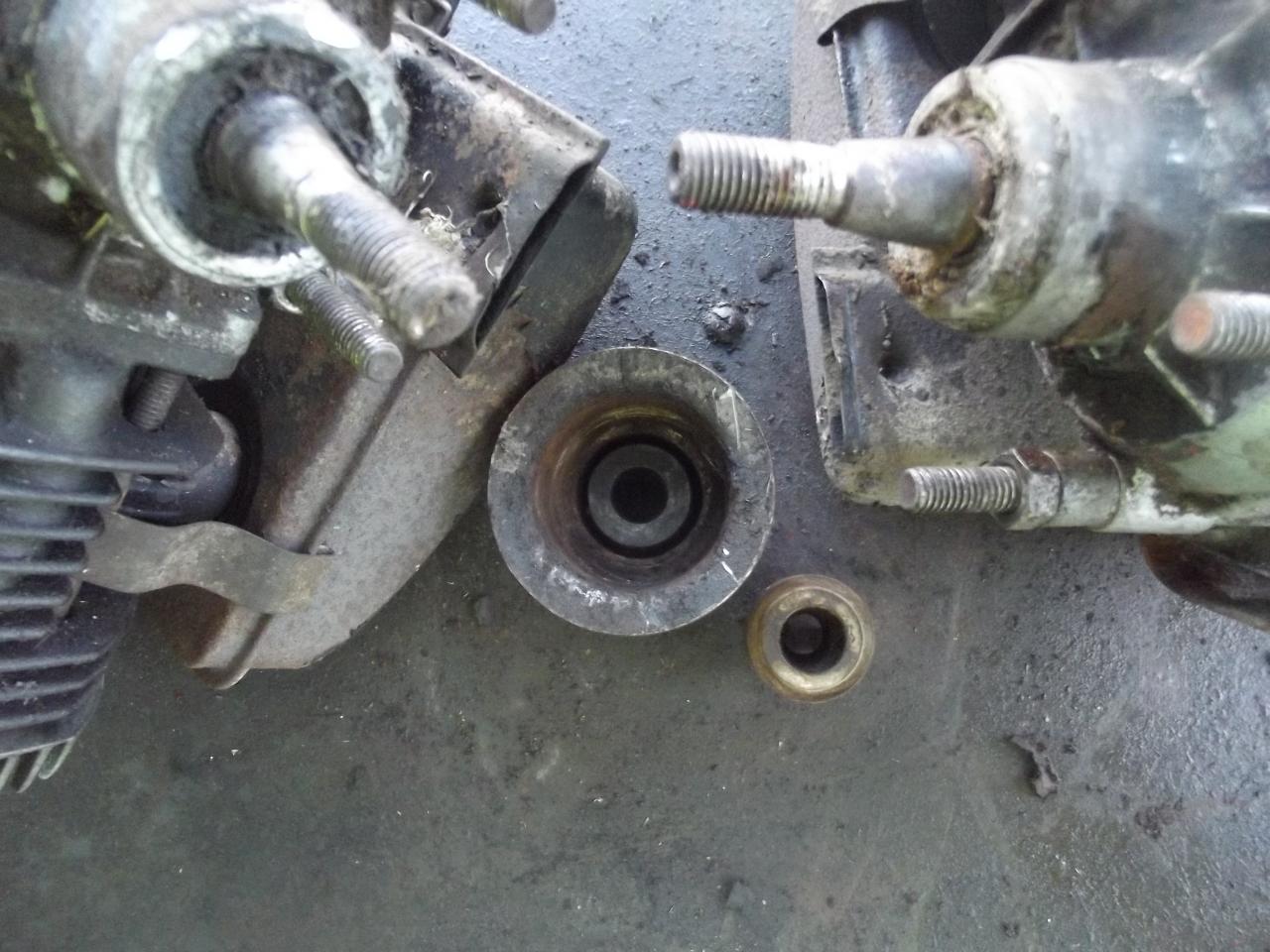

seanw
Vccomm they have different shaft sizes i cant fit the pully on
What to do? is there an adaptor boss??
motorwannabe
so same length but different diameter ? well now we both learned something .. so now its looking like you do your 1st tear down see whats wrong inside which isn't normally too much
aaaaaaah , i found before the side pulls did have a different crank though , do you have another good side pull 80 series ? if so , check that out , one here but too hard to send up there

I have been thinking all day about this issue.
1. can I just use the smaller boss.
2. Weld a couple of beads around it to make it fit.
motorwannabe
nope , it will weaken it and distort it too so if it does go back on might never come off again .
just pull the head n barrel and have a little looksee , even totalled inside you can use everything from other engines except the crank .
new bearings and seals and you have yourself a new engine for very little cost maybe $40 at most if no piston n rings are needed

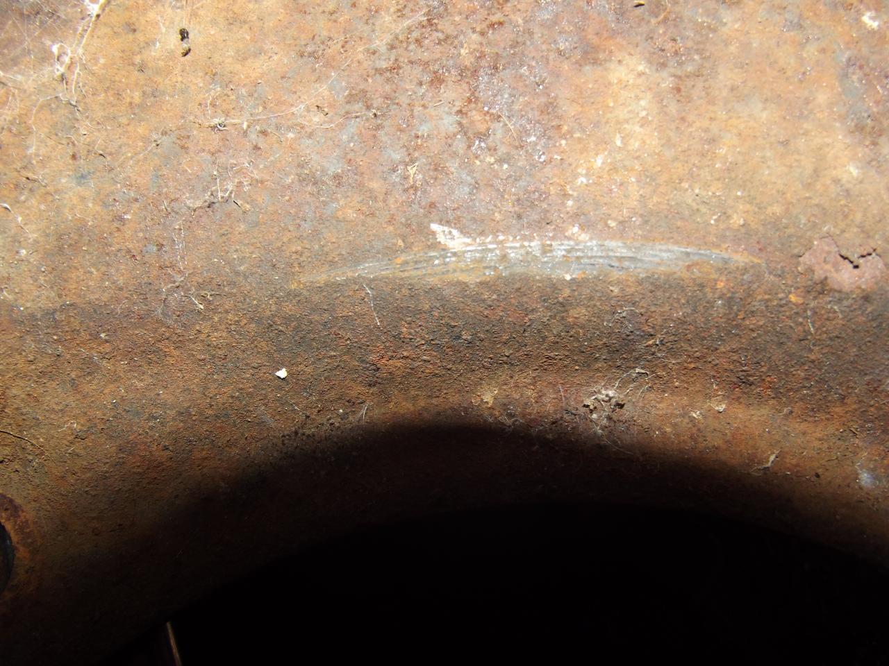

this is it. [Linked Image].
motorwannabe
cant really see a problem in thar , so what was the noise you told about ?, already 20 thou over too , so if piston is still good you need to stick with it . looks a tad dry though . pic' of inside the head too ? i'll tell you why later if we like whats there wink
the noise wasnt just a badly fitted or bent cooling cowl ? (black tin top cover)
that head gasket is home made too , who's been in there tinkering huh

Yes i recon the noise was the cowl,
ps. I made the gaskets out of the cardboard in the middle of a vb 30 block.
I dont trust this carby.
Found scratches on the cowl.
