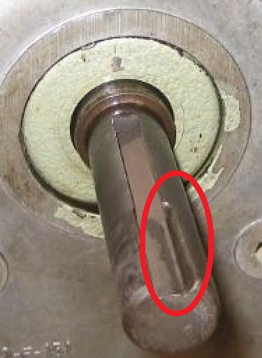

I have removed the set screws from the cover and loosened it, but I can't get it to move more than about 3mm. It appears to be held by a bearing on the crank shaft. Do I need a special puller? Or is something else I'm not familiar with holding the cover?

I think we need a picture of the crankshaft extension (the PTO) where it emerges from the crankcase. It is common for there to be a build-up of hard crud there, which won't pass through the main bearing bore. However if this is on an SB45 it is also not rare for a previous tenant to have put a sleeve over the PTO to keep the clutch from sliding toward the engine. If that has been done, you need to take the sleeve off first. So, pictures please.

Thanks. The engine is from a Victa Imperial barrel mower, has a longitudinal keyway, and is quite clean. I thought it may be buildup of muck on the shaft and if there is any it is obviously hidden from view at the moment.
I'll go and do some more pushing, shoving and tapping with my hammer and wooden dowel.
Michoolie
The reason I suspect a ring of hardened crud, aside from having seen it repeatedly on Briggs engines, is that you said you can pull the cover off for some distance before it jams. Usually that distance is exactly the distance from the outer lip of the oil seal to the outside edge of the main bearing. In other words, you can move the cover until the crud ring hits the bearing.

Good O. I understand the problem - but how can I clean off the crud when there is no way of getting to it? Even if I made a puller I wouldn't feel happy about using it on the Aluminium alloy cover. I made one to help with the removal of the fly wheel, but it is a much more robust device even though it also is alloy. Also, the crank shaft is not in the centre of the crank case cover so the force on the sides would be uneven.

I'd need to see pictures of the shaft and crankcase cover, with the cover in the installed position. At the moment I just don't have enough to go on.

I tried attaching a photo but without success.
I clicked on the link below and a large version of the photo appeared but for some reason it is not attached to this comment. Maybe the same will happen for you! I'm not familiar with the operation of this setup yet.
Hello Michoolie
I've inserted that photo for you.
Information for attaching photos HERE.

Thanks. Has it helped you to think up my next move?
A friend suggested that I may be able to remove the oil seal and get at the shaft to clean it.
Michoolie
First, the keyway is damaged on the crankshaft:
It isn't really good enough to use at this point. Was the engine on a Scott Bonnar 45 mower? That mower has a strong tendency to cause this kind of damage, but by the time it has happened, the engine support rails are usually cracked or even broken, as well.
IIRC that oil seal can only be removed by drilling a couple of holes in its metal cover and using them to prise it out. If you are going to proceed with an engine overhaul, that process is a standard part of it. However without knowing more about the mower, and your overall enthusiasm for persisting with this engine, I can't advise you whether it is worth proceeding.
