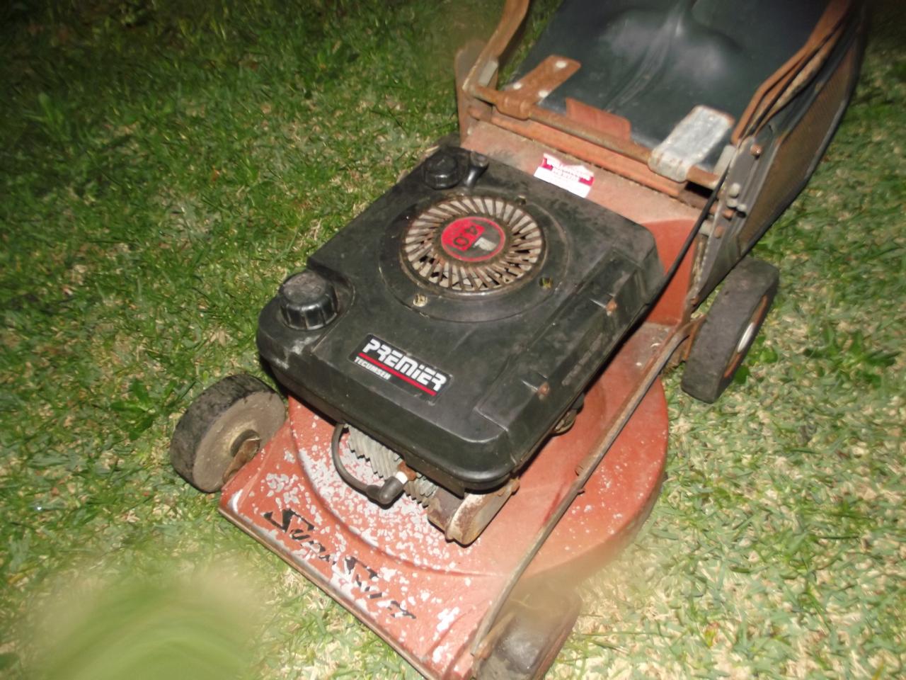

I have included a couple of photo�s below which show the mower is in quite good condition.

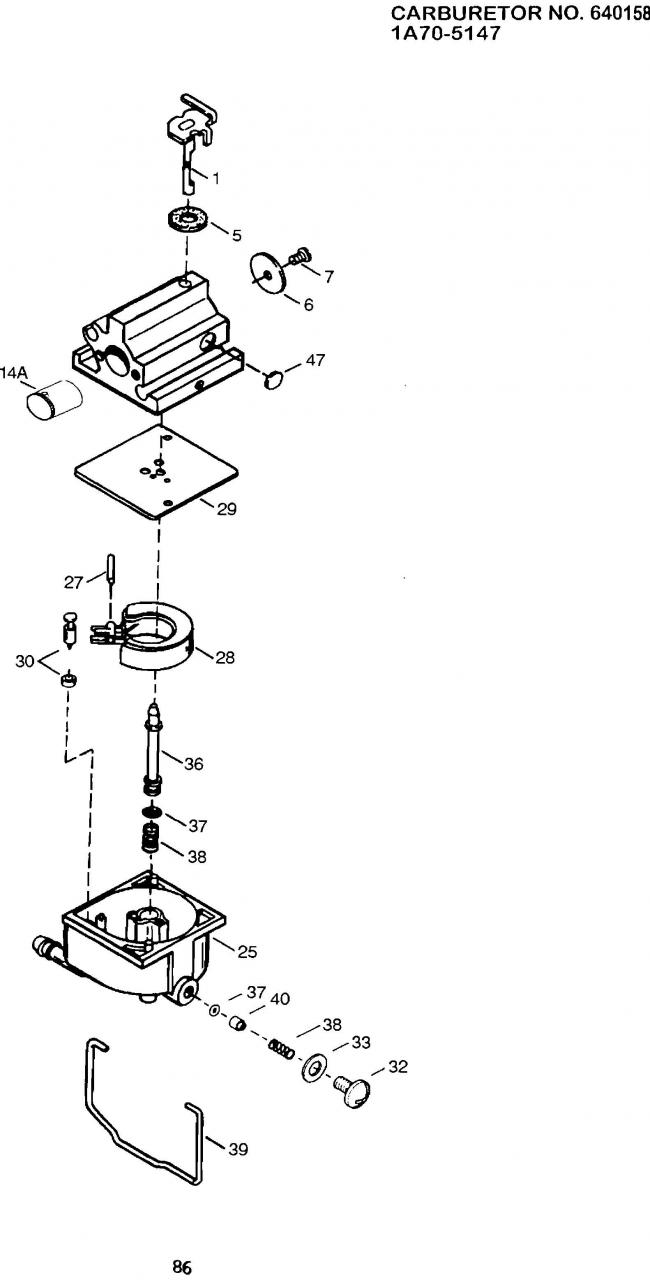

Below is an image of the Ultima carby. I want to know if you replaced item # 37 on both the main jet and base of the carby. If you have not changed the one in the bowl then that is what might be your problem. From memory they did have some issues with the main jet but would have to look for notes that I might have on it.

Initially I only replaced the o ring on the jet and not the emulsifier so I replace thed emulsifer o ring and now it revs right up after 1 pull. It doesnt chugg away like before or blow any smoke. Lesson leart to always replace the o rings even when they look spot on!

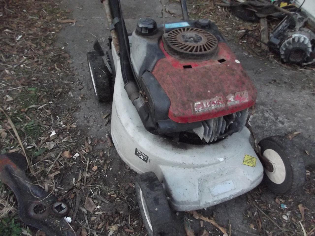

Is this of the same ilk? [Linked Image]
I.s this a relation to yours, it has compression and spark, wont start, cant play the banjo. I am learning this lawnmower stuff from here.
Lawnmowers are like women, they start easy or refuse, they are lubricated or not they cut you when they want, they need a shove.
Enough from me
motorwannabe
Posts: 962
Sean, the top one is exactly like Jaffa's, less common but a real powerful unit. The bottom one is your regular TVS series tecumseh.
Posts: 962
Jaffa, i was going to suggest the bottom oring but Bruce beat me to it.

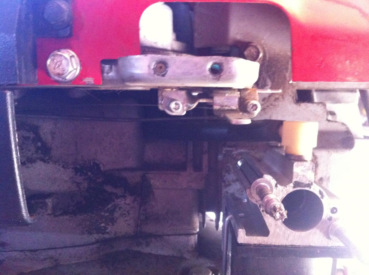

I have include a photo of the governor linkage and to the best of my knowledge it is not binding with the breather hose. Everything moves freely as it should.
The mower is still running to fast (you could call it holding the throttle open as I cant get an idle at all. When you move the throttle to the full speed position the actual speed of the engine doesn�t change. Its still full speed.
Sorry I got on the wrong bus there: when you said at the beginning that you'd replaced both the O rings, I took it literally. With the emulsifier O ring leaking, I would expect the mixture to have been rich, not lean, and the symptom would have been the engine speed "rolling", like a car with too much choke applied.
I think you should try to push the throttle linkage down to idle by pushing on it directly. Once you know for sure whether it is just a matter of the throttle being held open by the linkage, you'll be halfway there. The problem sounds as if it will probably be related to bigted's diagnosis - some part of the breather tube holding the throttle linkage - which you may be able to verify just by removing the tube completely and seeing whether the throttle butterfly will then return to the idle position.

I should have been a little clearer in my original post re- the o rings. I replaced the one on the jet initially as it simply wasn�t present with the carb however the o ring on the emulsifier look pretty good so I left it as is. Note to self: just replace each ring next time I get another ultima!
