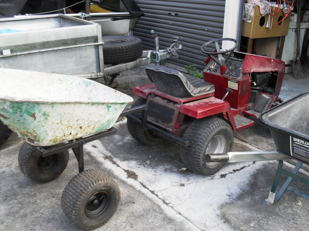

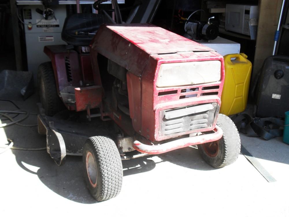

its been getting around now that i have a passion for old mowers ,which led to one of my wifes' friends donating there sad rover rancher to me. yippee for me. yay
it now runs great and i used it to load a skip with concrete last weekend after making a tipper trailer for it.
i had to fix the rear end this weekend as it had a broken bearing etc.

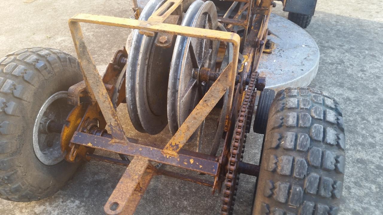

my question is that it is an automatic type with a double pulley clutch type setup to drive.
What is this system called???
Searched the internet for all the relevant drive systems for ride on's and am still in the dark.
the only reference to it was on this site.
looks similar to this: https://www.outdoorking-forum.com.au/forum/ubbthreads.php?ubb=showflat&Number=33166

Love the trailer. Can't help with the drive. I have a Rancher but it is completely different drive set up, although the cork disc clutches look the same.

The system is called a friction disk drive. It is unique to australian mowers, originally invented by the man who created greenfield mowers which still use the exact same system today. In the mid 80's rover copied the drive and later AMC copied it as well but they made the disks smaller and they diddnt handle heat and werent as smooth as the original. It is extremely simple and very efficient

This is a Greenfield mini tractor 8 1975..
Same friction plate set up, the Cox use a cone friction drive set up... both use cork as the friction material.

Old Mr Greenfield must have spent many sleepless nights staring at the ceiling trying to work out how to get this design to work. I have never pulled one apart but it sure is an interesting design, 2 pulleys on a single shaft spinning in opposite directions. It is on my bucket list
