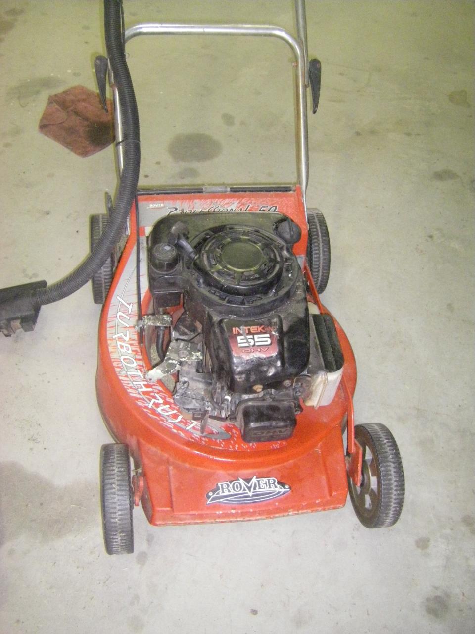

Hi, A chap bought back a Rover "Professional 50" I'd sold him some time ago. It has a 5.5HP intek engine with OHV's. He couldn't get it to start and neither could I. However, it would start and run happily if I squirted some petrol into the carburettor or if I blocked the carburettor air intake with a rag but no luck otherwise. I've cleaned the carburettor twice and now it will kick and backfire back out through the carburettor. Pull start action is smooth so I don't think there is any timing problem there and it runs well if you start it with a prime. I was thinking it might be a valve but I still have doubts about the carburettor. The engine markings are 124602-0111-01-050823-FA. Is the consensus valves or carburettor fault.

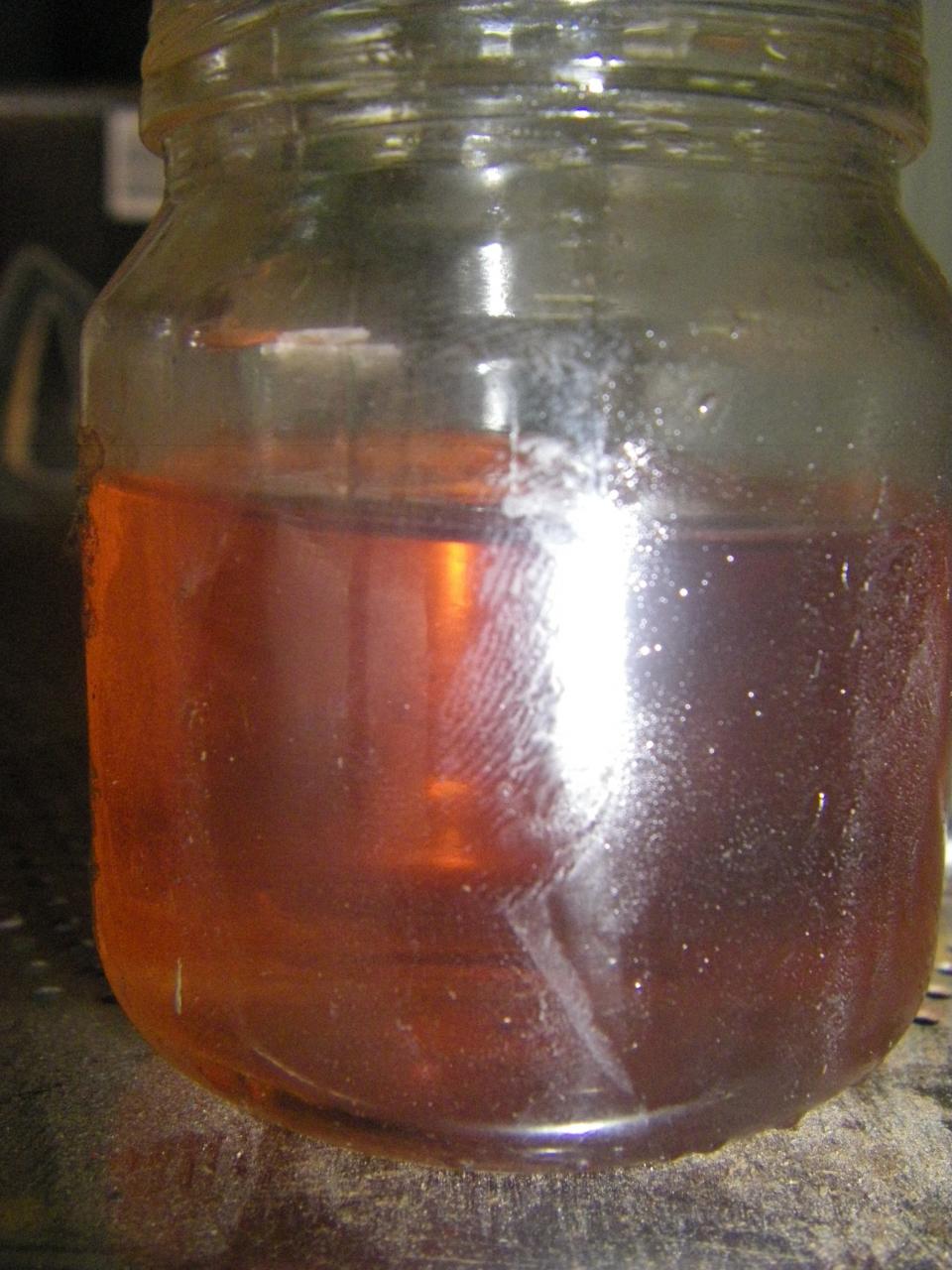

It seems the only thing retarded is me. I should have checked the simple things first. It might be fuel. The photo's below show new fuel and old fuel samples (I don't think the pictures highlight the difference as well as true vision). The old fuel was very cloudy even and though it has a fuel filter in-line I don't think a filter would stop contaminated fuel but is there for debris only. I have drained the tank and carburettor and it now starts. I'll try it again in a few hours just in case it is a fluke. I know bad fuel can cause starting problems but could bad fuel cause backfire through carburettor?
The bad fuel may have contained ethanol, and there may have been water in the tank, so now the fuel contains hydrated ethanol. Certainly you can't expect the engine to start well in that situation, since it changes the required air/fuel ratio and also will not flow through the jet properly.
Australia does not use the various ethers that are added to a lot of American fuel. They cause a need to add stabiliser to fuel that will be kept for even a few months. However some of our fuel does contain ethanol, which is hygroscopic and can cause trouble. Typically when it becomes hydrated it changes appearance, and to some extent smell, so if you are alert you can probably guard against what happened. However my preferred solution, for several reasons, is to avoid fuel containing ethanol. Water does not mix with petrol, it lays on the bottom of the tank, and in the bottom of the carburetor float bowl, typically stopping the engine from firing or running at all.

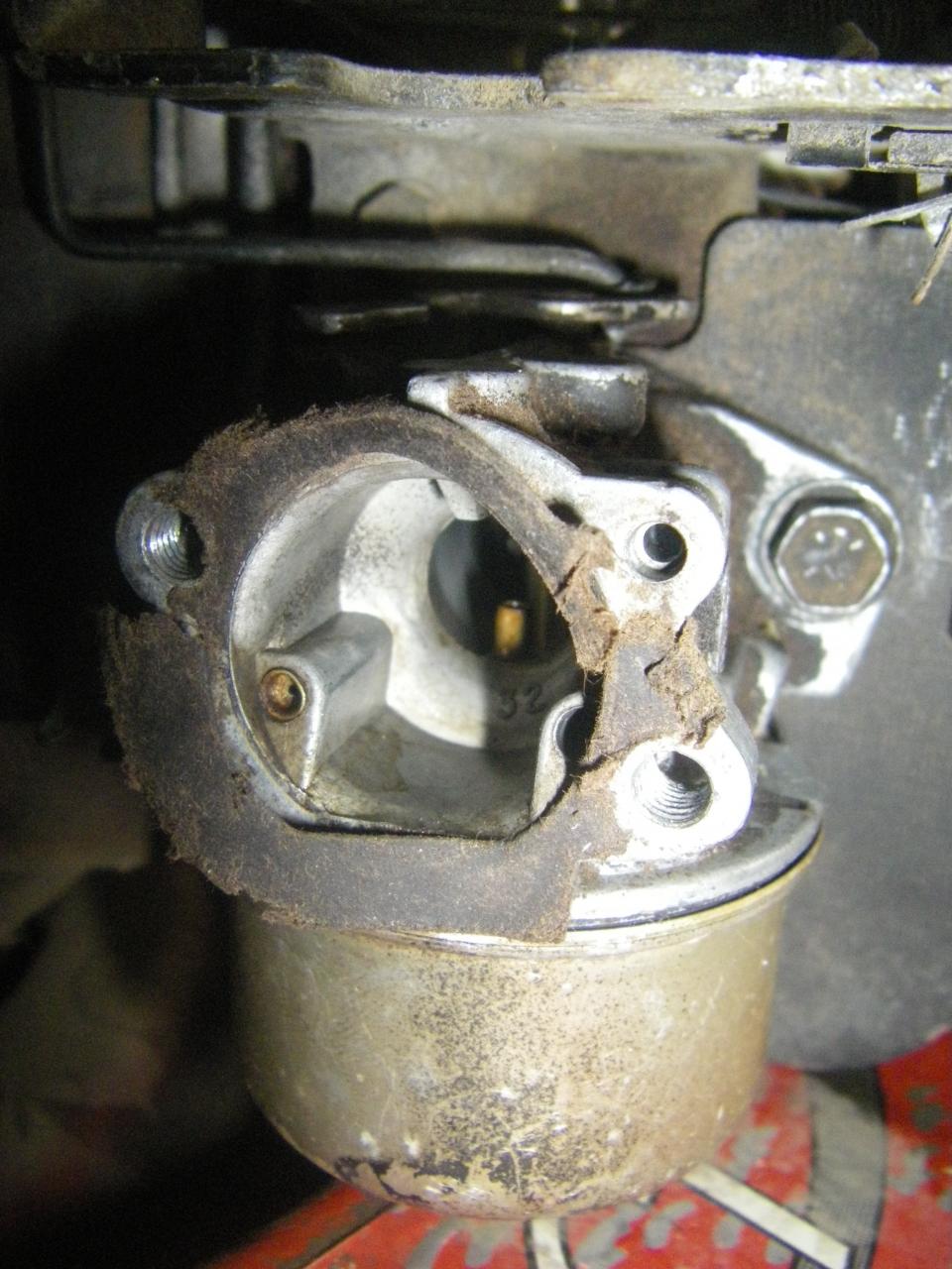

Hi Grumpy, that little jet on the left you can see in the picture (is it an air bleed?) was blocked when I first cleaned the carburettor but it still wouldn't start after cleaning it. Once started, with a good fuel prime or choked with a rag, it would start and run on that bad fuel without any problem. I think this fuel is at least part of the problem but I may not be out of the woods yet.
The restricted hole on the left provides air both for emulsifying the idle mixture, and for the emulsifier above the main jet. Let's wait for more data to try to figure out whether the bad fuel is all that was wrong, but it may have been.
