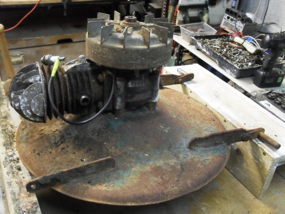

.spent the day cleaning up the magneto etc to get it to spark. took me a while but it has great spark now.

Good job, good video. I will check out some of your other videos after dinner. What number is it ?
Gizmo #64829 09/06/15 06:34 AM
Likes: 9
engine number 58654

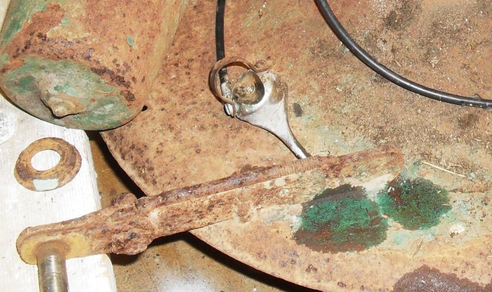

Just curious, is that a model 3 base or has it had larger front base mounts welded on? They look higher and shorter. smile
Gizmo #64836 09/06/15 08:35 AM
Likes: 9
someone has welded a top piece onto the base mount to strengthen it, its a bit hard to see in the pic.
