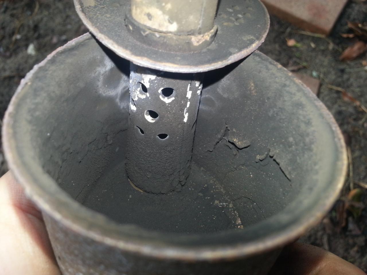

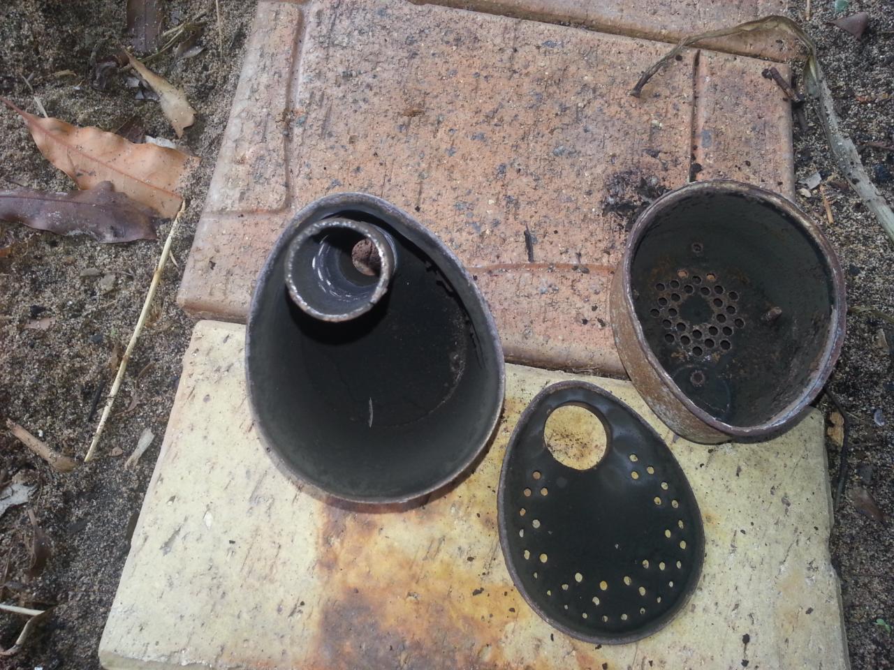

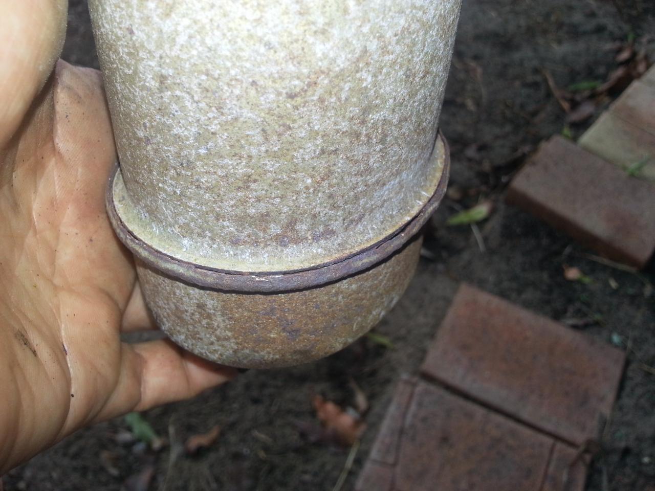

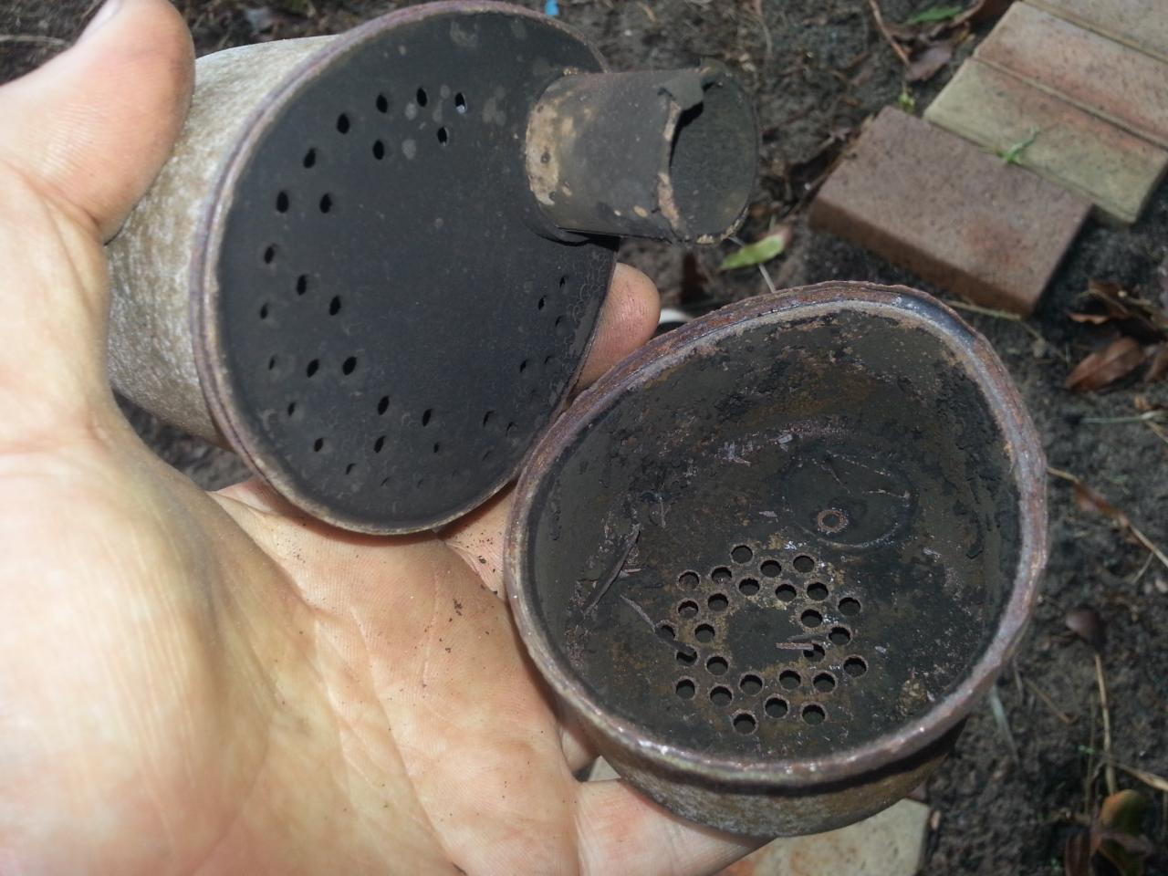

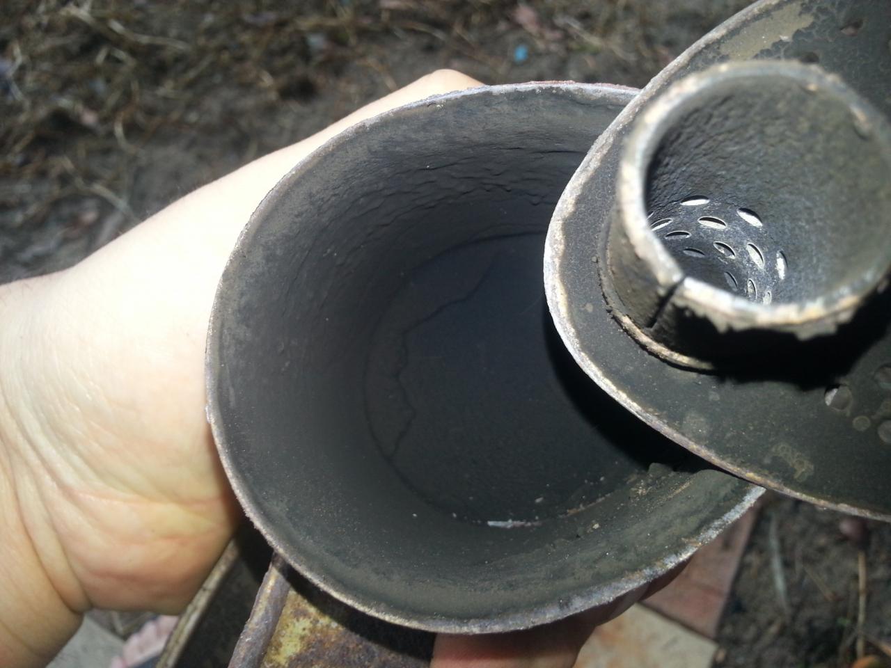

For those of you who have ever wondered if you could take apart and clean this (old) type of muffler...well, you can. Whether you want to is another story. The only tool I used was a pliers wrench, to carefully curl up the rolled edge (bit by bit). The rolled edge clamps all three pieces together. There didn't appear to be any sealant between the edges and it all came apart quite easy actually. Here is what it looks like on the inside...yikes!!! Should be a simple matter of crimping the edge flat once your done. However, I am not sure how many times you could do this comfortably.
