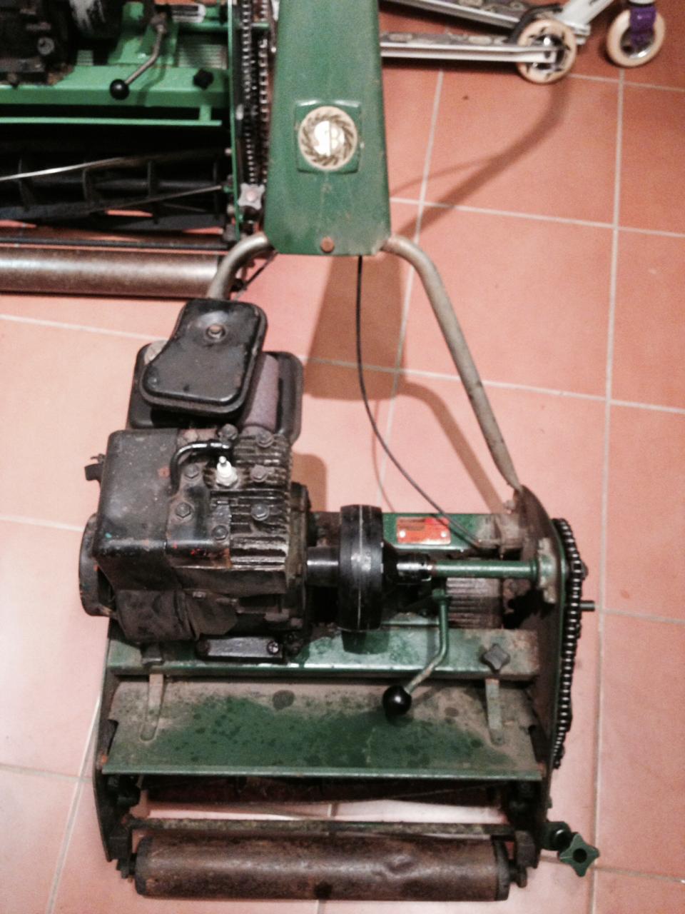

Hi just picked up another SB. I wanted one as a back up but this looks a lot older than my other green rover.
Any idea of the age?
The clutch needed adjusting and it looks like they have painted the engine black.

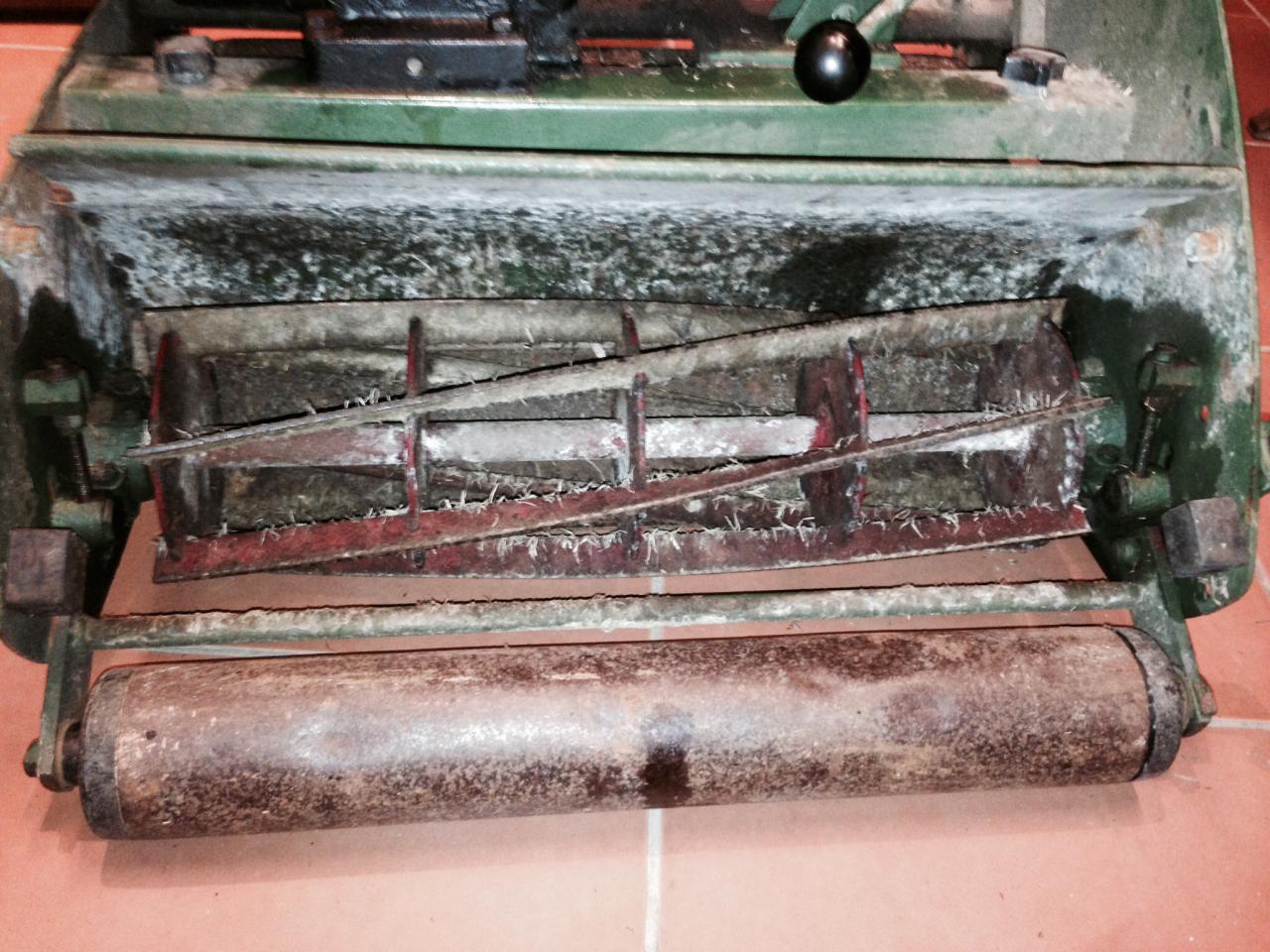

The other weird thing is that the height adjuster has the spring on the wrong side of the frame. Any ideas on how to take the adjuster handle off?

The front roller is pretty dinged up too.

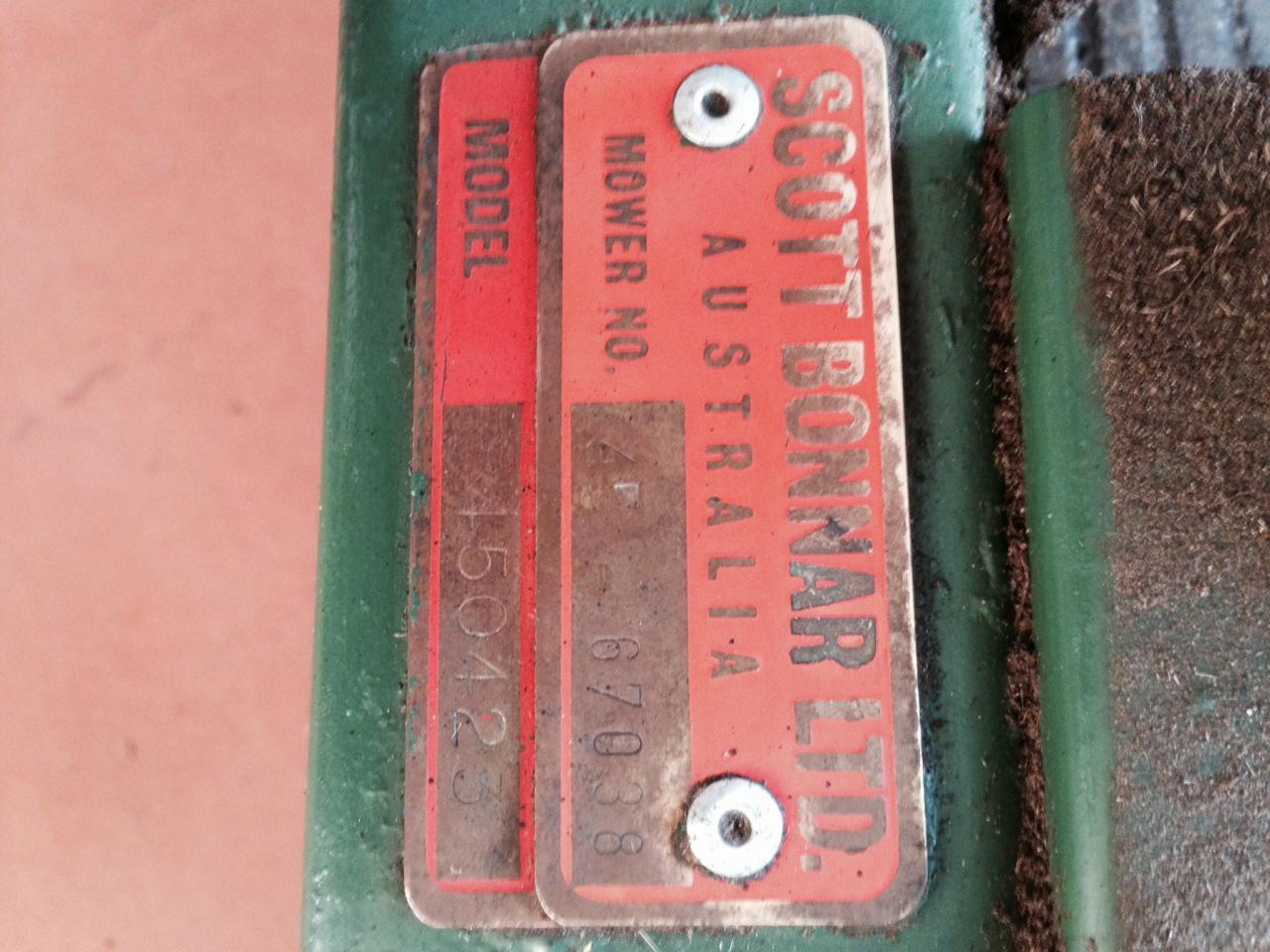

Hi boeing, Your machine would perhaps be an early Series 2 (twin rail engine deck) with the 2 brass ID Plates. As you may know dating a Scott Bonnar exactly is nigh on impossible, but we can give an approximate with the date of manufacture of the Briggs engine (if it is the original engine) wink
Could you please post the whole string of numbers stamped into the metal air cowling...These are the Model, Type and Code....See the pic here: [Linked Image]

For the front roller tube, a new one can be fabricated from a piece of suitable metal tube. Try an exhaust fitting retailer, they may have a scrap piece to suit...Just take the plastic roller ends with you to check for size. wink

Ok numbers are as follows
81232 0209-01 81090903

I think this is a replacement engine by the look of the numbers. Thanks for the advice on the adjuster screw, this was easily fixed.

Well that is most definitely a replacement engine as the twin Brass plated chassis units all had Kirby engines fitted. The Briggs engines didn't come on line for the 17 and 20 inch models until the Red and Silver Ally plated machines were released.
