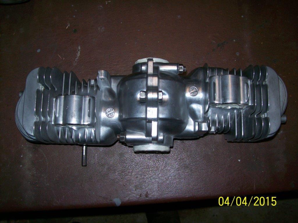

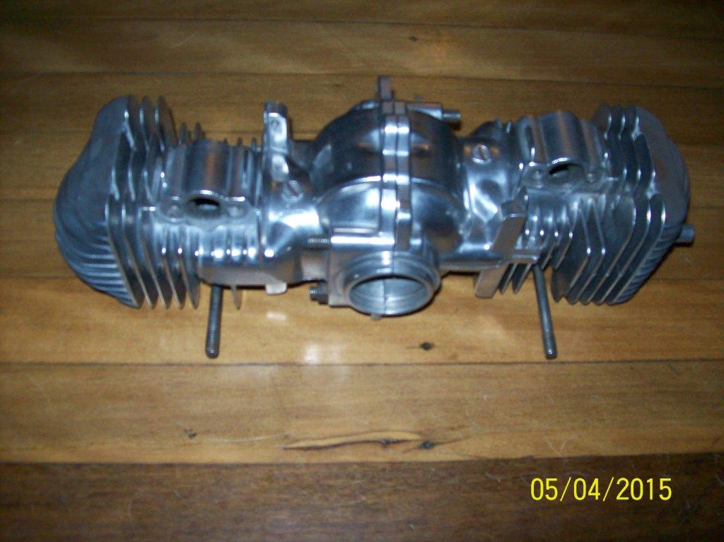

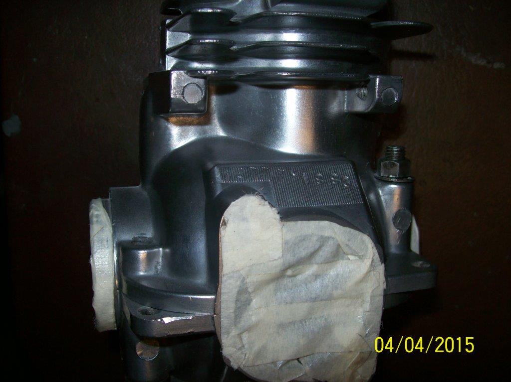

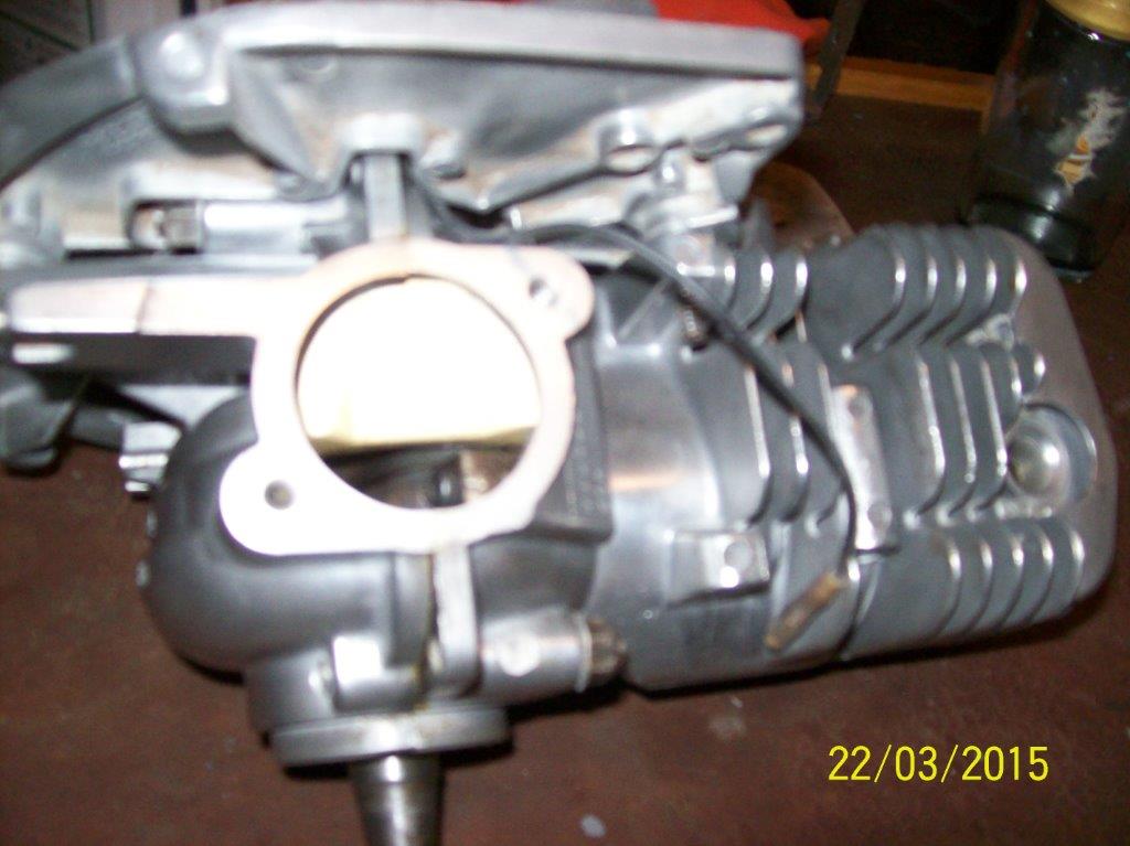

Wow I did it again I have spent the whole day polishing the second twin engine.
As I may not have mentioned before I do believe there were two different models of the 500 Twin and I'm restoring both at the same time.
Here's some pictures of the second engine.
This time I kept an eye on the time.It took me almost 12 hours to just polish this engine.
It would have been very close to the same amount of time for the first one.
So I guess there is almost 24 hours spent just polishing the two twin engines.
The hardest part to polish is the heads.Just very fiddly and hard part to polish,but it's done now.Until I decide to do the green supreme and the gold twin.Thankfully I have a few ahead of those two first.I just don't think I could do that again right now.

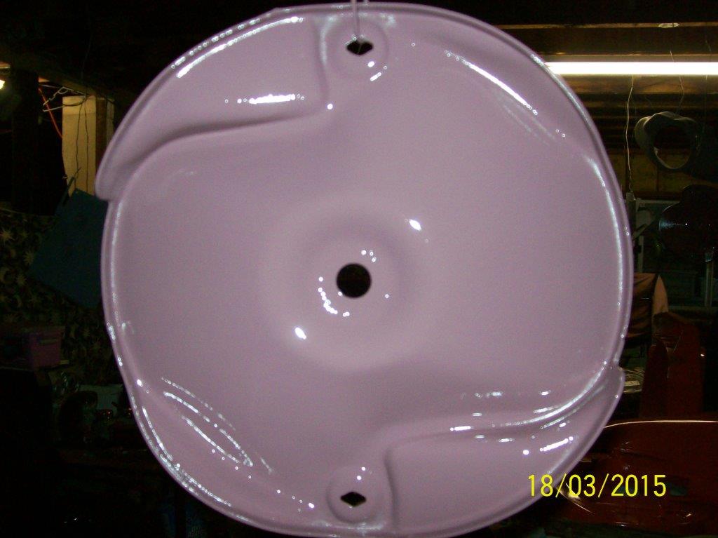

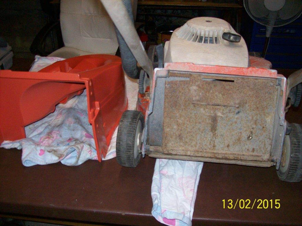

Here's some pictures of one of the rear flaps after the electrolysis and before spraying some primer over it.
Very nice clean and rust free.After those pictures were taken I ran a wire wheel over it and then hit it with the primer.
Of which it then looked like this.Then the primer.
And here the old meets the new.
The old doesn't look very happy at all.

The colour was just a high gloss enamel.These mowers weren't done in hammertone as others around this era were.I have noticed since working with the Twins the casting of the bases were very poor in quality.I don't if it was the quality of the alloy or bad moulds but not the normal quality for a Victa base.

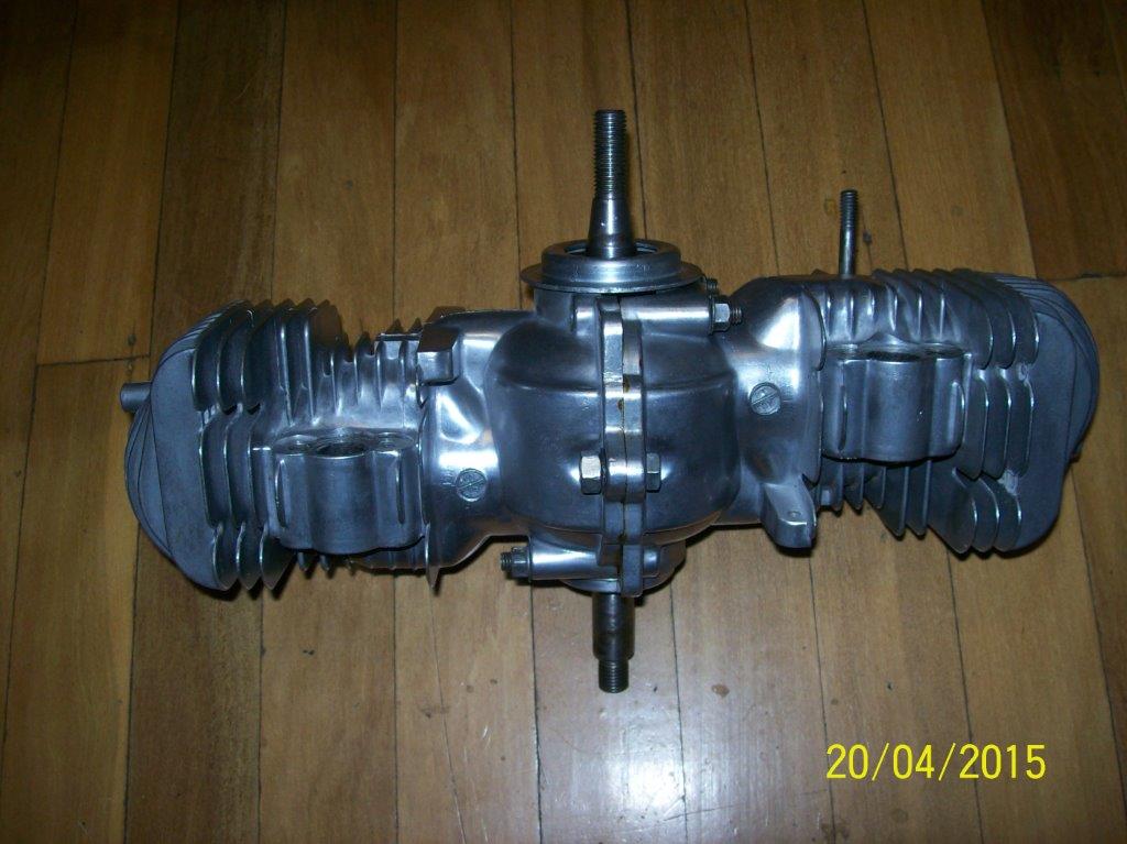

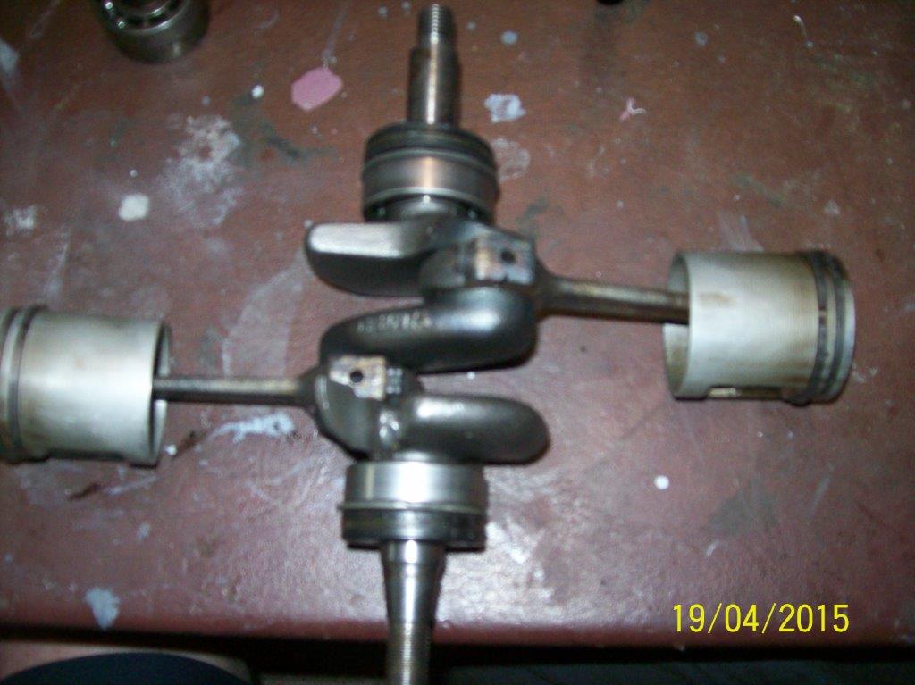

Didn't do much on the weekend,but I did get to put what I call the series II engine together.
First the crank and pistons all cleaned and almost ready.
Bearings and seals put on ready to go.
OK lets put it together.
Taarr dumm.
Done all together.
Not the best photos but you get the idea.

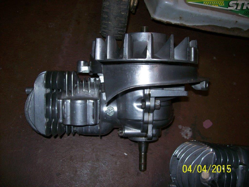

Also speaking of engines.
I won an eBay auction for a Lightweight/Compact engine (Which I think was a Lightweight engine) and was hoping that I could save my Compact engine as I had to steel another engine from a spare Lightweight I have.
So I thought you little ripper solved my problems.
The more I pulled it apart the more excited I got.
...Until I pulled the piston out,my happiness turned to sadness real quick.
As when I pulled the piston out I found the rings fused to the piston and massive groves in the bore.
Bugger that's another loss.
As I found out from the engine number it would have been a lightweight engine as the number started with 409.
A compact engine (from my own observation) should start with 277 or 278 (depending on year made) then two letters
and then two more numbers. If anybody has one there not needing I'd be happy to hear from them.
I did get some good spare parts but I was really after the engines crankcase not spare parts.
