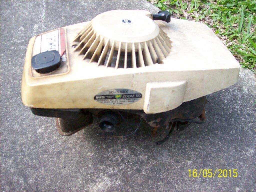

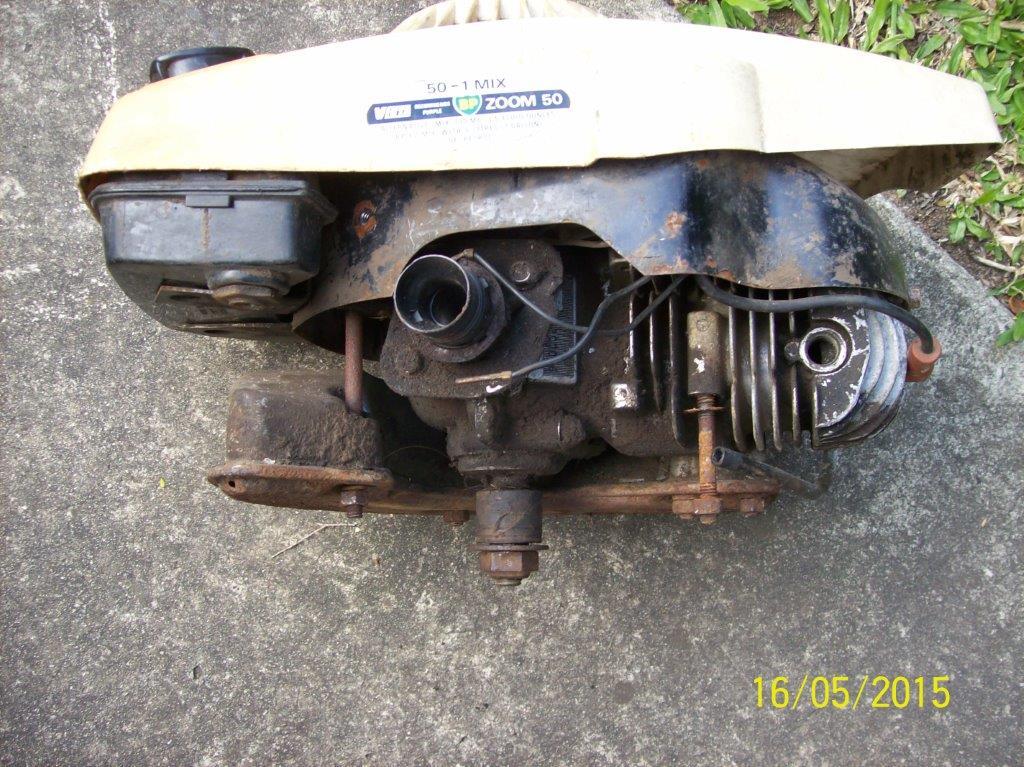

Also speaking of engines.
I won an eBay auction for a Lightweight/Compact engine (Which I think was a Lightweight engine) and was hoping that I could save my Compact engine as I had to steel another engine from a spare Lightweight I have.
So I thought you little ripper solved my problems.
The more I pulled it apart the more excited I got.
...Until I pulled the piston out,my happiness turned to sadness real quick.
As when I pulled the piston out I found the rings fused to the piston and massive groves in the bore.
Bugger that's another loss.
As I found out from the engine number it would have been a lightweight engine as the number started with 409.
A compact engine (from my own observation) should start with 277 or 278 (depending on year made) then two letters
and then two more numbers. If anybody has one there not needing I'd be happy to hear from them.
I did get some good spare parts but I was really after the engines crankcase not spare parts.
