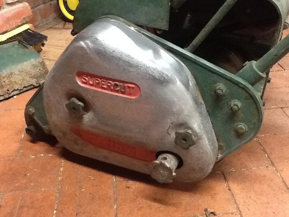

I don't want to appear a Show-off, but it looks like the Attachment hooks on my Supercut are made of BRONZE !
I guess Gold would have been too heavy
Hello RayRay
That's interesting.
Because Scott Bonnar were also low pressure brassware manufacturers,
they had available to them the capability of using these metals.
Yes, gold would be too heavy smile
Although Mick Bonnar did have shares in a gold mine...
All very metallurgical.
