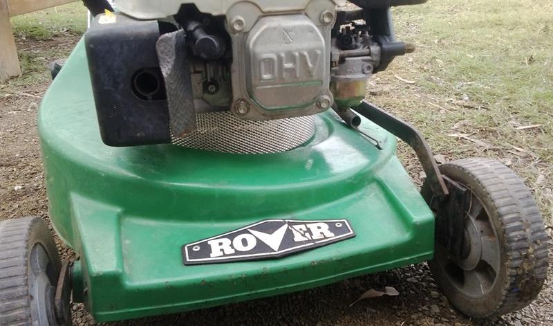

G'day Jaffa & Pete, other members,
I here what you are saying about the cheaper bases with wobbly wheels and everything snapped off and even cheaper catchers on the newer wave of imports.
I think the engines are great, smooth running, quiet, easy to start, lower emissions.
I had a mower called an Icon with a trashed base, drained water from the fuel bowl and the engine ran nicely.
Decided to put the engine on a Rover base.
With the engine mounted up, the blades were 10mm below the bottom lip of the base.
I used the 20mm Victa spacers, used to lift 4 stroke engines(you may have seen them clipped into a plastic ring).
I cut them in half.
I needed a longer mounting bolt and the mounting bolts from a Victa power torque where 12mm longer with the same thread.
I am not too sure about the end result, but I will test it out around here to see how it goes.

Hi Mark,
That gap in your 3rd photo is what I was referring to. Be careful as that large a gap could see stones etc flying out and up at a dangerous rate. Other than that the fitment looks good and well done. Perhaps get some steel mesh, cut it into a circle and fit it underneath the deck. (I'll try get a photo of the plate I mentioned in my earlier post) to stop stones etc flying up.
As I have lost an eye through injury myself I can tell you it's not pleasant and all care should be taken to avoid projectiles.
Pete.

Posts: 510
Yes, I agree.
I can try some mesh.
If I am not happy, I will try a different type of base.
Thanks for that.
I am interested in any other options that are safer.
Joined: Feb 2011
Posts: 510
Here is the mesh I put on.
Next time I try this I will make up a plate that sits under the engine.

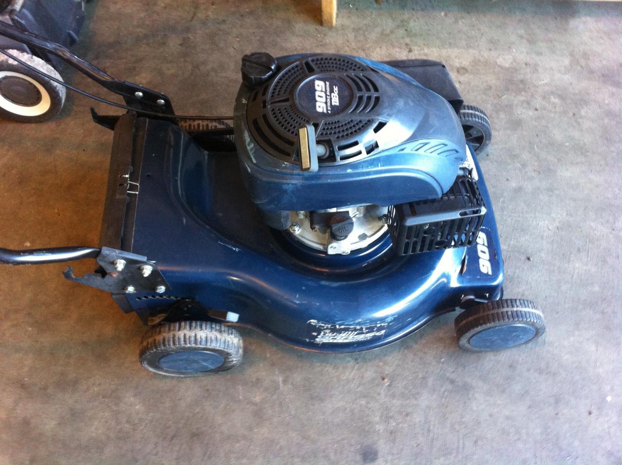

Posts: 445
Here is an example of another pretty sweet Chonda I picked up but yet again no catcher. My understanding is this base is exactly the same as the GMC's so I have been looking for a catcher but no luck.
The mower runs really well, I just hope it can go to a new home to use as a mulcher I guess.
If anyone has some good suggestions about what to do with this apart from sell it without a catcher that would be great!
