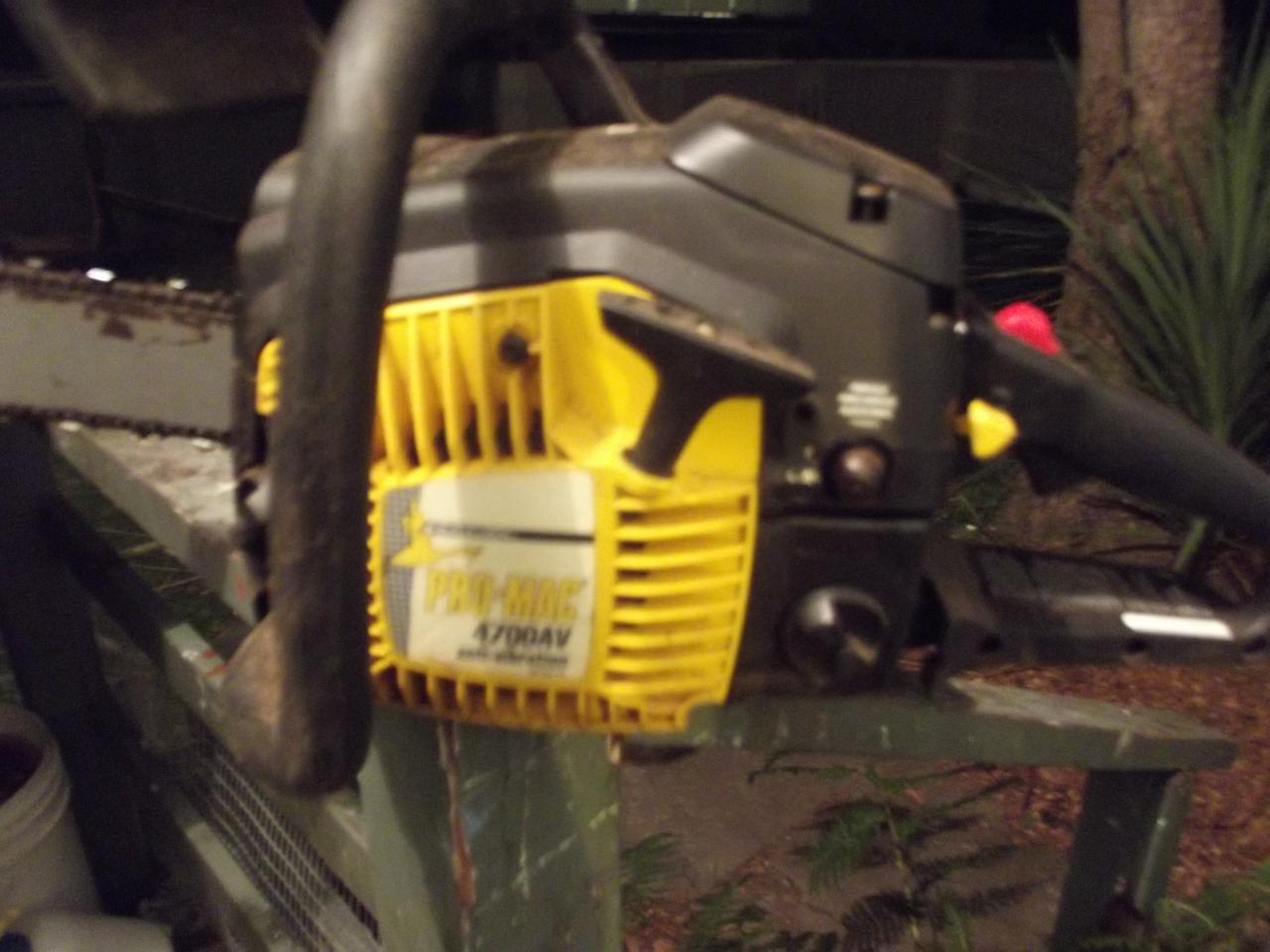

Bloody thing, it has spark compression, heaps, aerostart, nothing?????

Can't see your picture. If all those other things are okay my guess is crankcase seals.

Check the spark arrestor isn't blocked, if it has one.

Also, try a bit of aerostart in the plug hole and, replace plug and see if it fires.

tried that nothing not even a cough. i did get it for nothing

Take the flywheel off and check the locating key. It might have sheared off which will change the timing

Seanw, have you inspected the spark arrestor in the exhaust is fully clean and not blocked as bigted has asked as I have had a similar problem in the past and was as simple as cleaning the spark arrestor and a new air filter.
