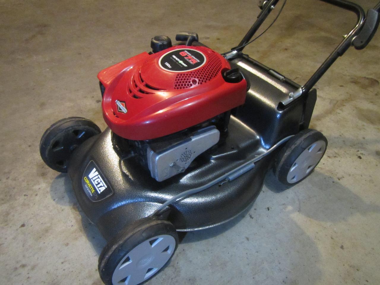

I recently picked up a 675 Series Briggs No Prime No Choke Mower which is in near brand new condition. It was very cheap on our local classifieds site so I really couldn�t refuse and see what was going on with it.
I bought it home and it didn�t start after 3 pulls. On the fourth pull it finally started.
I decided to strip the engine and give it a good service. I put the engine back together after giving the carb a good clean and giving it a new air filter and it now starts first pull and runs very nicely. I am little concerned it is running a little quick but before I pass judgement I want to give it a run out of the shed to see how it sounds.

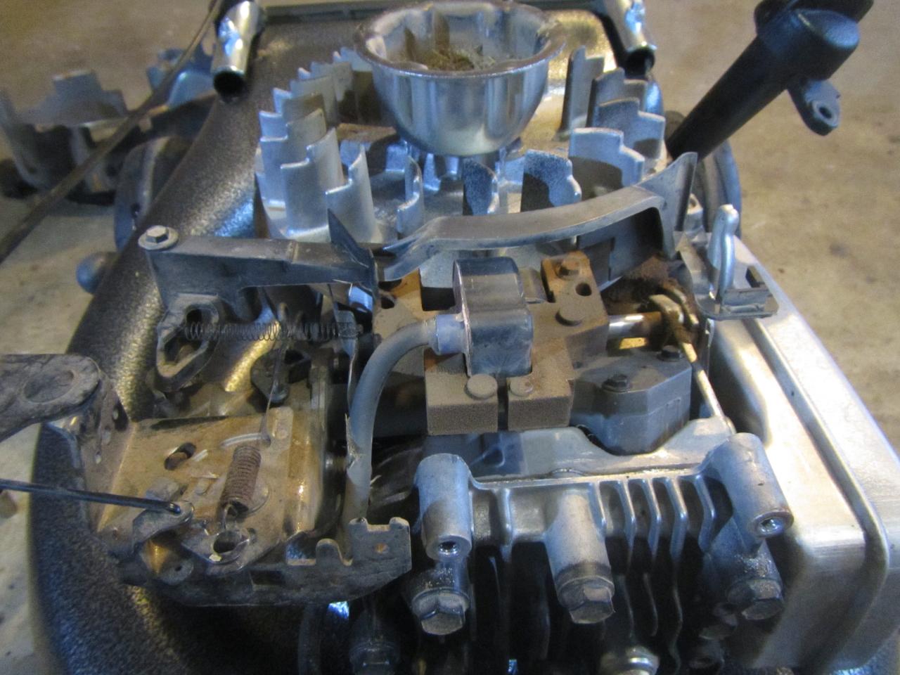

I would like to understand a little more about how the No Prime No Choke system works. It doesn�t seem that complicated but I wanted to be sure about the mechanics of the system.
Any pointers I need to take into consideration compared to the standard briggs systems would be greatly appreciated.

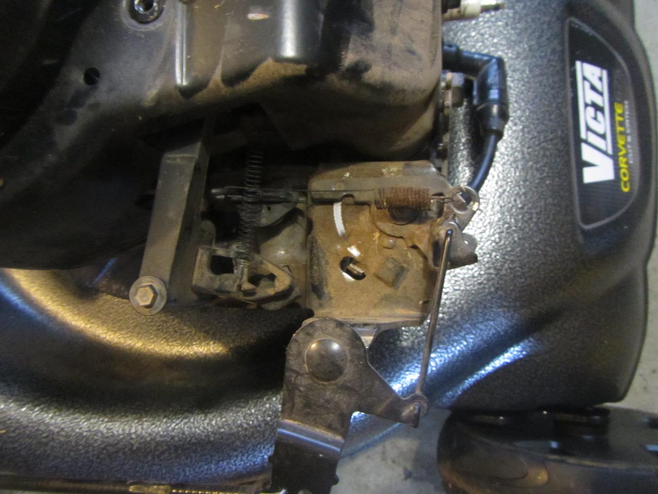

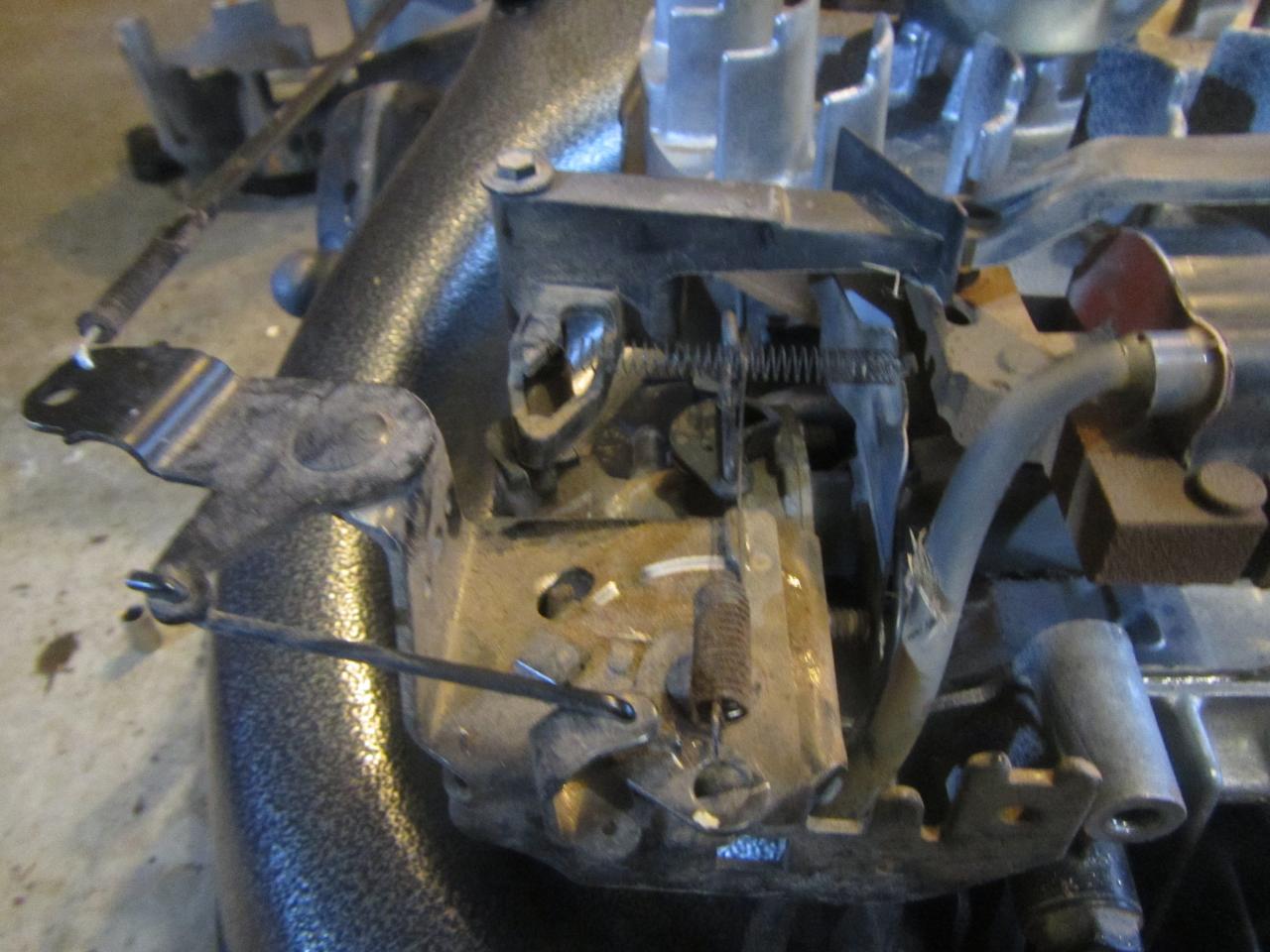

Hi Pete, i've only seen a couple of these myself but the setup is pretty straight forward. When it's in cold start mode the system self chokes and once the engine fires up the air pushes the air vane and disengages the choke. When it's in "hot start" mode there's a thermal coiled sprind insibe the inlet end of the exhaust that once heated pushes the lever on the exhaust side of the engine and disengages the choke thus starting without choke.
Did you get all that....good, now explain it back to me..lol
As for full throttle RPM the tab holding the spring does look like it's pulled forward a little too far and would probably be over-revving. You're aiming at about 2800rpm with these motors.

I gave it a good test today and adjusted the revs and its running very nicely. It just needed a slight adjustment like you mentioned.
