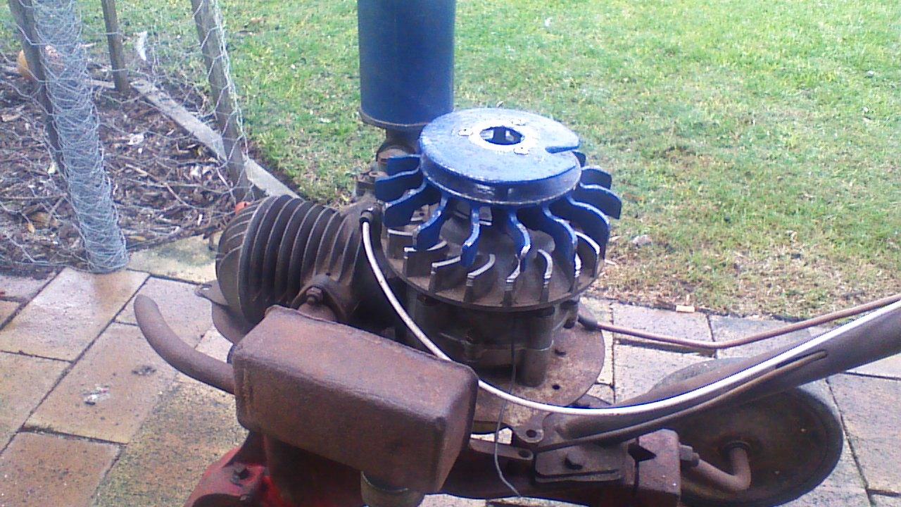

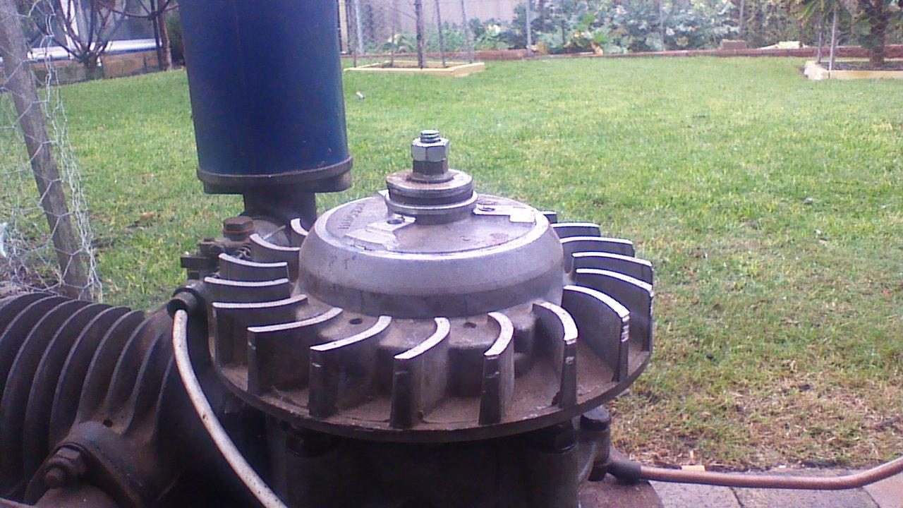

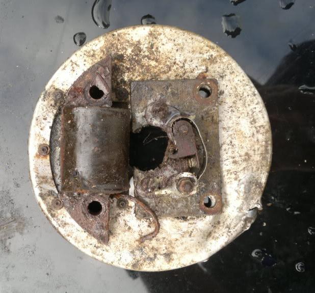

After testing the coil and finding it was suspect I decided to modify the ignition by fitting a Victa ignition as cost of getting unknown condition ones from England was rather steep. Milled a sleeve to fit Victa flywheel and made a base plate to carry coil and points, needed to mill a key into Bux crank but found the metal was so hard the milling machine would not touch it (broke two bits) and the intention of taping the crank to hold the flywheel also was not an option so welded a bolt on for this purpose then cut the key into the crank with a dremil and cutting disk. Position of key was determined by removing head and setting 3ml before t.d.c as points opened just as the originals did. A wider key was then made and the sleeve cut for the key. The Victa flywheel was then modified to fit the original pull start.
With heart in mouth the big test, yes it had spark fuel was added and with two pulls there was life. A bit of tinkering with the carb and the motor is running very nicely.
Photos of conversion attached.
If it don't go its not good.
Joined: Mar 2015
Posts: 86
I forgot to add the Vista condenser would not fit and the one in the photo only produced a weak spark so the Victa one was added under the base plate and the kill wire is the loose wire just behind the muffler. We will find a spot for a kill switch after a full paint job.

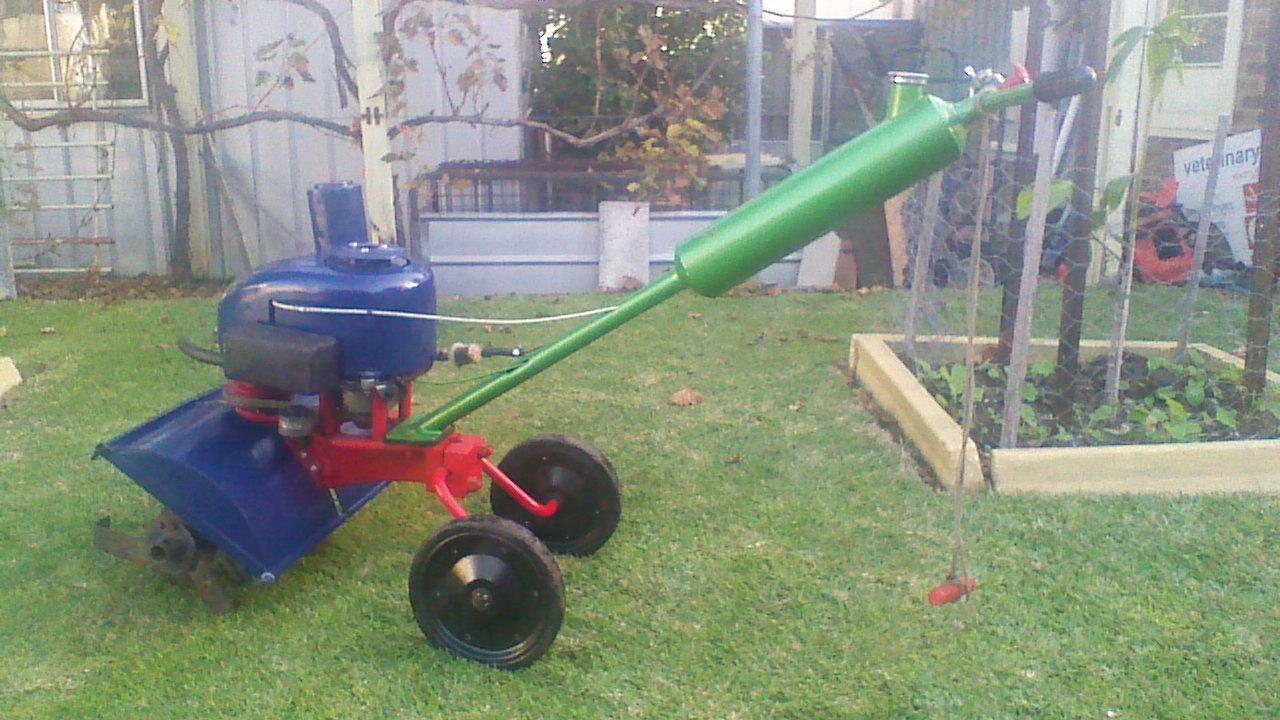

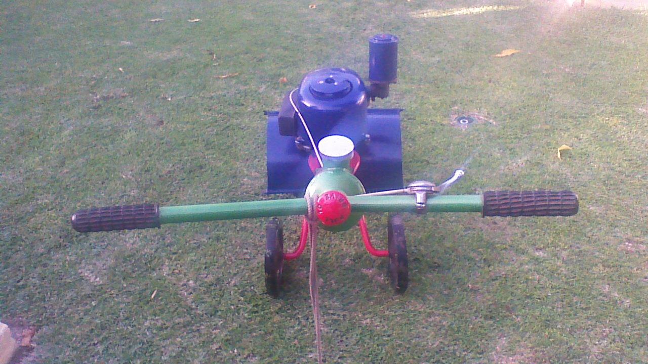

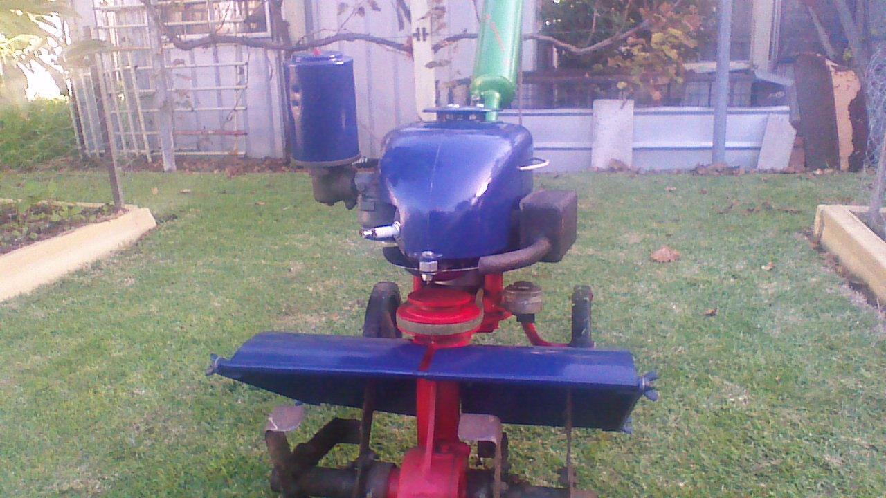

Realised today that I hadn't posted any photos of the finished product. The only giveway as to the magneto conversion is that the cover is lifted to clear the conversion flywheel.
It is a horrible machine to use - too heavy with all that cast iron in the base and small narrow wheels. I can see why they weren't sold in Australia as no self respecting Aussie would have used one. My old Landmaster Rotary Hoe is ten times better to use.
Any way hers the pics [Linked Image]
