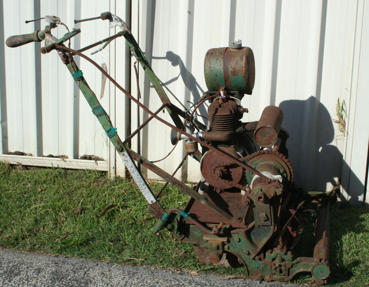

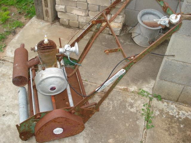

Scott Bonner 16" with Villiers Engine number WLA 53929
Hello Woodsy,
Yep, that's a rare machine.
Based on the Standard Electric frame, the petrol machines are not common at all.
Date of manufacture - late 1920s or early 1930s. This is uncertain.
I personally favour the early 1930s - because Scott Bonnar were selling imported
petrol mowers (Atco) in the late 1920s - from middle of 1928 to 1931. At one point,
they were the sole Atco Agent for SA.
Scott Bonnar were committed to selling their electric machines.
The petrol Standards were not promoted - perhaps because the procuring of suitable
petrol engines was a real problem.
Historically, an important find.
JACK.

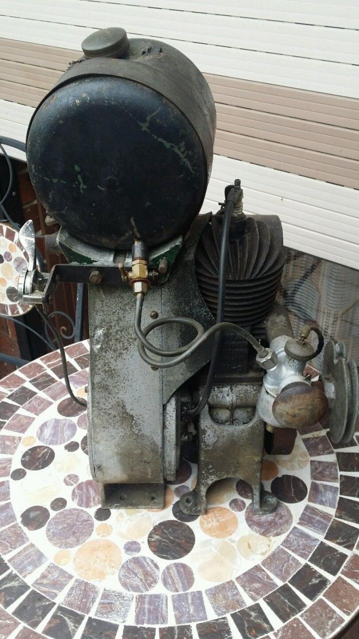

I have managed to obtain this interesting little Villiers engine. It is a Villiers Mk XI-C that has the serial number WLA 53824. Consequently, it can be confirmed that the so-called WLA engine is a Mk XI-C (147cc). Given the shape of the petrol tank and the cowl I am certain that this engine would have originally been attached to a Scott Bonnar mower, probably a Standard.
Sir Chook

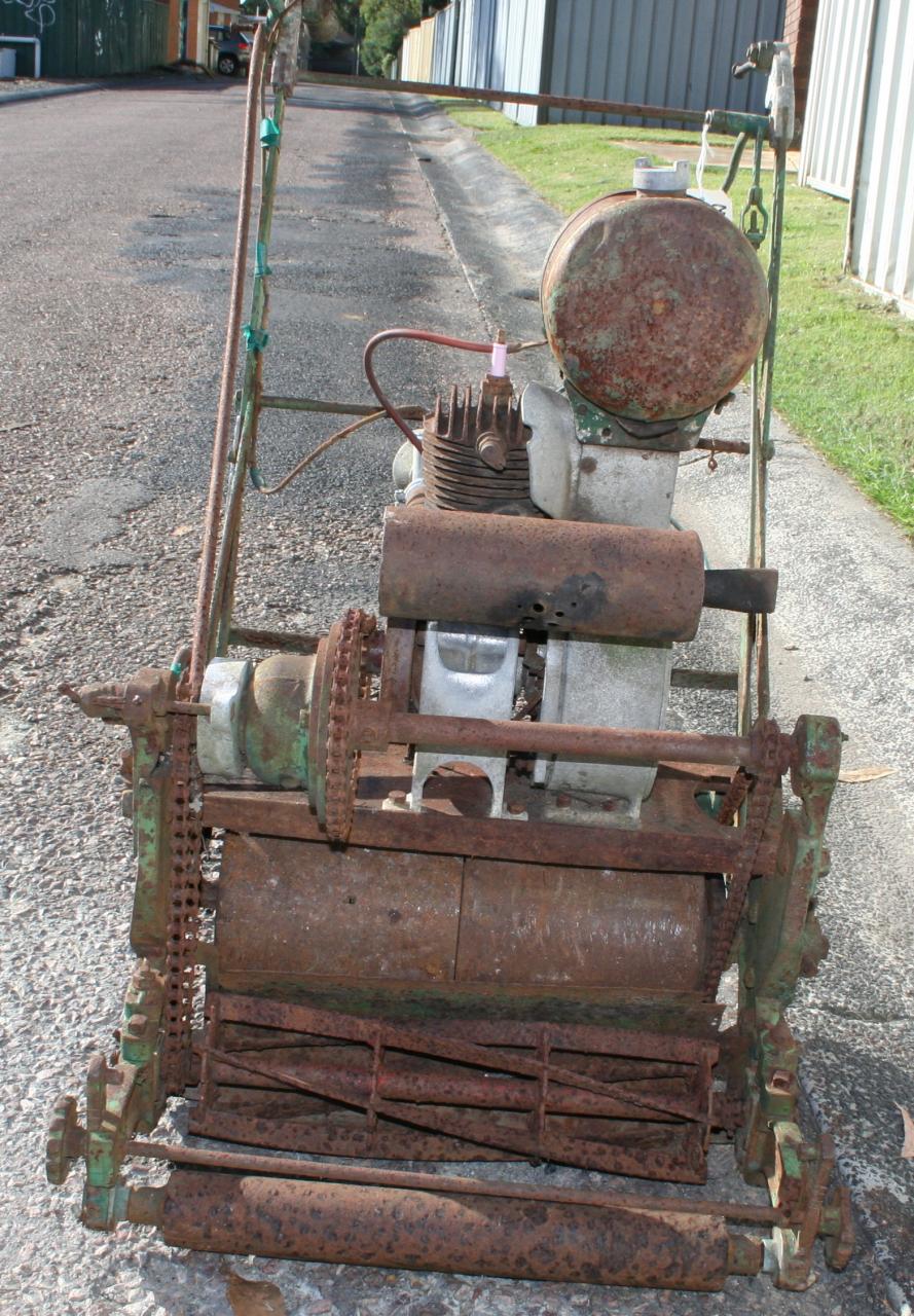

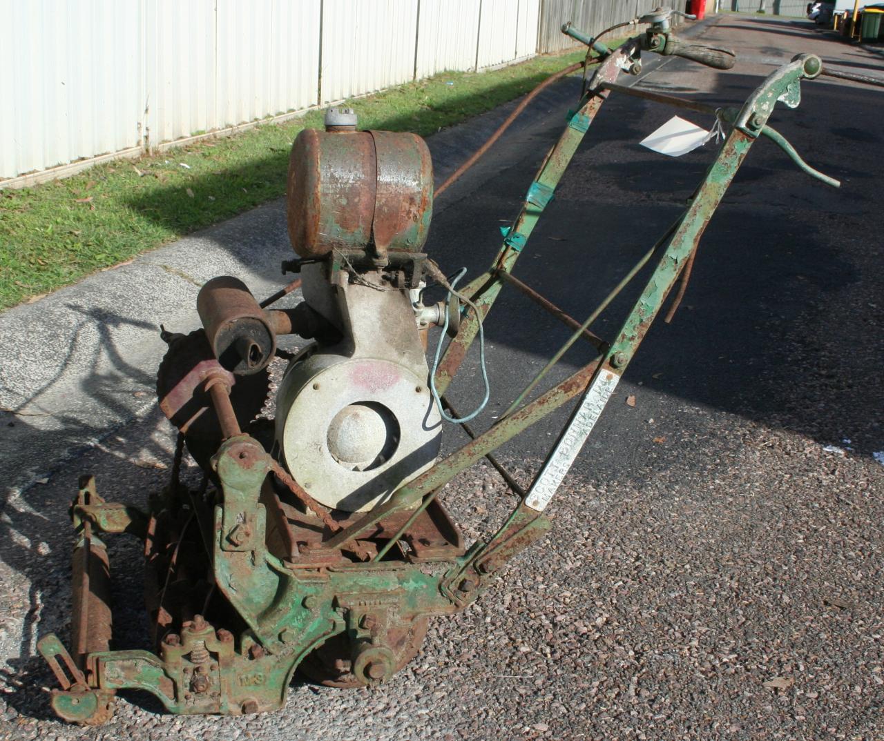

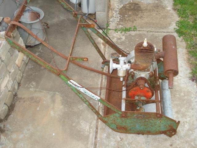

The engine that I have shown a photo of and the one on Woodsy's mower are both XI-C engines and from what I can see in the Scott Bonnar factory picture, this engine also appears to be the same (albeit with some minor differences).
Pre-war Villiers engines generally had a Mark (series) number identified by Roman numerals and a letter that identified the nominal engine capacity. The letters that tend to be seen in mower applications are: A (250cc), B (350cc) and C (150cc). It would appear that the letter prefix associated with the serial number (e.g. WLA) identifies particular specifications.
If we look at Scott Bonnar's use of Villiers engines at this time, there appears to be two main specifications - WL and WLA. It is not overly clear as to what the exact differences are. However, a visual comparison indicates that the key difference is the fitment of the fan and shroud. The photos below compare the two - NB both engines are Mk XI-C engines (photos by Woodsy and Stationary).
Villiers WL (No 53376)
Villiers WLA (No 53929)
Sir Chook
