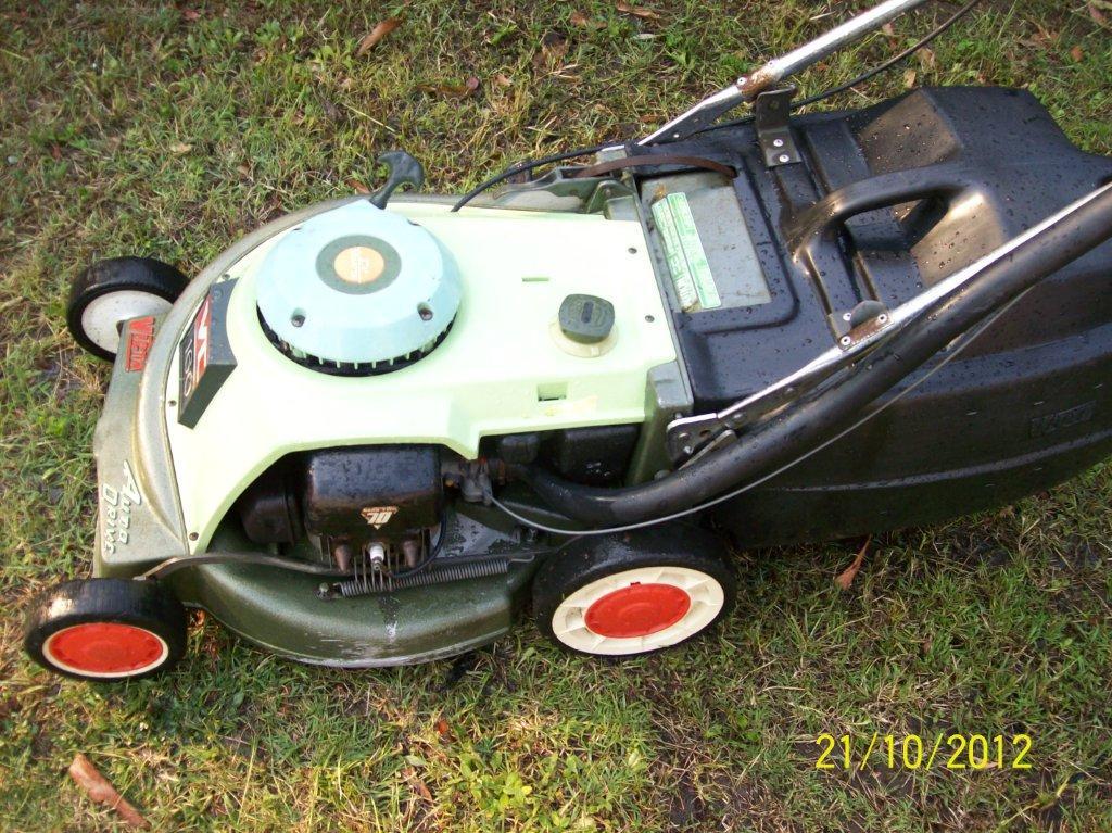

First of all was the VC-160 Auto Drive Mark I from 1971 to 1972 Victacode V109.This auto drive is arguable the most attractive auto drive but also is the hardest to find.I myself waited about 4 years to find one worth spending any money on.
Full crank 160cc and G3 carby with the alloy fuel bowl.
Also came with green auto drive catcher (different from the standard VC catcher) black air cleaner and black throttle controller.
Unfortunately mine didn't come with the original green catcher and the original black throttle control.It was a little more than I wanted to pay but it is in great condition.
Also cover for the diff and belt were green in colour as was the fuel tank.In one of the photos you will see this had a black tank I have since changed it to the green one.

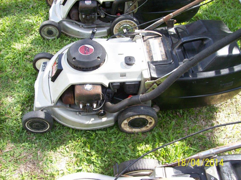

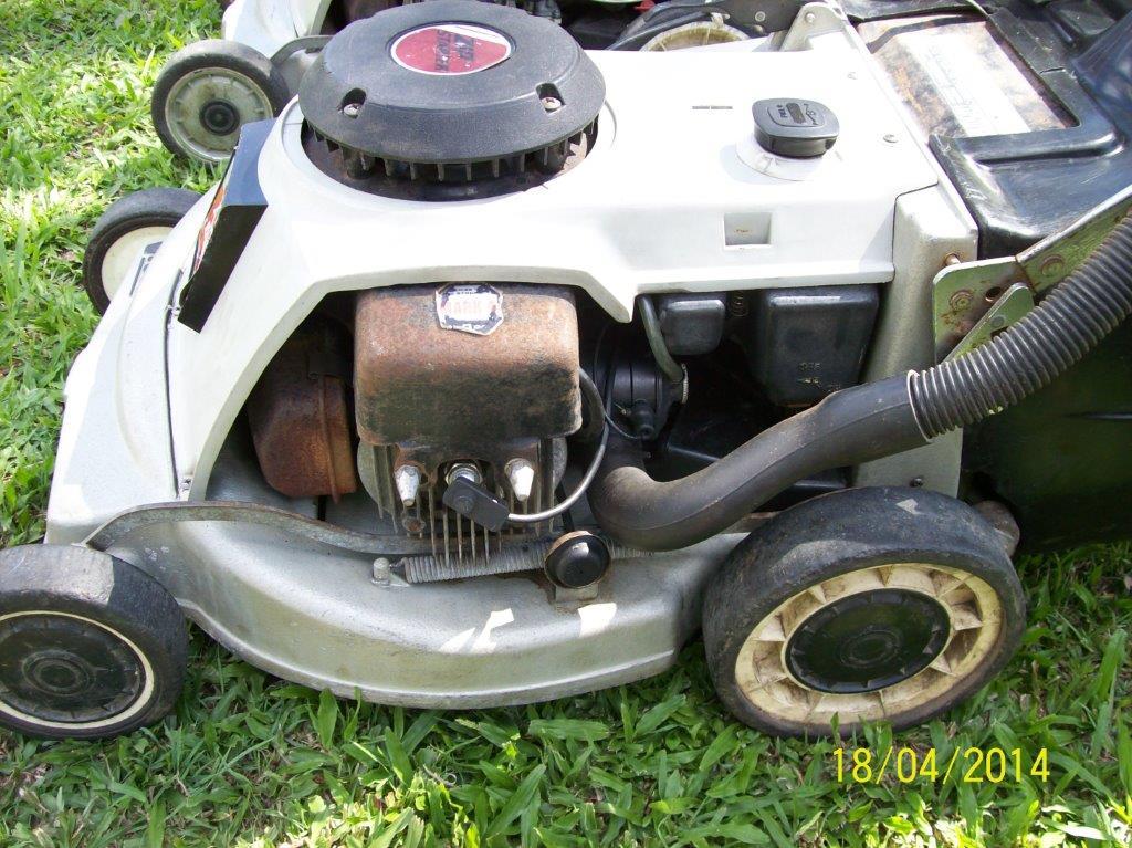

VC-160 Auto Drive Mark III
Built 1974 to 1976 Victacode V169. Full crank 160cc engine with a G4 carby,with remote primer.Black catcher,black diff and belt covers.Fuel tank were also black,black hub caps.
Again easier to find than the first two models,but still not that easy.

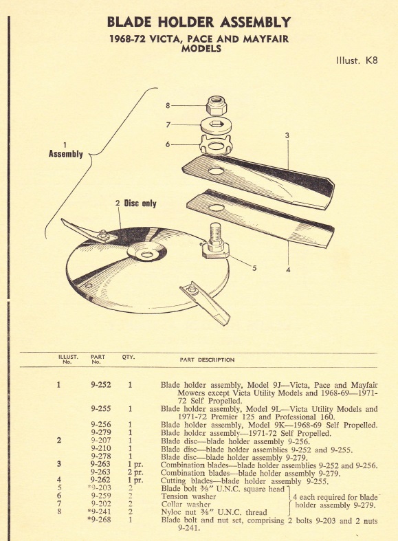

Hi Blumby, nice work on the presentation. I have one question relating to the Mark IV, is that the correct blade carrier or is it just an earlier model one til the right one comes your way?

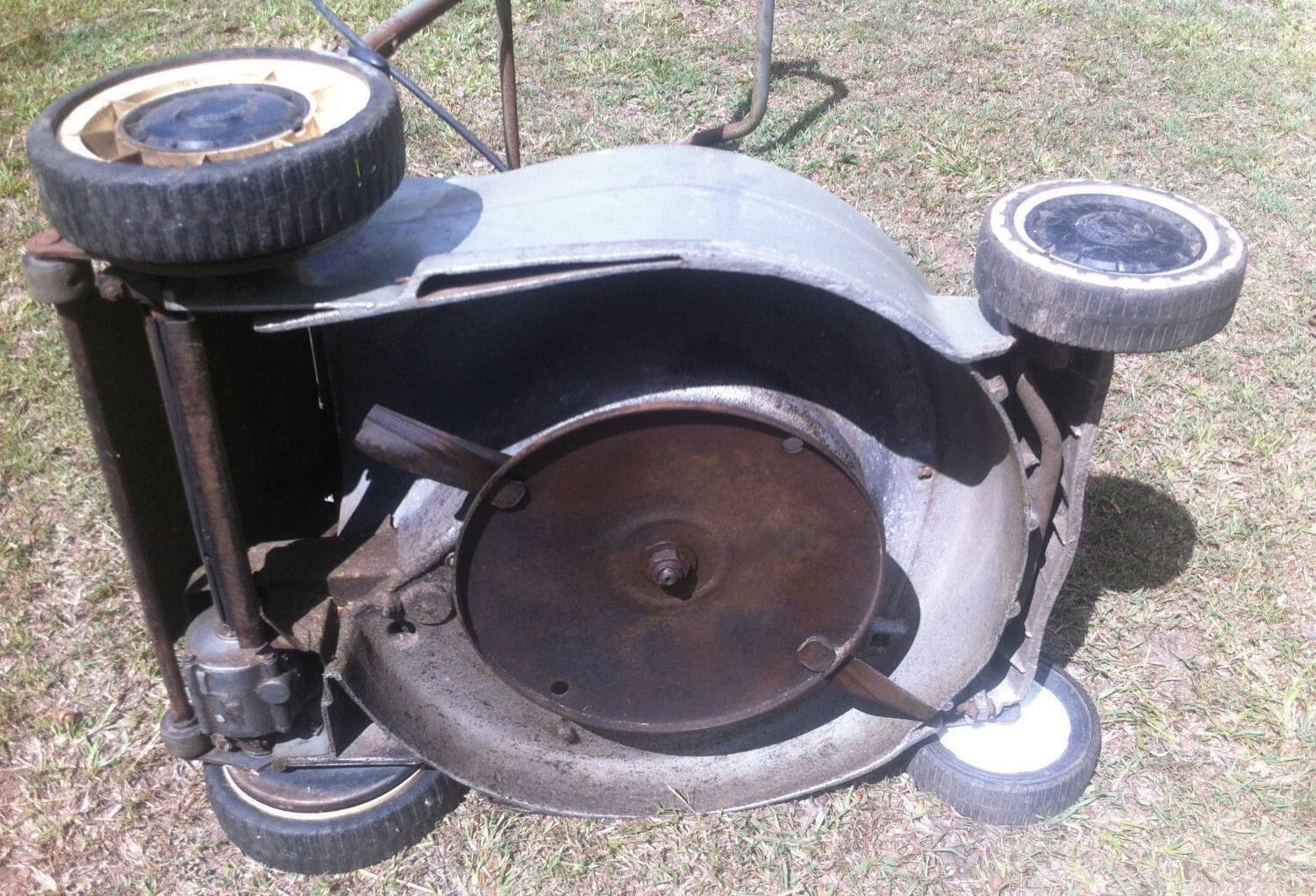

Thanks Bigted much appreciate.Yes that is the correct cutting disc for that model.In fact all the VC-125's,VC-160's and VC-160 Auto Drives used that cutting disc (only small variations.The earlier ones had only two holes for blades not the four holes you see in the picture),but not all in the VC range. VC-Sports ans VC-Mustangs had a different cutting disc.
Also that Mark IV in the last picture I had to wreck it out for parts.The base was absolutely trashed and I felt it wasn't safe any more.Didn't help that someone tried to weld it,but just made it a lot worse.
I noticed the same thing also guys. It looked to me much older than id expected, and also appears upside down. I dont recall seeing a plate with the lip exposed to the ground. In any case, you've confirmed its correct for the Auto, and that's good enough for me smile

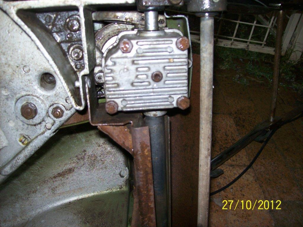

Here is some pictures of the different diff's for the auto drives.
Why they changed I have no idea,could be a better design or a different supplier I don't know.However the the later model one was the same as the power-plus had.
Mark I,II & III
Mark IV only
Mark I,II & III
Mark IV only

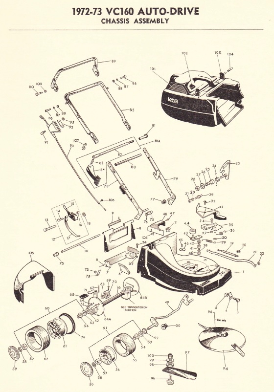

Just a few things to show you all that they are the correct blade discs.As well as the part numbers to match.
