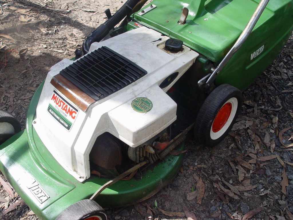

I picked up an old VICTA 2 stroke series 80 Mustang that, unfortunately, needs a little more tlc than I thought. At this stage I have little to no experience with mechanical work, but am planning to do as must as I can on my own to cut costs & learn etc.. however, am having some hiccups I'm hoping to get some feedback/suggestions,

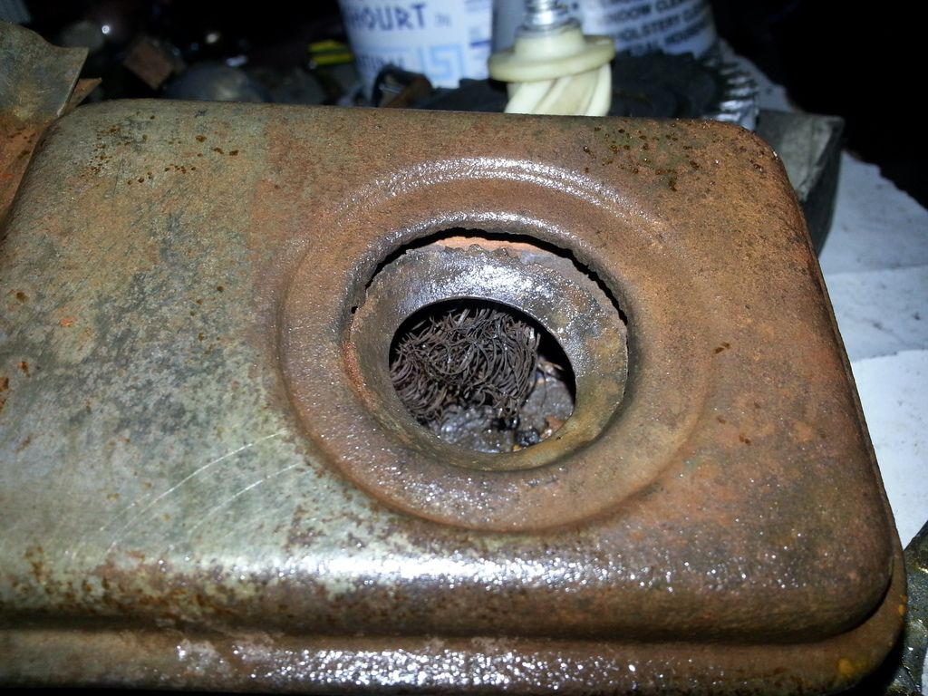

[Linked Image from i998.photobucket.com]
while cleaning the muffler, I noticed it's actually split at the opening. I don't really have access to a welder, but do you guys think this is repairable? (solder maybe?) or should I just hunt for a replacement?

Muffler are something tends to rust from the inside out so a replacement would be better.

A replacement muffler in better condition is the most practical solution for the fairly huge crack you have there. If it were a vintage car part, and therefore irreplaceable, I'd oxy-weld it to form a bead of steel weld rod right around that flange at the corner that has cracked, building up the thickness to about 3 mm in the process. There doesn't seem much chance of MIG welding it, since there isn't much metal left, and what there is has been damaged by metal fatigue.
