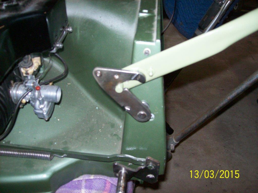

Also, the front to rear axle linking bar (that passes between the cylinder and the baseplate) I've never observed this as being painted before, was that original? Is it model specific?
Sorry Ty I forgot to answer this the other day. Yes the height adjuster linkage were painted as far as I know only on the VC-125's. Also the handle lock parts on the base were also painted the same colour,and yes they were originally painted that way. On the 125's these parts were not zinc coated,unlike the 160's which were zinc coated.
There you go, it certainly makes sense, Zinc plating cost more, and at the time Victa wanted to offer a cheaper mower, without taking away from the main design features of the VC-160, such as the catcher size, decompression based Zip start system, G3 carby, dual fold handles and hi-arch chute.
Wow, only a small detail, but very important, and when it comes to VC's, I do love to learn new things!!

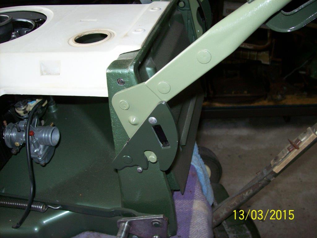

Well that's where my job as a restorer gets harder in keeping the attention to detail.Like look at the latch assembly,spring clip latch and the rivet. I've kept them all the original colours.That wasn't the easiest to do,but I did it.

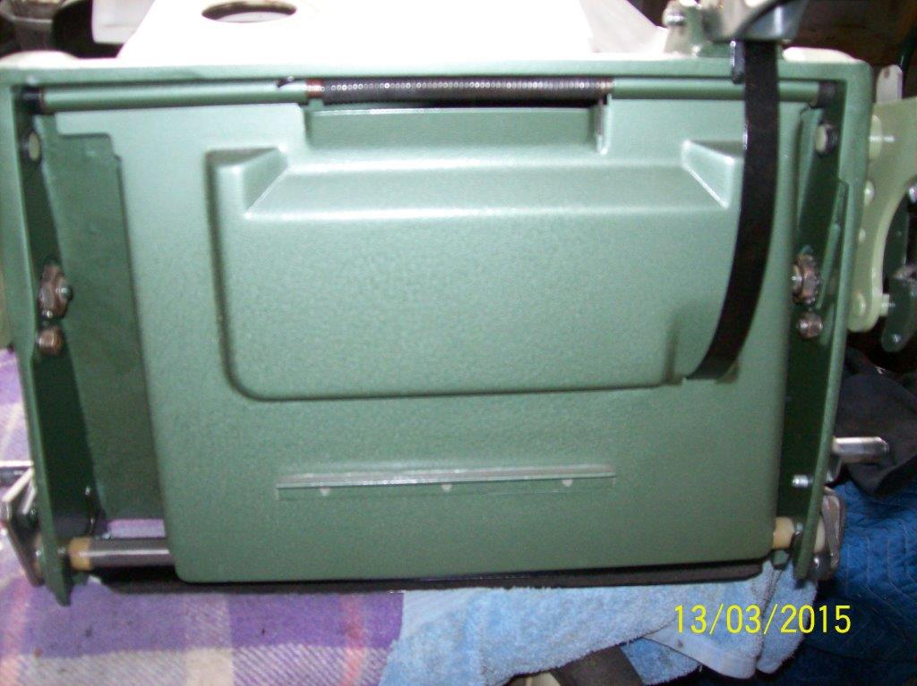

One of which the casting on the Mark II is a lot better than on the Mark I.Like around the the Victa logo on the Mark II there are no cast lines also around the handle for the rear flap as well as a few other places(more listed below).The Mark I's had these cast marks.Also I'm not sure if this is how they were,but from my observation the Mark I's had a (I) cast into the base where the engine mounts.Marked below in red.Where as the Mark II's (From what I have seen so far) had a (2 or 3) cast into them.
The blue lines are the cast marks I was talking about.
The only other change is the Mark II had extra holes put into the side for the new style height adjuster which was the plastic type.
Mark I
Mark II
Other than that there really isn't anything else I can see or have found that is different.

Catcher Flaps
Mark I
Mark II

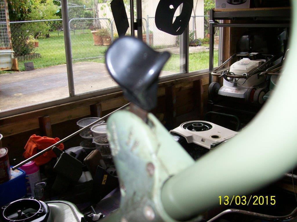

Thottle control
Mark I
Mark II

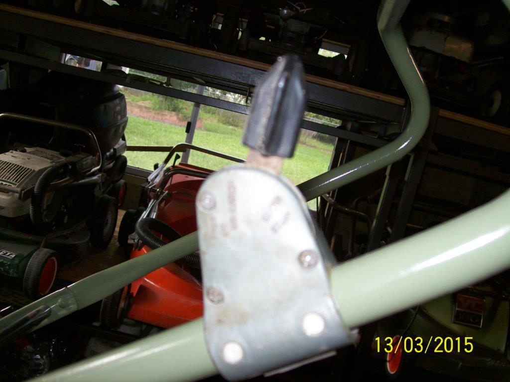

Bottom part of handles to base.
Mark I
Mark II

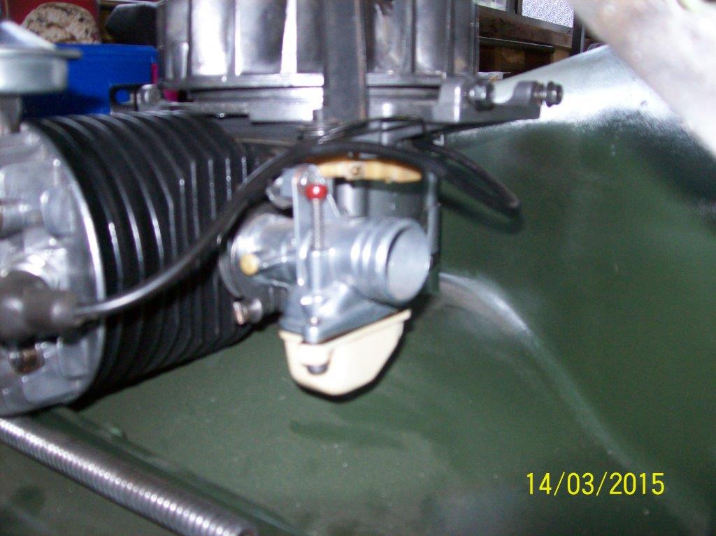

The only other different's which I don't have a picture of is the Mark II had the plastic fuel bowl.You will see in my photos my mark II has the metal bowl I just haven't put it back on yet.

Any idea why the re-design on the handle hinges and locks?
The first design looks difficult to release...
Thanks.
I'm not sure why the change in the handle locking system.It did change from 1972-73 and they seem to keep it that way right up until the bases were changed,when they started using the power-torque engines.Although the VC-Auto Drives kept the same set up.It just may have been Victa changed the supplier or the design.I guess the Auto drives just had enough handles to see that model out.

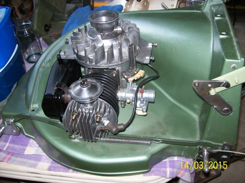

Yes now I have most of the parts I need it's now just getting the time to do it all.

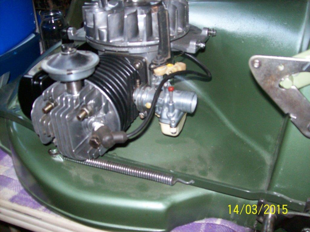

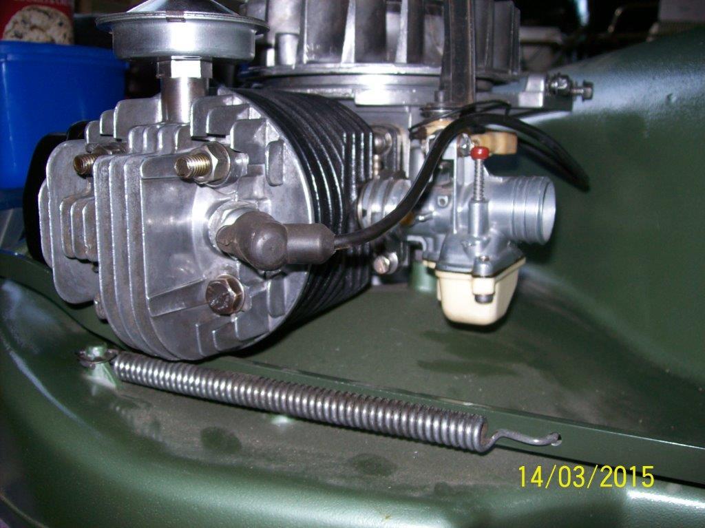

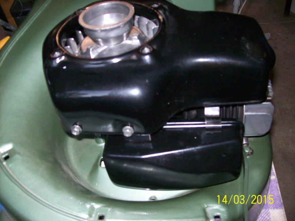

In-fact here some progress photos of the Mark II after putting it's engine together yesterday.
I think I really need to clean the dust off before the next photos.
The Mark II had the plastic fuel bowl on it.I prefer the alloy one but it's not how it was new.
Unfortunately I didn't get time on it today so that's how it is for this week at least.
I'll keep adding as I go.

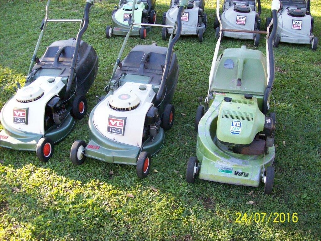

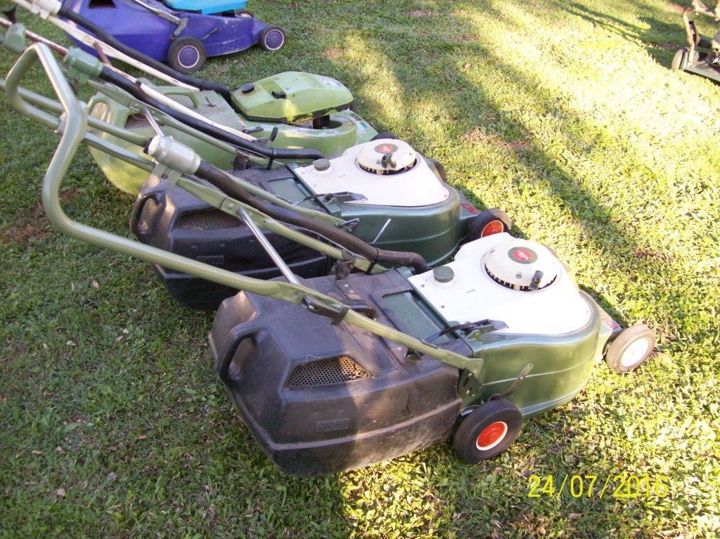

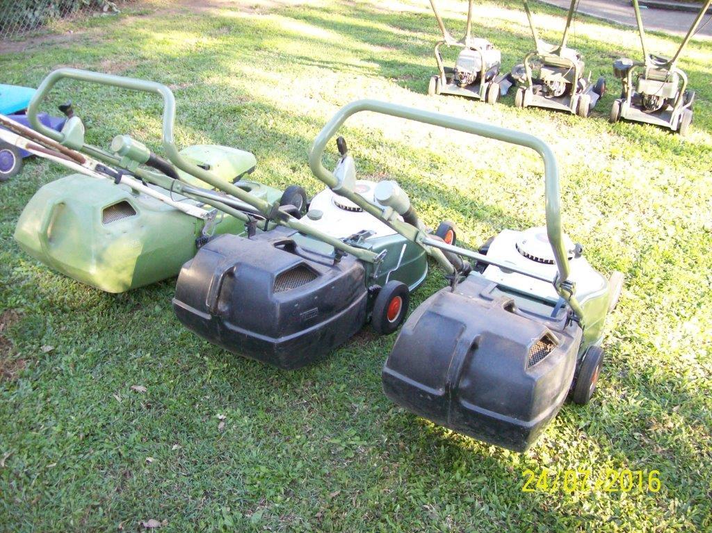

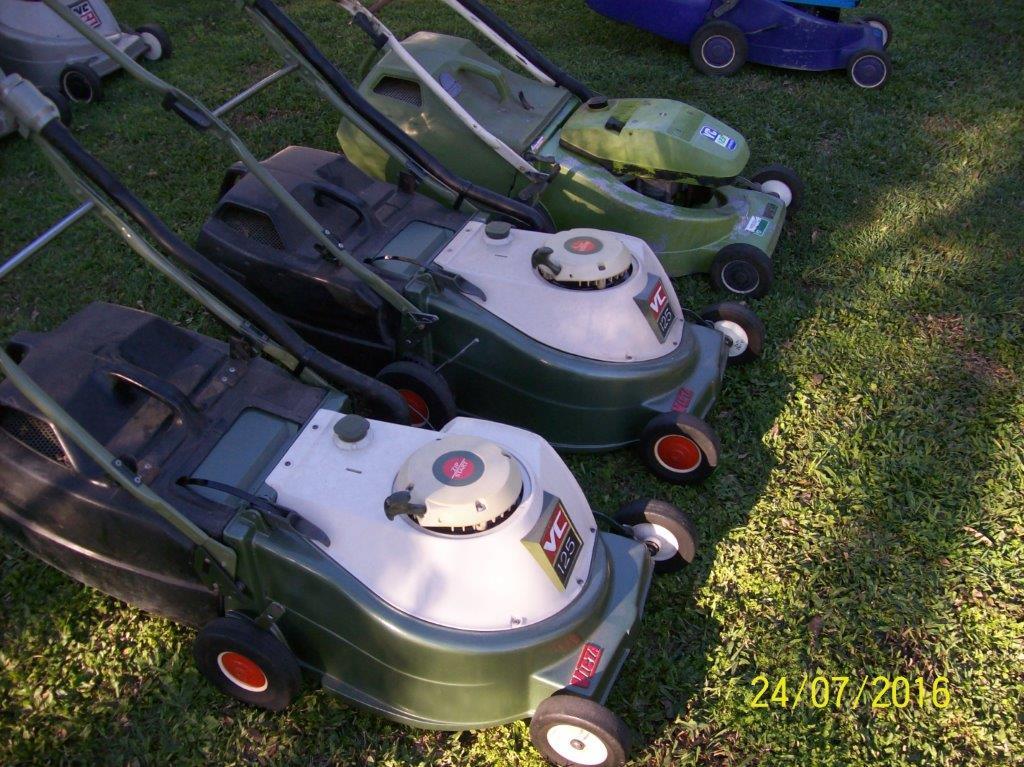

OK guys my VC-125 Mark I & Mark II restoration are just about done.I just have to sauce some better wheels (Of which Bigted has got some for me)(Awesome) clean up there catchers.The hardest part is finding someone to do the decals.I know there are some on eBay which I think for memory is also an ODK member.I purchased two sets,but unfortunately 3 of the original decals where done on a chrome foil back.These ones were done just in silver ink and when compared to the original they really don't look right.The others that were done look absolutely sensational.I'm trying to track down another sauce to get them done,which hasn't proved to be very easy as it requires a special printer to print on the foil backs.
Here's some pictures of how they look now.
So from left to right.
VC-125 Mark I,VC-125 Mark II and VC-125 Mark III.
I know there still not the greatest pictures will get some better ones soon.
