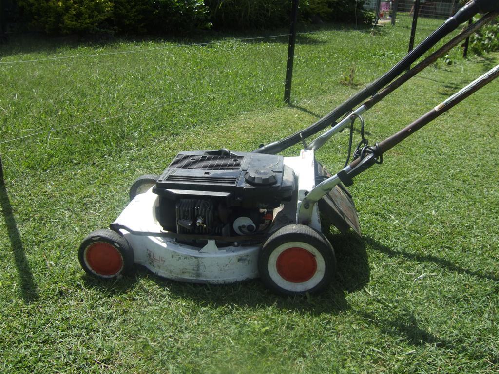

I have an old Victa Power Torque 160cc. It runs well, but it seems to stay at the same revs. sort of 70% throttle. I set the poppet at position A. recently decoked the motor, all seems OK.
There is plenty of power , I recently mowed two heavy lawns 50cm high grass. It cuts so well. The throttle cable moves the gray slide. I just wanted more control over the throttle.
randell
Posts: 956
Hi Randell,
Poppet valve should be set to C unless your mower is a vortex.
When you say 70% do you mean it runs at the same RPM irrespective of throttle position or do you mean when you take it to full throttle it revs up momentarily and then drops back the RPM by itself.
If it does the latter that is normal but a picture of the mower will help as the earlier ones are a little different to the later models.
Posts: 1,233
Likes: 32
Hi bigted,
The mower had one of those rubbber rings underneath around the disk, I took it off as I don't use a catcher. I think it is a vortex.
Yes it runs at 70% irrespective of throttle position.
Here's a pic.
randell [Linked Image]
It has TUR......... on left side, maybe Turbo....
randell
Posts: 956
Yes, it has the turbo disk, hence the rubber ring. Poppet on this model is set to A so all clear there. 70% throttle sounds about right as these are governed to 3000 RPM unlike most others which are about 3300 RPM. There is very little variation in RPM between idle and full revs so at a guess i'd say your machine is running as it should.

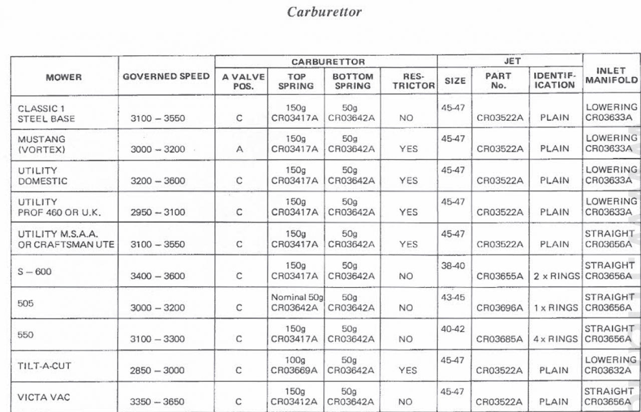

This might help

Posts: 193
To refer to the above chart re. Jet sizes....what are the sizes referring to in regards to size? mm or fractional inch. Had a go at measuring my collection of 18 assorted and couldn't determine the size definitely....
Joined: Feb 2015
Posts: 67
Jet sizes are in ml/hour
Joined: Mar 2013
Posts: 193
Thanks Dan265! Makes sense...but hard to measure at home!
