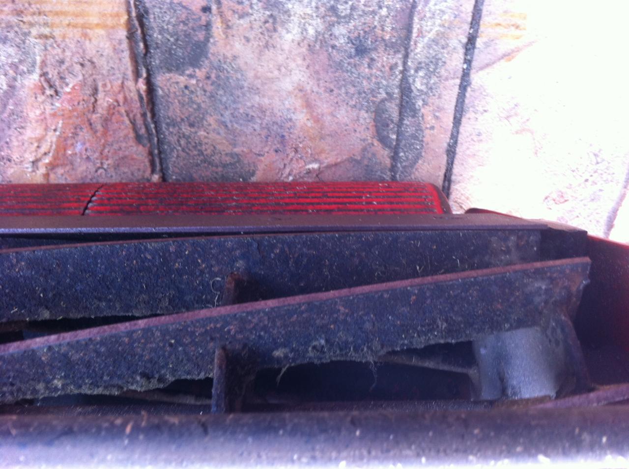

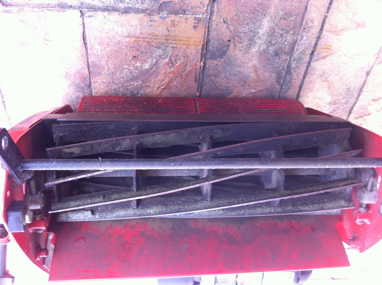

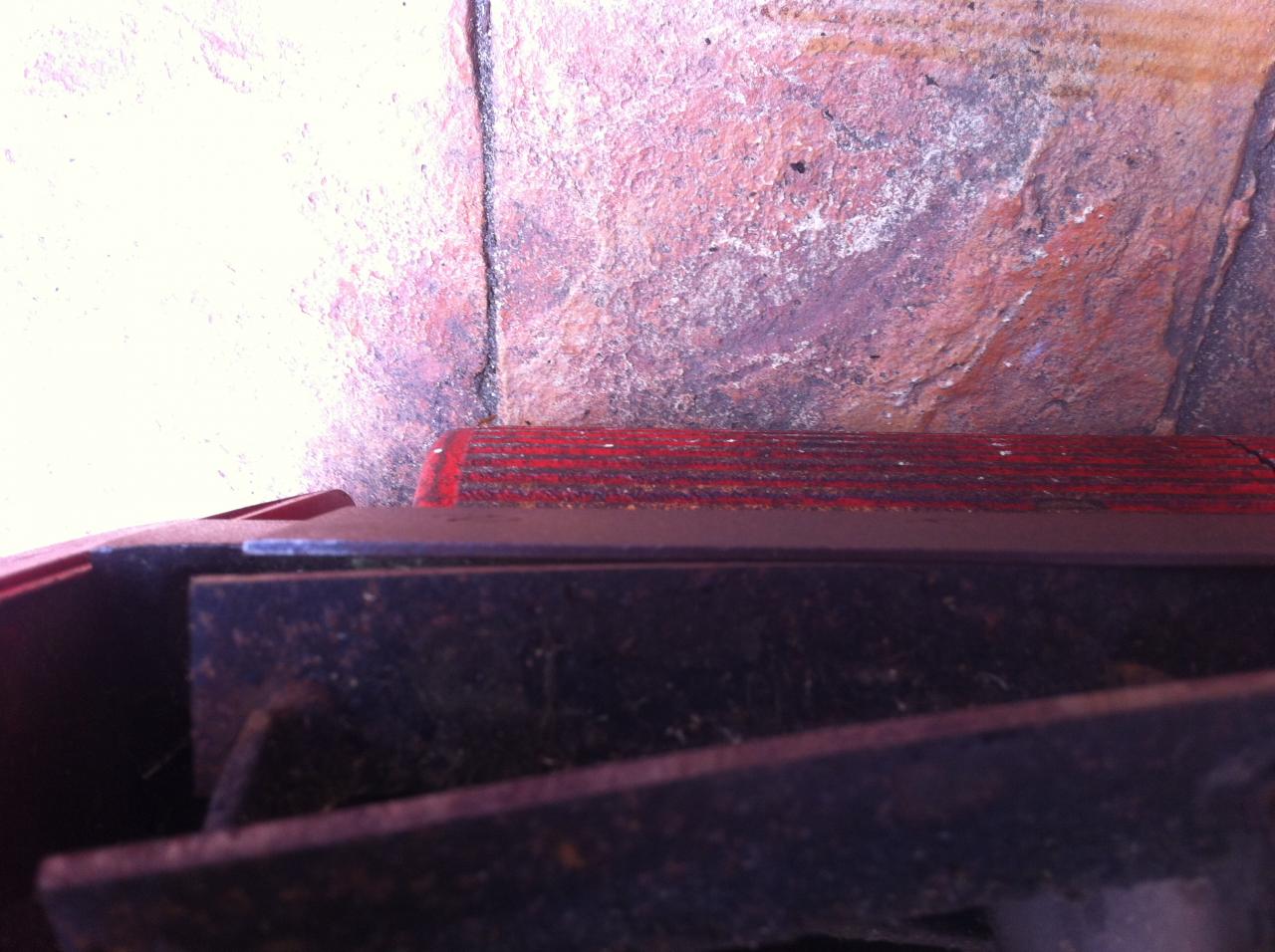

My mower does not appear to be cutting the grass properly as it is leaving some strain of grass and have to run it a few times to cut the left over. I'm in the process of checking the cutter to see if it just needs adjustment before attempting to get it sharpened.
Attached are some photos if this would help.

This is a very common issue, and it requires a procedure to be done to
determine the condition of the bottom blade. The reel itself looks to be
recoverable by back-lapping, rather than grinding. The bottom blade presents
as being of servicable thickness.
But ... if the bottom blade is not recoverable, both reel sharpening and a new
bottom blade (also sharpened)will be necessary.

Just looking at your photos of your reel and bed knife they look to be rather good and probably just require very fine adjustment.
DeeJay has a very good video on adjusting the reel to the bed knife and if you follow that you can't go wrong. If you want to go into back lapping then that would be an added advantage giving you an even better end result.
