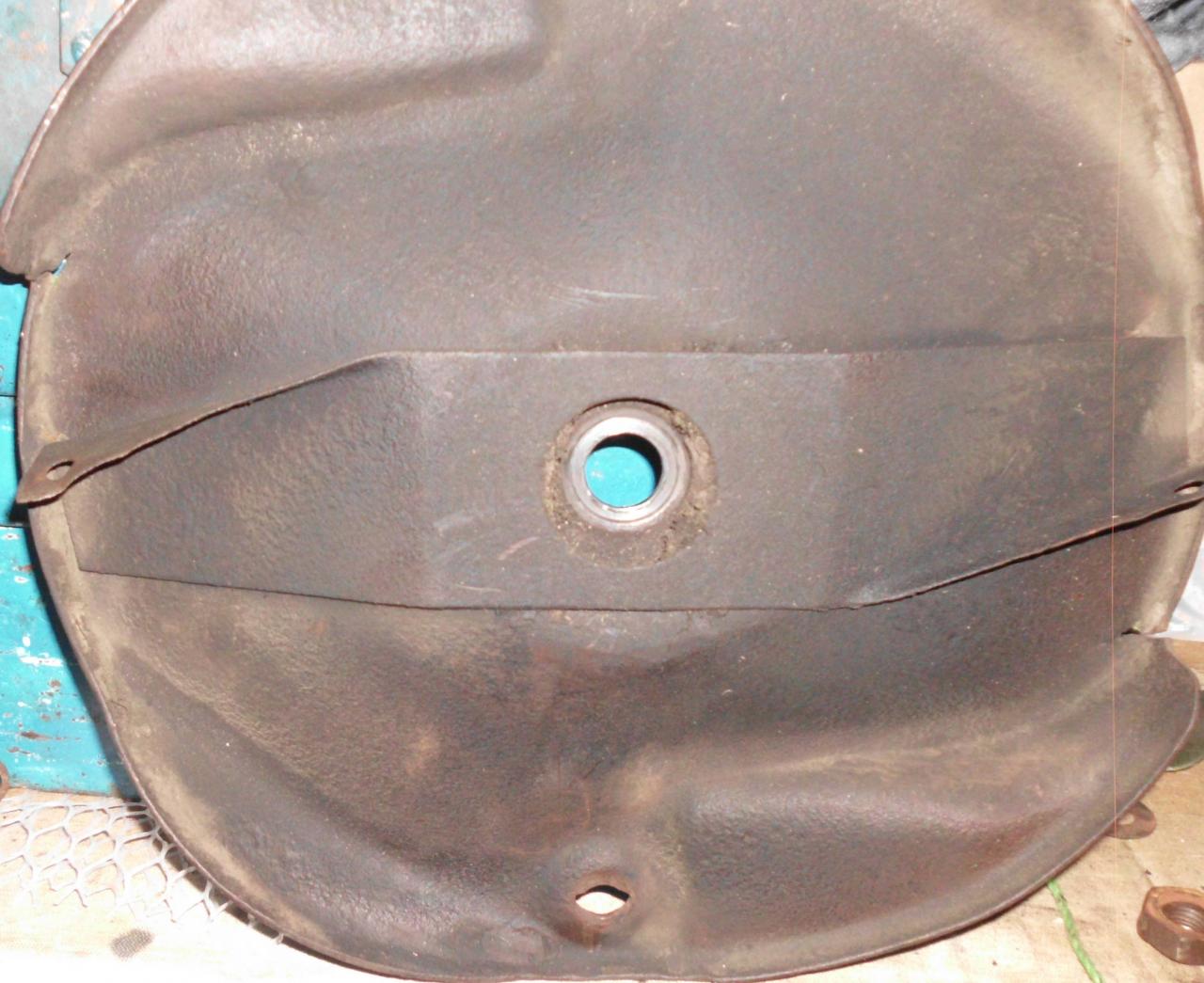

Hi guys ,I have a old victa mower used for years but know what the the flywheel under wont get tight enough to stop it breaking loose.
it is letting go on stopping the mower ,how do I stop this is there a easy way.
Cheers graham I have photos if needed

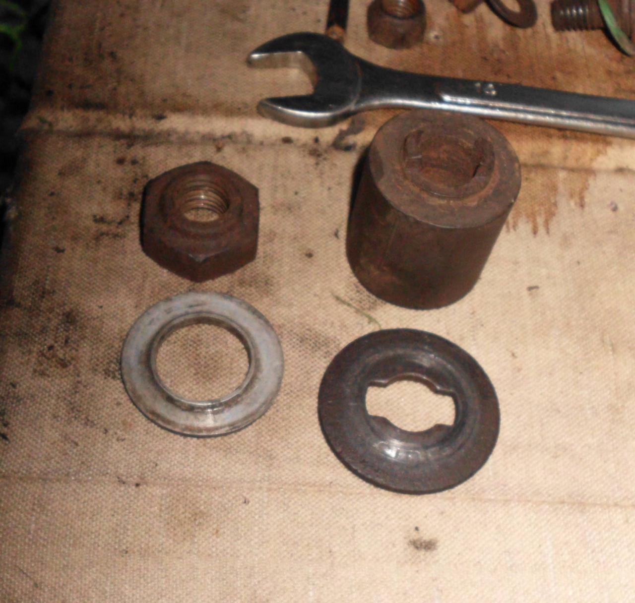

Lose the flat round washer, the one with the round inner NOT the one with cut outs on the right. I suspect the washer is preventing the blade boss being clamped tightly enough....
graham22 #62262 27/02/15 06:29 AM
Clean up the mating surfaces of the boss, plate and lock washer. Sit it on the bench, place the blade plate on the boss. Put the lock washer on and see if the tangs of the boss protrude past the lock washer. If so, the nut will tighten on the boss before it locks in , and make the plate spin. You can lightly linish the tangs down until they are just under the washer.
But Don't take too much off. If it necessary to do so then the plate will be too worn/ thin and be dangerous to fit, as I suspect it is and should really be replaced
The other washer should not need to be used as stated previously.
Fit a new lock nut and tension it up.

Hello Graham22, Dieselboy, Blue and members,
I think Blue has, as always, given good advice here.
I just want to clarify the purpose of the L.H. washer in the photo.
It's not a washer! It's a seal protector that goes above the boss.
If it is loose on the crankshaft, throw it away.
These alloy protectors were introduced to prevent grass wrapping around the
crankshaft and destroying the seal, thus preventing the scavenging of the fuel mix.
From a service point of view, the Belleville lock washer appears to be un-servicable,
in that it has lost its coned-disc springing properties, and should be replaced.
There also appears to be some damage to the blade holder centre.
JACK.

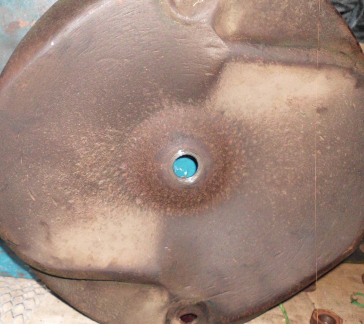

But The thing that I found strange was the blade plate is clearly worn on both mating surfaces, but the mating surface of the boss remains rusty. I would have expected both surfaces to show signs of friction wear. It would have to be so loose that the weight of the plate kept it off the boss surface. But if this was the case, then he would have noticed his arm being ripped off when he tried to start it....hmmm.
The only situation I can think of that would give rise to this wear pattern, is if the assembly order had been got completely wrong. With the lock washer installed against the boss, above the blade disc...

In the meantime here is the sequence:
- 83 - alloy grass and hay band protector (flush against oil seal with lip downwards).
- 84 - solid taper boss
- blade holder with blade flutes facing upwards
- 85 new Belleville washer
- 86 locknut
All very interesting.
JACK.

Yes, that is the correct assembly sequence. But we think that your machine may have been formerly assembled incorrectly here. Note also, that the lock washer has to be fitted the right way up - it is so marked.
