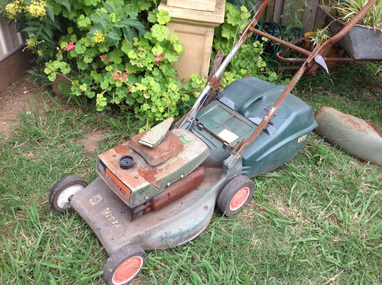

Just cleaning up a Victor Cortina mark 1 for my daughter to use, cannot seem to find any pics
Of one on here, (prob don't know how to use the search function yet), I am looking for shots of the back of the mower where the catcher attaches, I don't have one and need to mod one to fit, any info would be great. Would like to add some pics of mine, just don't know how yet.

Giddy all, still can't find photos to post pics, the engine number of the block in front of carbs is 1 70 1 1384 1 I hope this means something, it's a mark 1, 70 series, cortina wind up start.
Kirky2 [Linked Image]

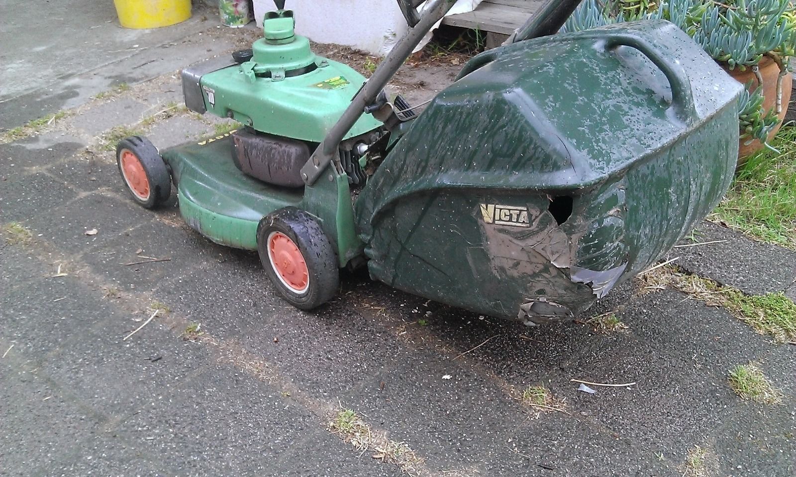

that model has 2 metal hooks on the handlebars and the catcher hangs from them. like this corvette on ebay.

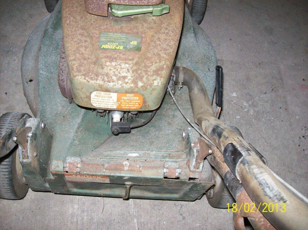

As Gizmo said there should be brackets on the bottom part of the handles for the catcher to hang off.Here is a pictures of the back of one of my Corvette's.Same mower just a different Cowl and a different name.
The second picture isn't my mower it was on eBay late last year,but you can see how the catcher fits.Need anymore pictures let me know and I'll pull my mower out and take some pictures.

From the above photos, can we tell what year this one is, and is it around the right age for the body?. The 1's at either end and centre seem to be part of the moulding, but the no's are stamped in.
Kirky2
