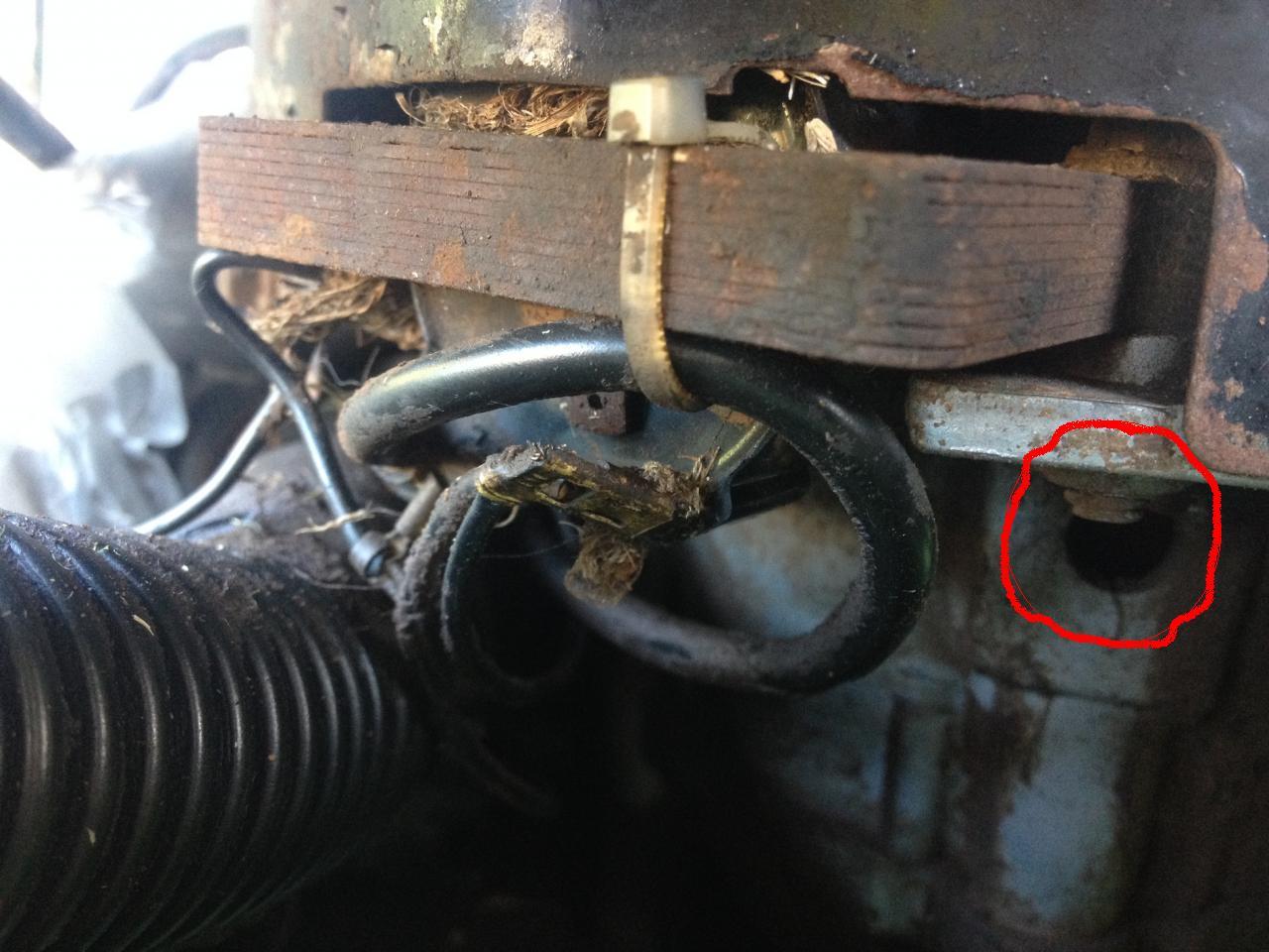

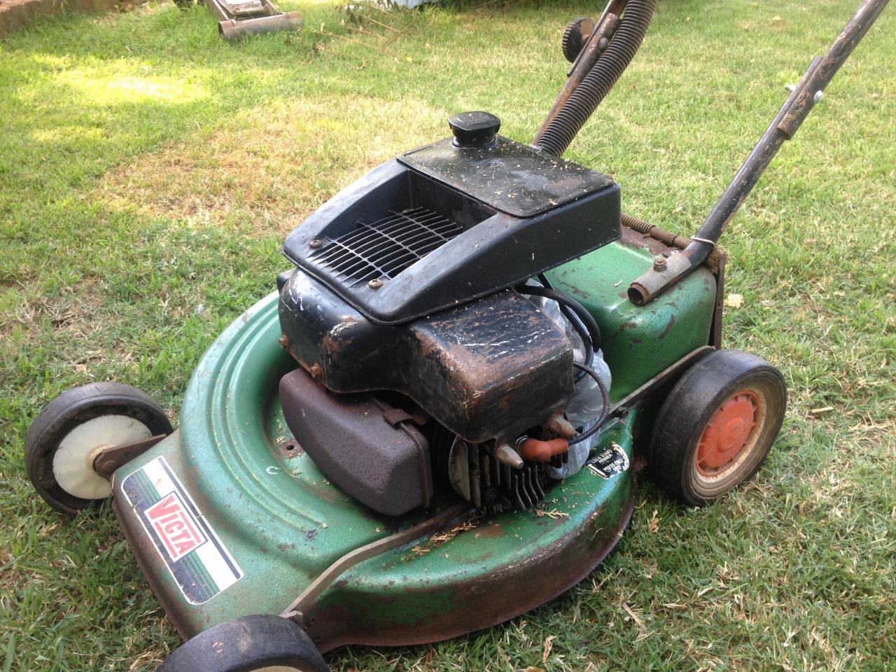

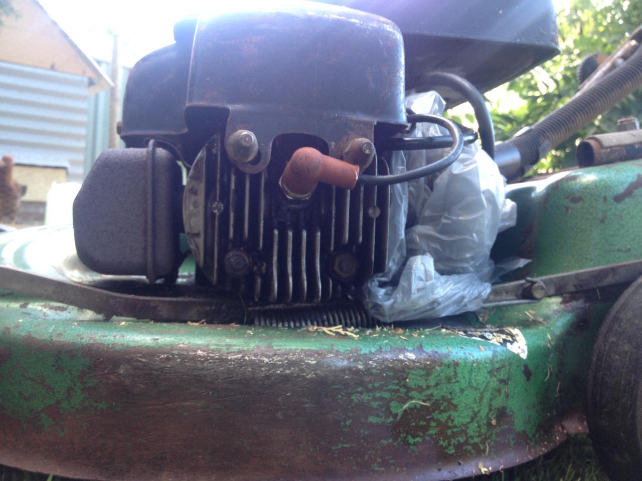

Here are some pictures.
Consensus on the ignition?
Posts: 961
Yep, its got electronic ignition, The hole i've circled in red has no wires coming out of it to indicate it has points. If you look on the underside at the back end of the carby you'll find the module sitting there.
