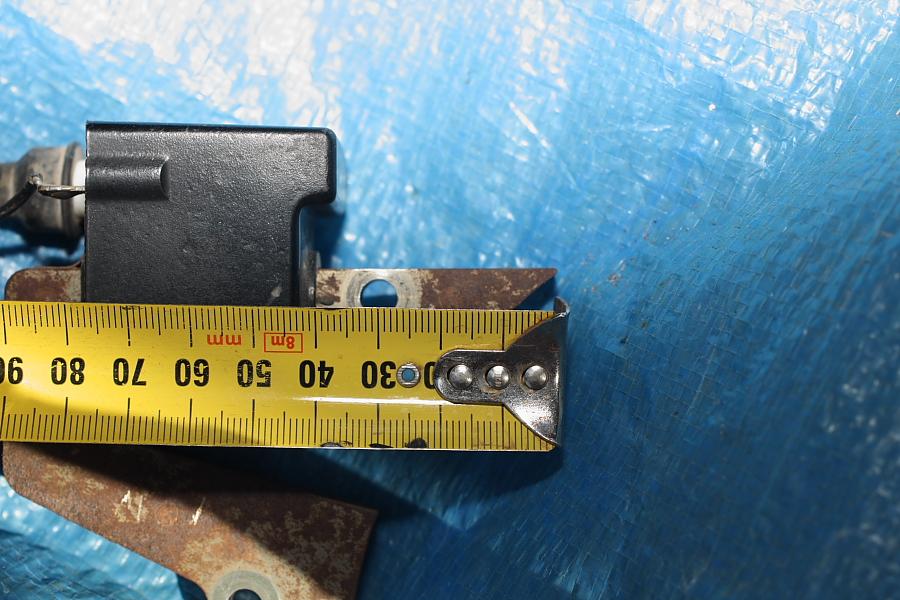

Does anyone know if the 5HP Kubota 4 stroke on their self propelled mower is unique to them or is it a rebranded motor from another manufacturer, and where could I get an ignition coil for it?
Posts: 693
So, I tracked down a new coil from Kubota. $180 plus postage up from Melbourne. Yikes! Here are photos of the coil mounting. Anyone know of a generic or other brand coil that might fit this engine? Or has anyone got a good coil laying around they want to sell by any chance? [Linked Image]

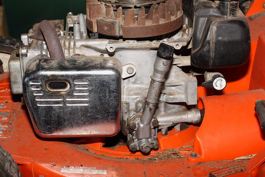

Posts: 693
Okay, the part number on the coil is BM35 769L
Photos of engine from three views. Note the PTO drive on the exhaust side for the self propelled gearbox. Really hope to get this one going again as it is a great mower.

Joined: May 2014
Posts: 133
I have a sneaking suspicion that is a Suzuki engine as I had one very similar that I turfed due to a dead coil....
Posts: 693
I just noticed in the photo there is a number cast in just below the governor arm which say GH150V and 0.145L. Does that ring a bell with anyone?
Posts: 693
Just did a google on GH150V and it comes up with the Kholer and Kubota. ANyone familiar with Kohler's that can tell me if it is one of theirs?
Posts: 693
Found some other numbers, I'm assuming serial number, 150VLT-565504 if that helps.

Posts: 693
Thanks AVB. Yes, from what I found Seers marketed this mower under their own label for a few years.
And Grumpy, thanks for the link. I am a member at MTF and know the mowers are well regarded, with many people preferring them to the Honda self propelled for commercial work. It's just a shame Kubota have such a poor reputation for after sales service and spares. They have had three different agents in my area in three years and none of them have ever actually carried parts themselves. The problem with buying a secondhand one from ebay is no warranty and no idea if it is actually a good engine or on its last legs. This one I have has done very little hours, I bought it secondhand from an old couple that had a lawn the size of a postage stamp, just unfortunate the coil went as it always started first pull and ran like a dream before that.
Posts: 693
After discovering a new coil pack was going to be $180, it came to me to take the HT lead out and recheck the resistances at the terminal rather than at the lead end as per the work shop manual. A real doh, why didn't I think of that before moment. Anyway, a new bit of HT lead and it nearly sat me on my bum. So while it was up on the stand, did the valve clearances, they were way off, checked and reset all the linkages to factory specs, put her all back together and first pull away she went.
