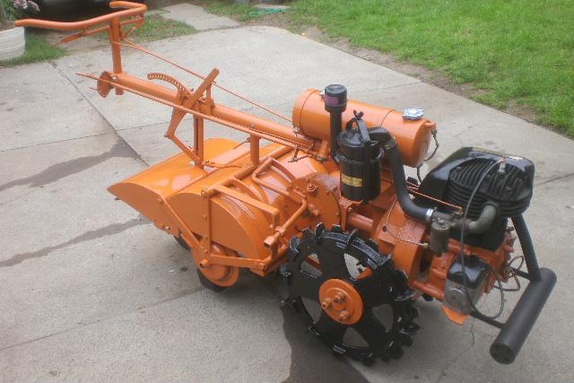

hi all posted some pics of a old howard junior rotary hoe I am doing up, I have two juniors both are incomplete so I am trying to build one good one out of the two,
i cleaned out the fuel and oil tank, oil lines, engine sump, cleaned the points and re gaped , carby butterfly shaft had rusted away, made a new shaft from brass, main jet needle rusted away so i made a new one form some piano wire ,made new exhaust, most of the bolts on the frame are that rusted they have to be cut off, the height adjustment shaft was rusted solid .
its now running very well, blowing no smoke and pumping oil back up to the oil tank, took it for a drive around the back yard and all gears are working, it has 1 ,2 ,3 ,forward no reverse ,
i still have a lot of assembly work to do , after its all together and working then i will strip it , new paint , oil lines fuel lines ect
i also have a howard terrier, these are great old aussie made machines built to last , even if left under a tree for 20 plus years
will post some more pics when finished
cheers damo

Joined: Jan 2014
Posts: 86
hi everyone, have finished restoring my howard junior so have posted some pics , changed the magneto over to a later lucas as you can still buy parts points condenser's ect, machine is very easy to start , crank the handel and release the decomp leaver and away she goes , now I cant wait to dig over my vegi patch after summer.
cheers damo wink
may need some help with pics as html box still wont drop down thanks
Hi Damo, and my congrats on a brilliant restoration. That is a delight to my eyes...your attention to detail is to be admired... good1
PS.....I bet you will be reluctant to get it dirty! lol
