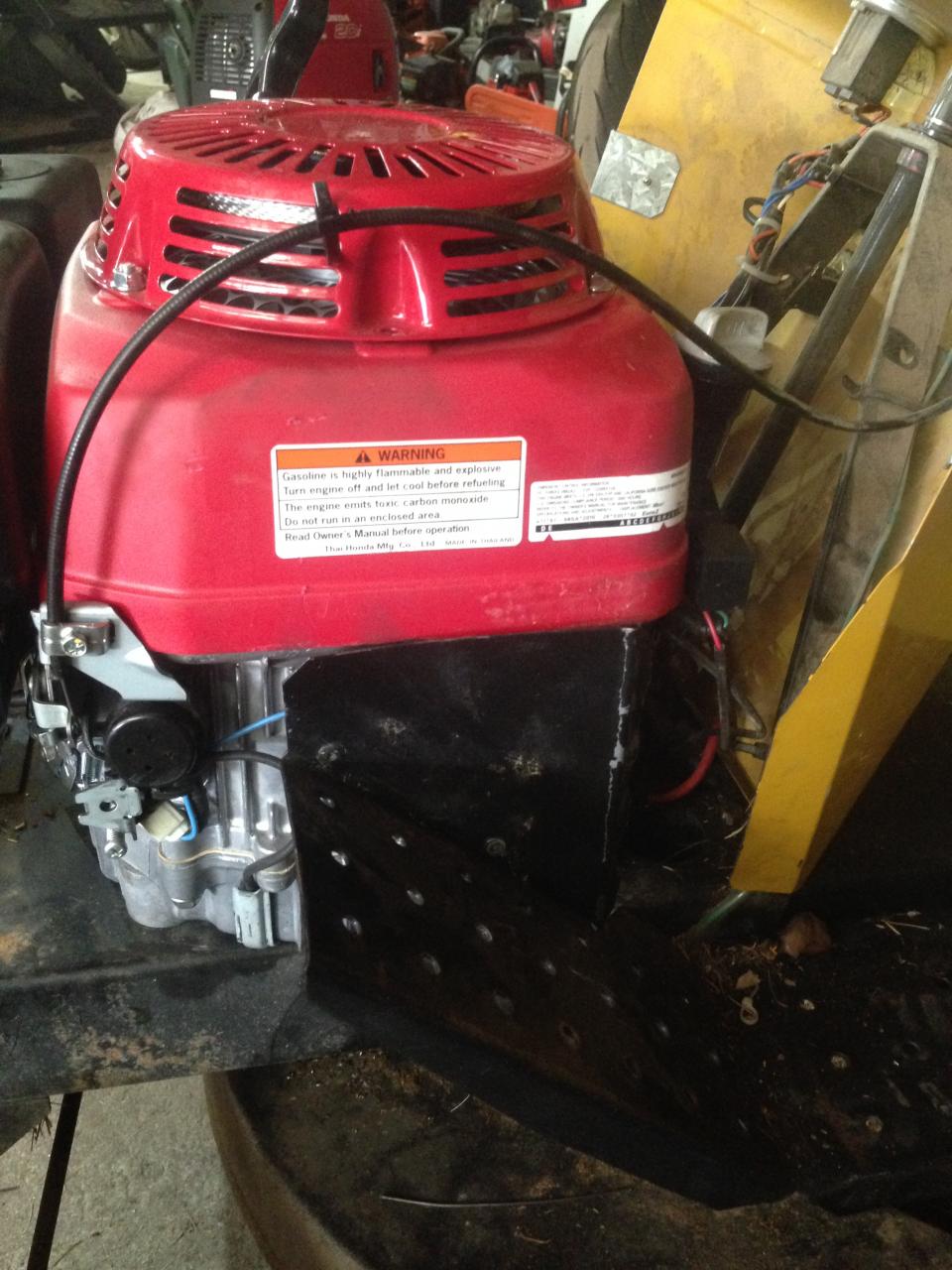

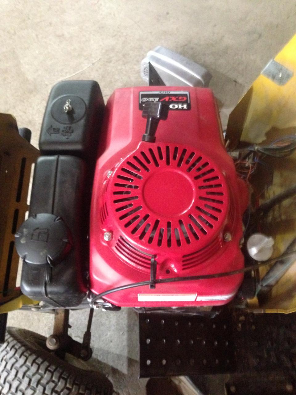

Here are some pics of the conversion, just finishing the muffler fit which will be at the front.

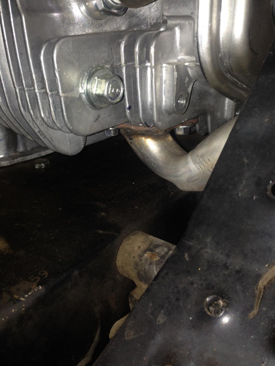

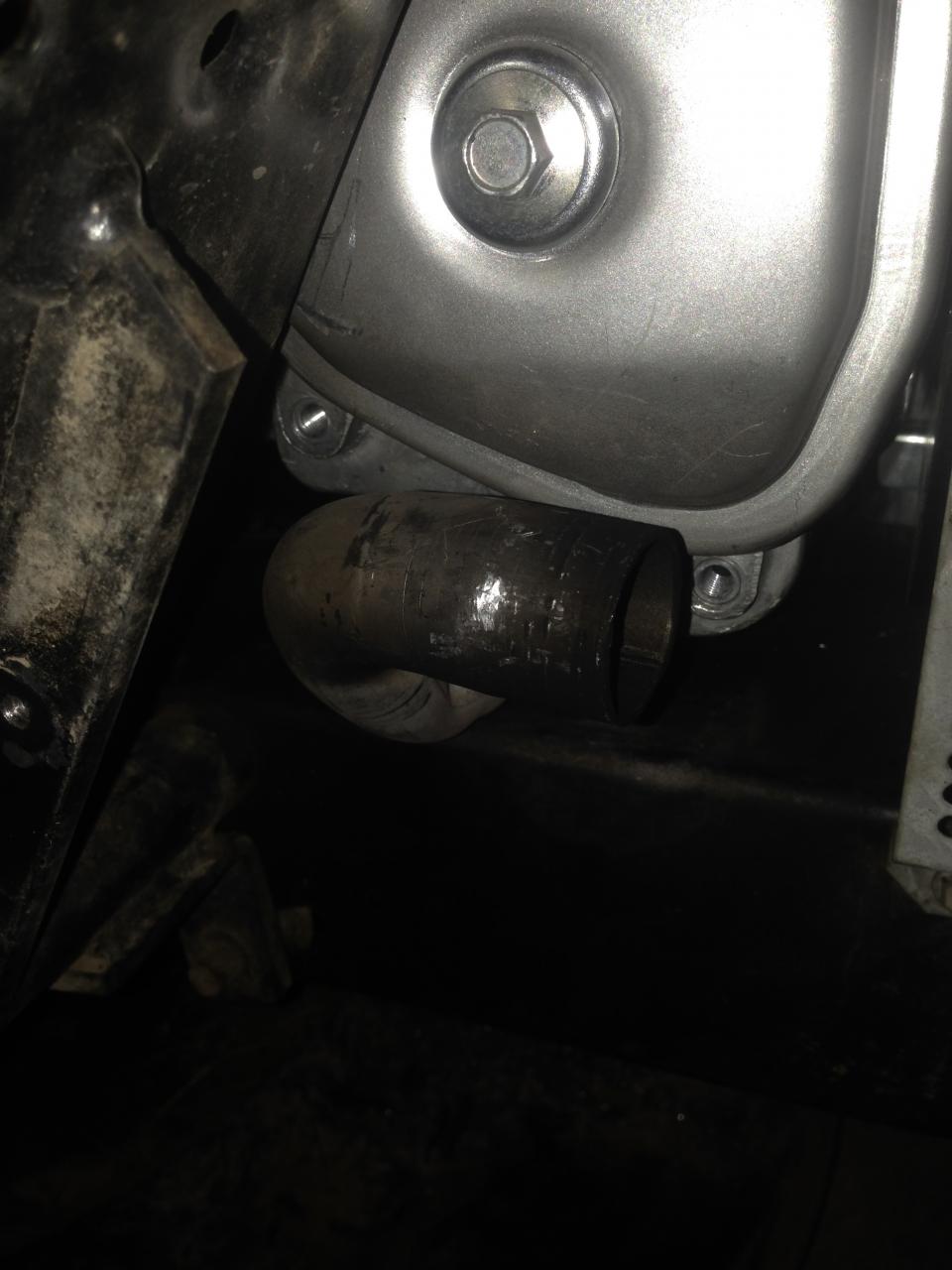

This was the main problem, the header pipe, a new one had to be made to clear the chassis and the drive pedal, next time maybe straight through the chassis. (never!)

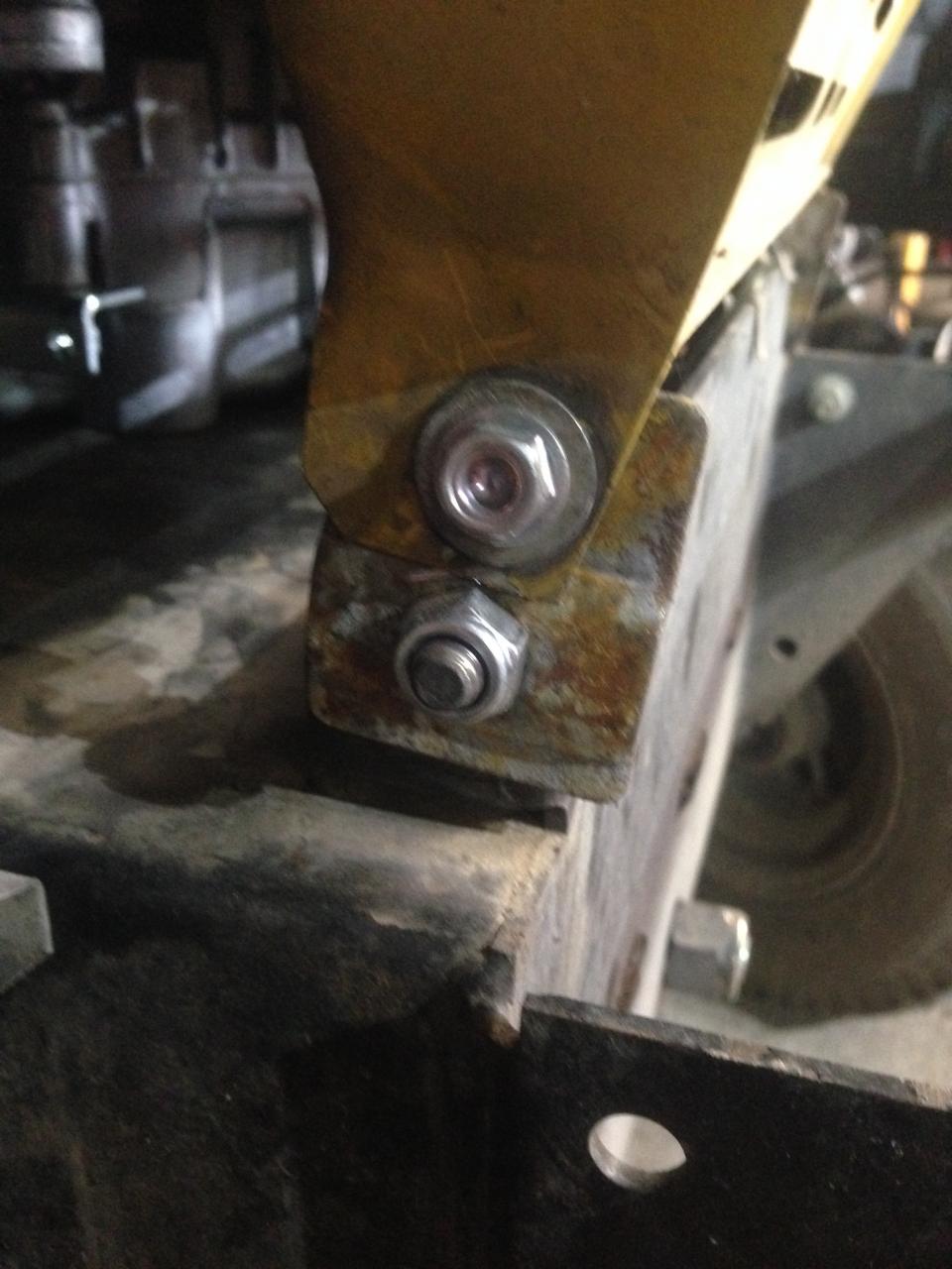

Had to raise the bonnet at the front to clear the fuel tank, a couple of victa engine mount plates are perfect!

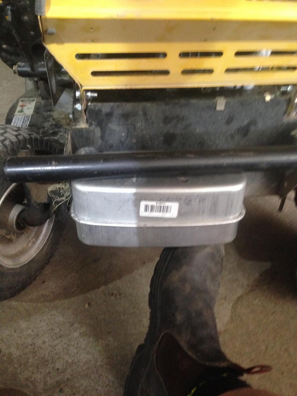

Muffler will be at the front after some more modds.
Well it's a much nicer engine than a Tecumseh Red, it's just a matter of getting the installation right. Is one of your bonnet mounting screws too short? Looks like the bracket it's holding needs its corner filed, too.
The main issues I'd be concerned about are making things clear each other rather than rattle against each other, and supporting the muffler where its weight is, rather than having it overhang a long way from the flange mount at the exhaust port.
That's a good mower and an excellent engine. It's up to you to make it a good installation, so you get full benefits from the change.
